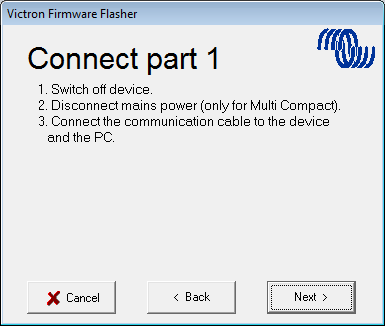

Follow the on screen steps.
Save the Firmware file in an easy to find folder.
Follow these steps carefully.
Once finished and OK is selected the Inverter/Charger will reset itself.
Note that all settings will be reset to defaults. Also that the unit will be reset to stand alone mode and any Assistant settings will be removed.
