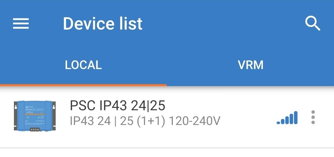

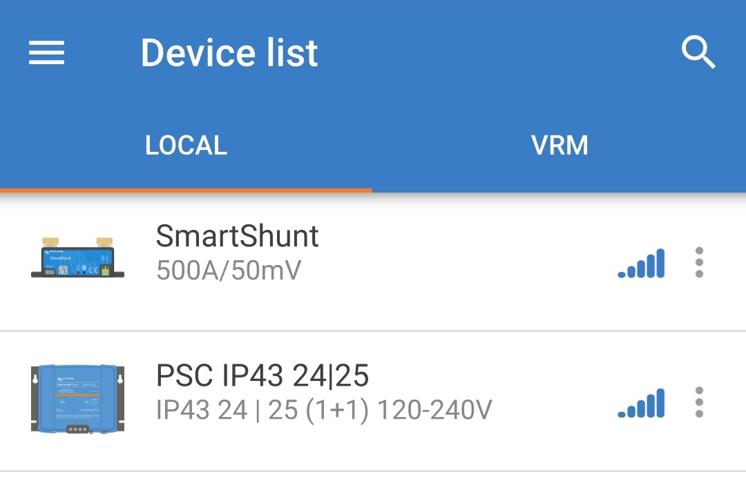

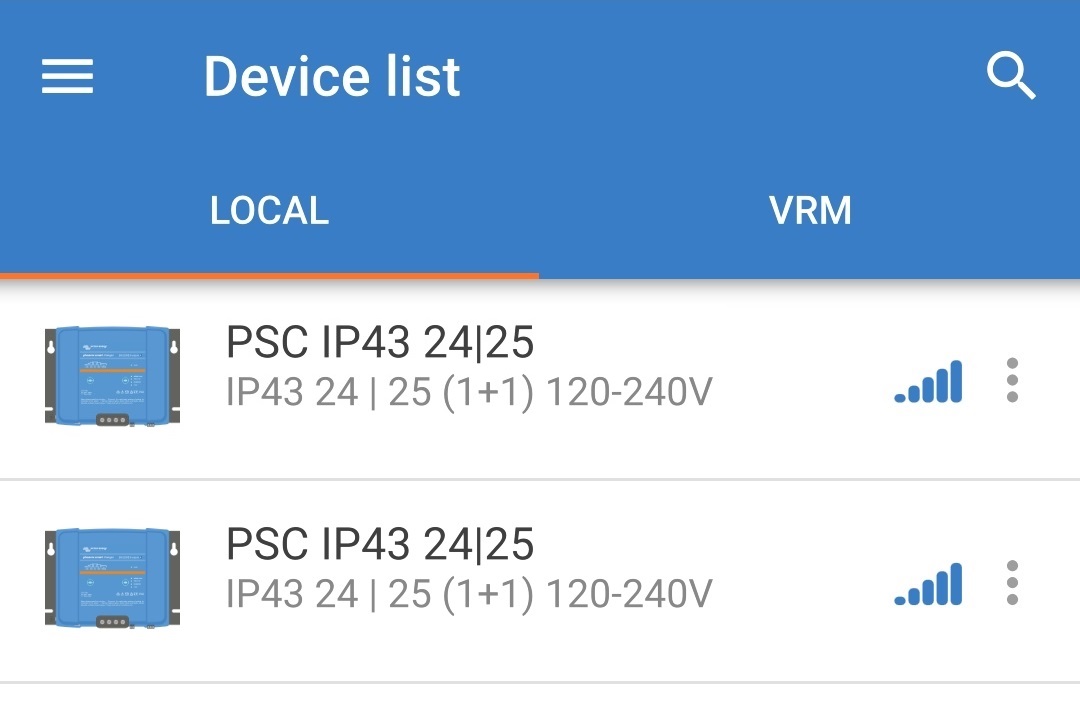

Open the VictronConnect app and locate the Smart IP43 Charger in the Device list Local page, under Other devices.
In case the Smart IP43 Charger does not automatically appear, ensure that the mobile phone or tablet has Bluetooth enabled and is within close range, then perform a manual scan for devices by selecting the Scan button (round orange button with circular arrow) in the bottom right corner.
Select the Smart IP43 Charger from the Device list Local page, under Other devices.

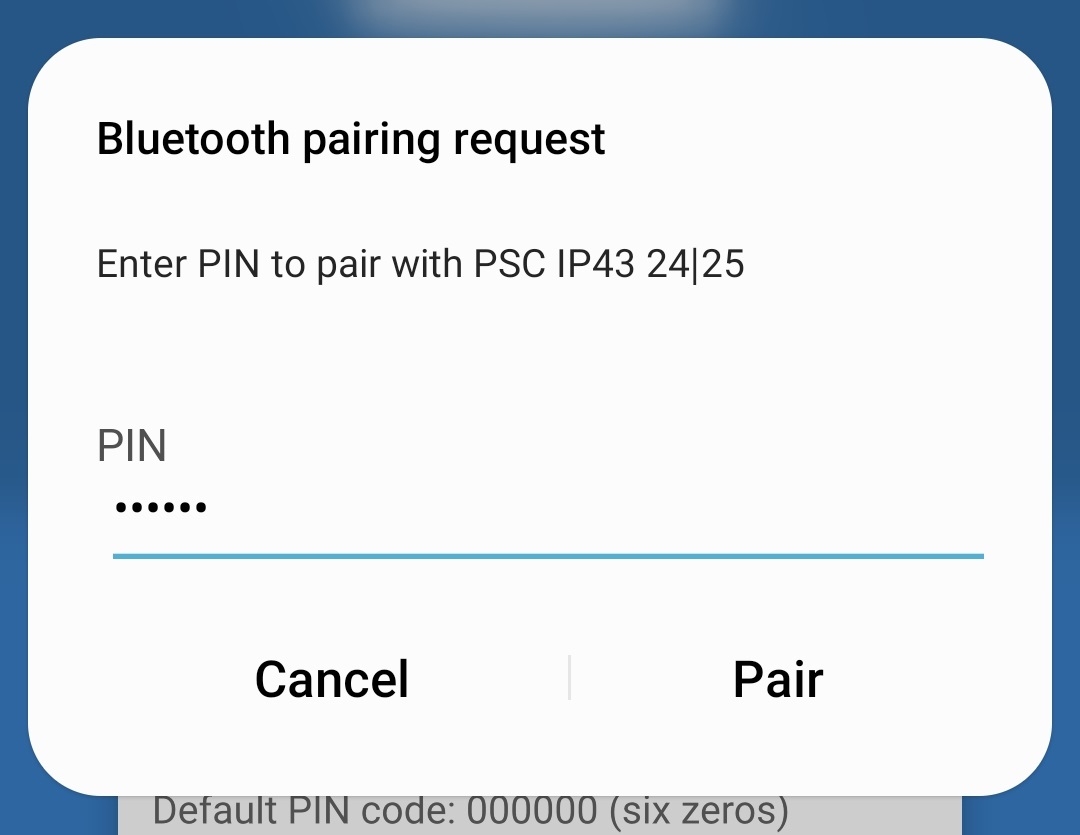

VictronConnect will attempt to establish a Bluetooth connection with the Smart IP43 Charger and display the connection progress in the Connecting pop-up dialog box.
When attempting to establish a Bluetooth connection with a new/unpaired device, the Bluetooth pairing request pop-up dialog box will appear after a short delay; enter the default PIN code stated on a label located on the side of the charger (or try 000000 if there is no default PIN code label), then select Pair.

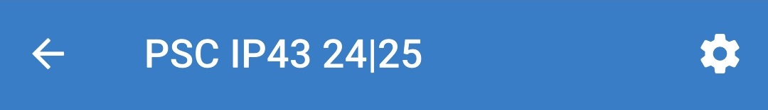

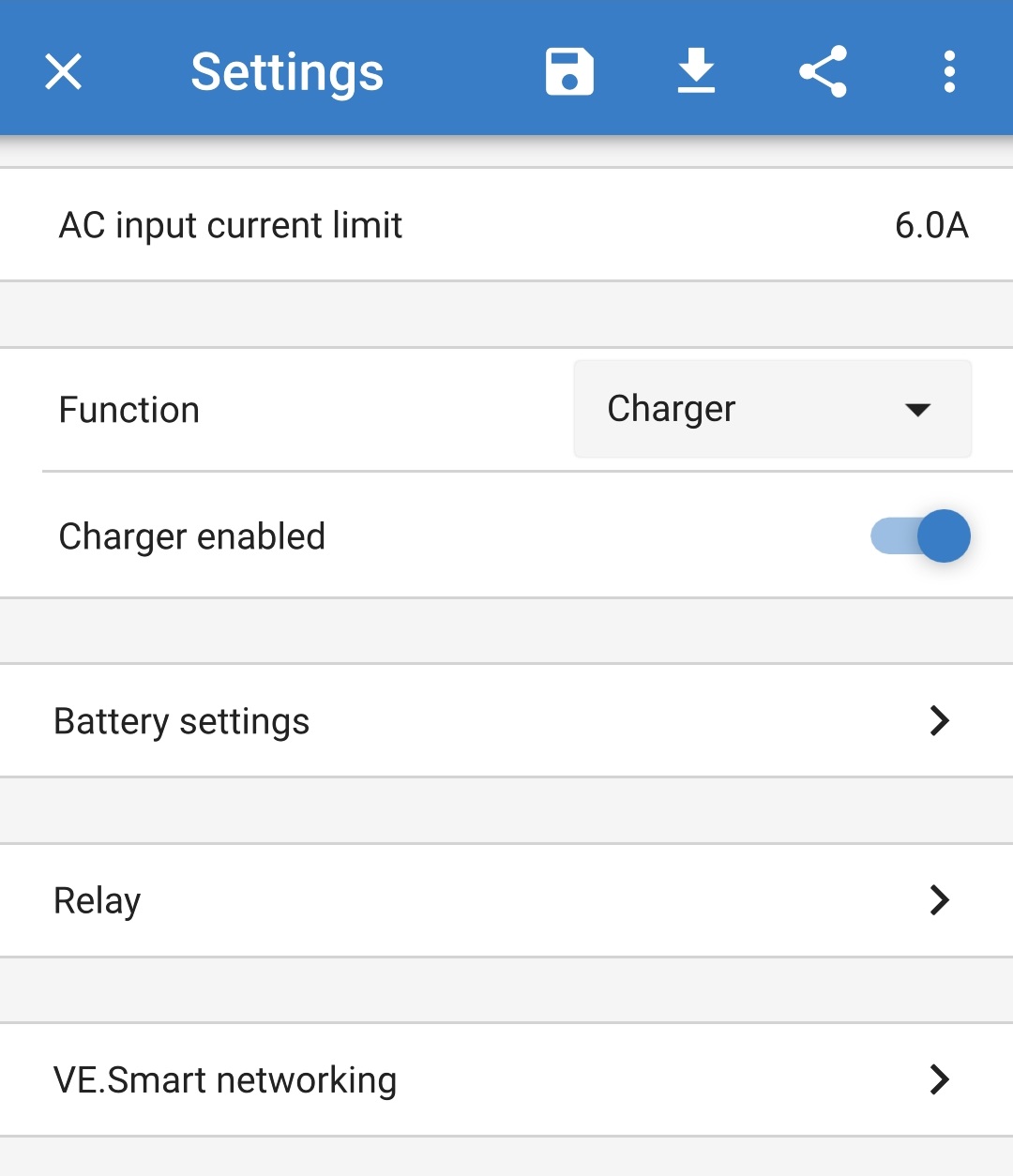

Select the Settings icon (gear in the top right corner) to access the Settings page.
Select Battery settings to access the Battery settings menu.

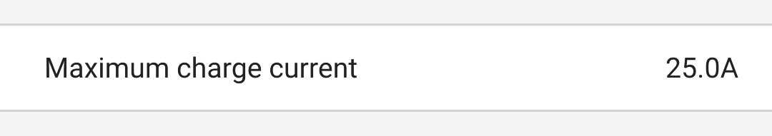

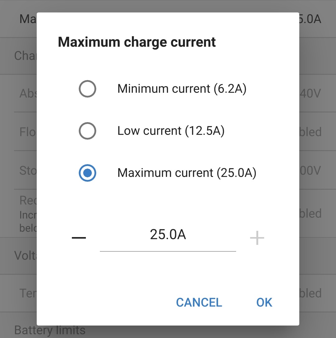

If the maximum rated charge current is excessive, enable low current mode (charge current limited to 50% of the maximum rated charge current) or minimum current mode (charge current limited to 25% of the maximum rated charge current). To enable (or disable) low current mode:
Select Maximum charge current to access the Maximum charge current pop-up dialog box.
Select the most appropriate maximum charge current from the preset options (Minimum / Low / Maximum), or specify an alternative current (between the minimum and maximum limits) using the numeric input controls near the bottom.

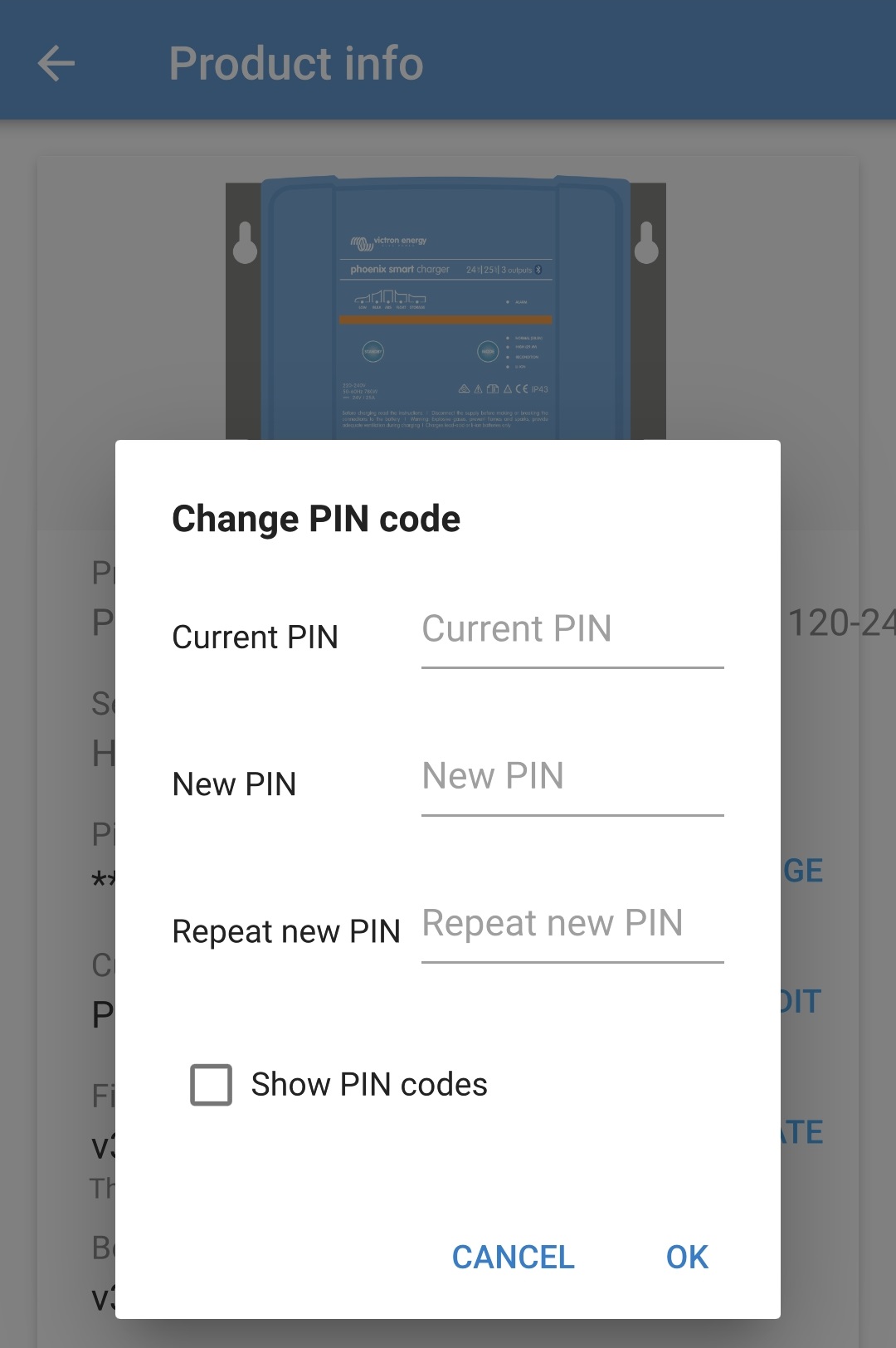

6.3. Bluetooth
6.3.1. Changing the PIN code
To prevent unauthorised Bluetooth connections, it is highly recommended to change the default PIN code to a unique PIN code that that offers a greater level of security.
The Bluetooth PIN code can be changed using a Bluetooth enabled device (mobile phone or tablet) with the VictronConnect app.
To change the Bluetooth PIN code:
Connect the Smart IP43 Charger AC power cable to a mains power outlet; after a short delay all LEDs will illuminate briefly, then the LEDs indicating the current charge mode and charge state will illuminate.
Using a Bluetooth enabled device (mobile phone or tablet), open the VictronConnect app and locate the Smart IP43 Charger in the Device list Local page, then connect to the device (the default PIN code is stated on a label located on the side of the charger, or try 000000 if there is no label).
Select the Device options icon (three vertical dots in the top right corner) to access the Device options dropdown menu.
Select Product info from the dropdown menu to access the Product info page.
Select CHANGE in the Pin code field to open the Change PIN code pop-up dialog box.
Enter the current PIN code and the desired new PIN code (twice), then select OK; avoid using a simple PIN code that is easy for someone else to guess, such as 123456.
After a short delay a pop-up dialog box will appear confirming that the Bluetooth PIN code has been successfully changed.
The Bluetooth PIN code has now been changed to the new PIN code.

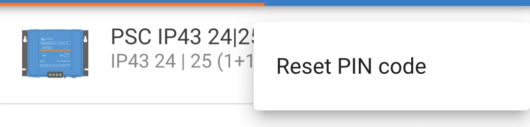

Select the Device options icon (three vertical dots on the right side of the description) to access the dropdown menu.
Select Reset PIN code from the dropdown menu to open the Reset PIN code pop-up dialog box.
Enter the PUK code (recorded earlier) and select OK.
A pop-up dialog box with the text "Busy" will be displayed while the Bluetooth PIN code is being reset.
After a short delay a pop-up dialog box will appear confirming that the Bluetooth PIN code has been successfully reset; select OK to exit into the VictronConnect Device list LOCAL page.
The Bluetooth PIN code has now been reset to 000000.

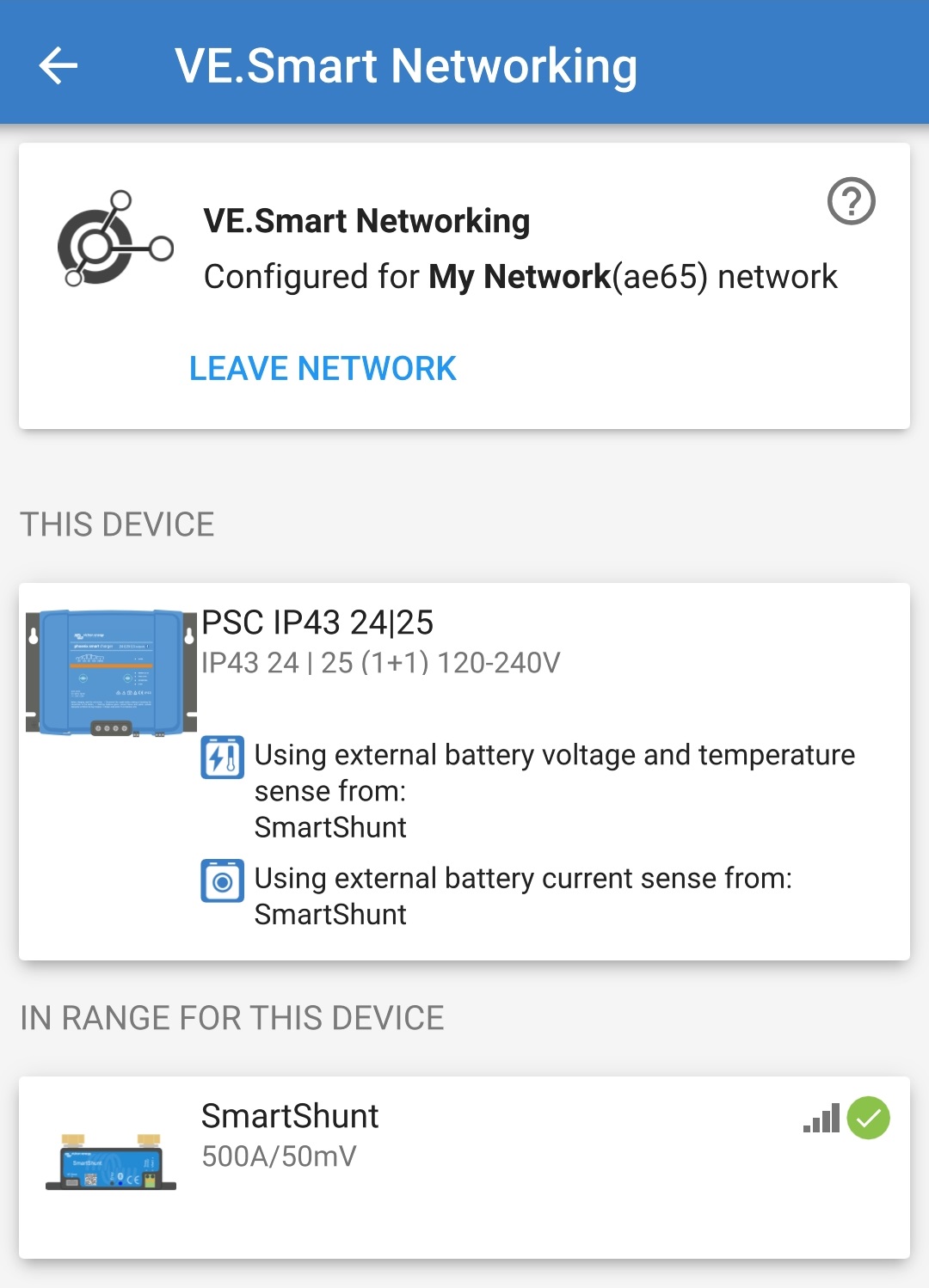

6.4.1. Voltage, temperature and current sense
To setup a VE.Smart Network with Volt-Sense / Temp-Sense / Current-Sense:

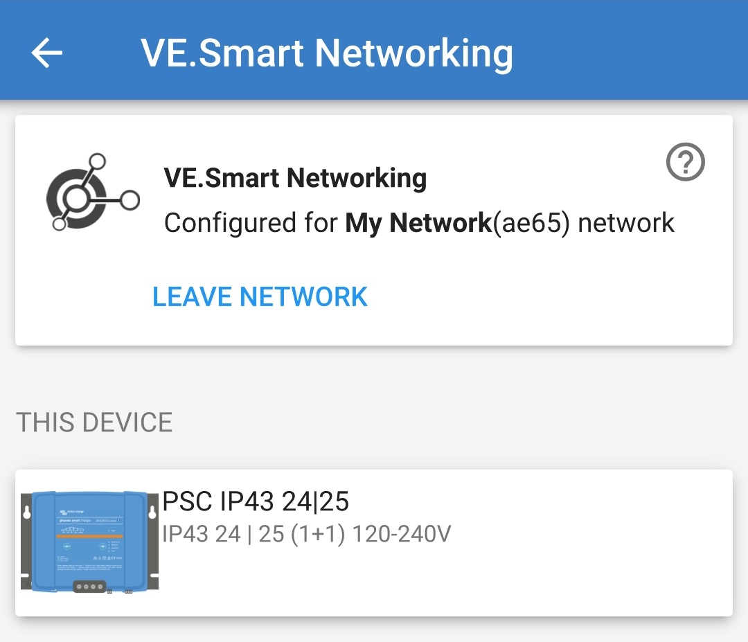

Using a Bluetooth enabled device (mobile phone or tablet), open the VictronConnect app and locate the battery monitor (BMV, SmartShunt, Smart Battery Sense or VE.Bus Smart Dongle) in the Device list Local page, then connect to the device (the default PIN code is stated on a label located on the battery monitor, or try 000000 if there is no label).
Select VE.Smart networking to access the VE.Smart networking page.

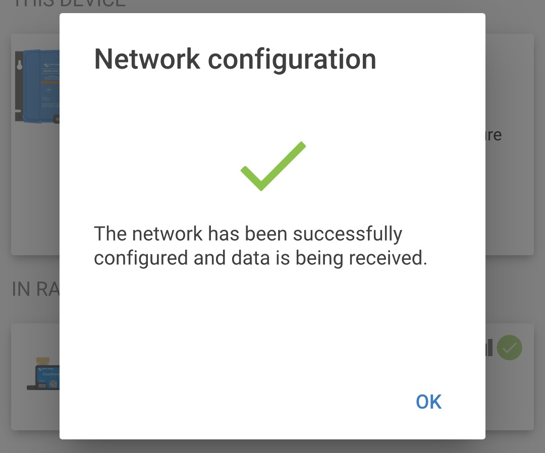

Select CREATE NETWORK (or JOIN NETWORK if a VE.Smart network has already been created).
Enter a name to identify the VE.Smart network and then select OK.

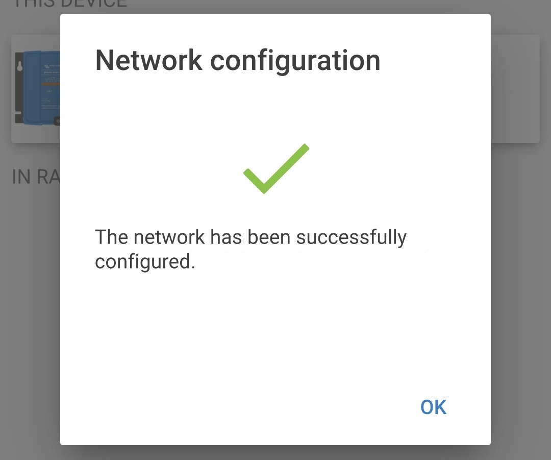

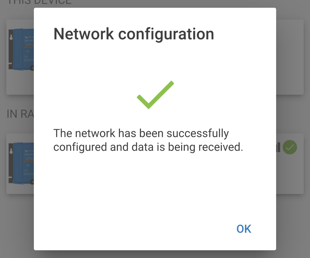

After a short delay a pop-up dialog box will appear confirming that the network has been successfully configured; select OK to close the dialog box.
The VE.Smart network configuration details are displayed within the the VE.Smart networking page.
End the current Bluetooth session by exiting into the VictronConnect Device list Local page.
Using a Bluetooth enabled device (mobile phone or tablet), open the VictronConnect app and locate the Smart IP43 Charger (or other VE.Smart networking compatible charger) in the Device list Local page, then connect to the device (the default PIN code is stated on a label located on the side of the charger, or try 000000 if there is no label).
Select JOIN EXISTING.
Select the existing VE.Smart network you want to join, then select OK.
For systems with additional VE.Smart networking compatible chargers connected to the same battery / battery bank, repeat steps 8 to 16 above to include each remaining charger into the common VE.Smart network.

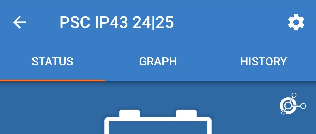

VE.Smart networking has now been configured; when VE.Smart networking is enabled:
The VE.Smart network symbol will appear in the top right corner of the Status screen (of all devices within the VE.Smart network).
The active charge state LED on the charger (BULK, ABS, FLOAT and STORAGE) will blink (turn off) momentarily every 4 seconds.
Notice
Multiple chargers in a common VE.Smart network must all have the same charge settings, since the master can change dynamically.

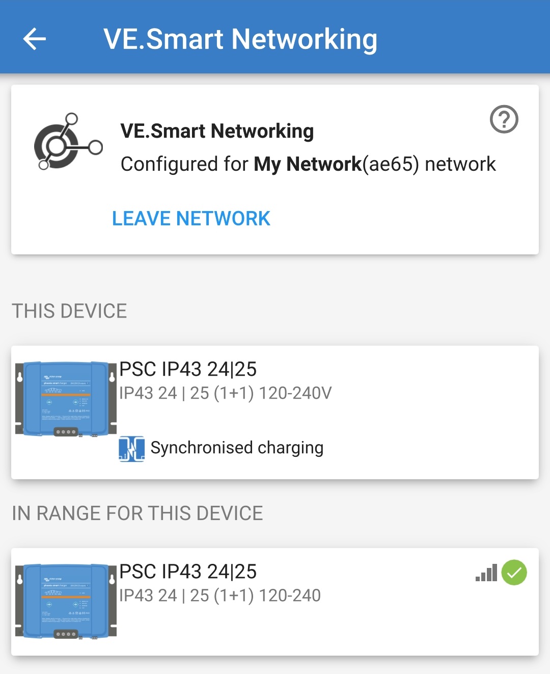

6.4.2. Synchronised charging
To setup a VE.Smart Network with Synchronised charging:
Connect all Smart IP43 Charger AC power cables to a mains power outlet; after a short delay all LEDs will illuminate briefly, then the LEDs indicating the current charge mode and charge state will illuminate.
Using a Bluetooth enabled device (mobile phone or tablet), open the VictronConnect app and locate the first Smart IP43 Charger in the Device list Local page, then connect to the device the default PIN code is stated on a label located on the side of the charger, or try 000000 if there is no label).
Enter a name to identify the VE.Smart network and select OK.
Using a Bluetooth enabled device (mobile phone or tablet), open the VictronConnect app and locate the subsequent Smart IP43 Charger (or other VE.Smart networking compatible charger) in the Device list Local page, then connect to the device (the default PIN code is stated on a label located on the side of the charger, or try 000000 if there is no label).
For systems with additional VE.Smart networking compatible chargers connected to the same battery / battery bank, repeat steps 9 to 17 to include each remaining charger into the common VE.Smart network.
The VE.Smart network symbol will appear in the top right corner of the STATUS screen (of all devices within the VE.Smart network).
Select Reset to defaults from the dropdown menu to open the Restore device pop-up dialog box.
Read the warning message, then select Yes to proceed.
