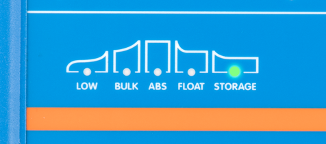

Alternatively, a Bluetooth enabled device (mobile phone or tablet) with the VictronConnect app can be used to view the active charge state; refer to the 'Monitoring > VictronConnect' section for more information.
