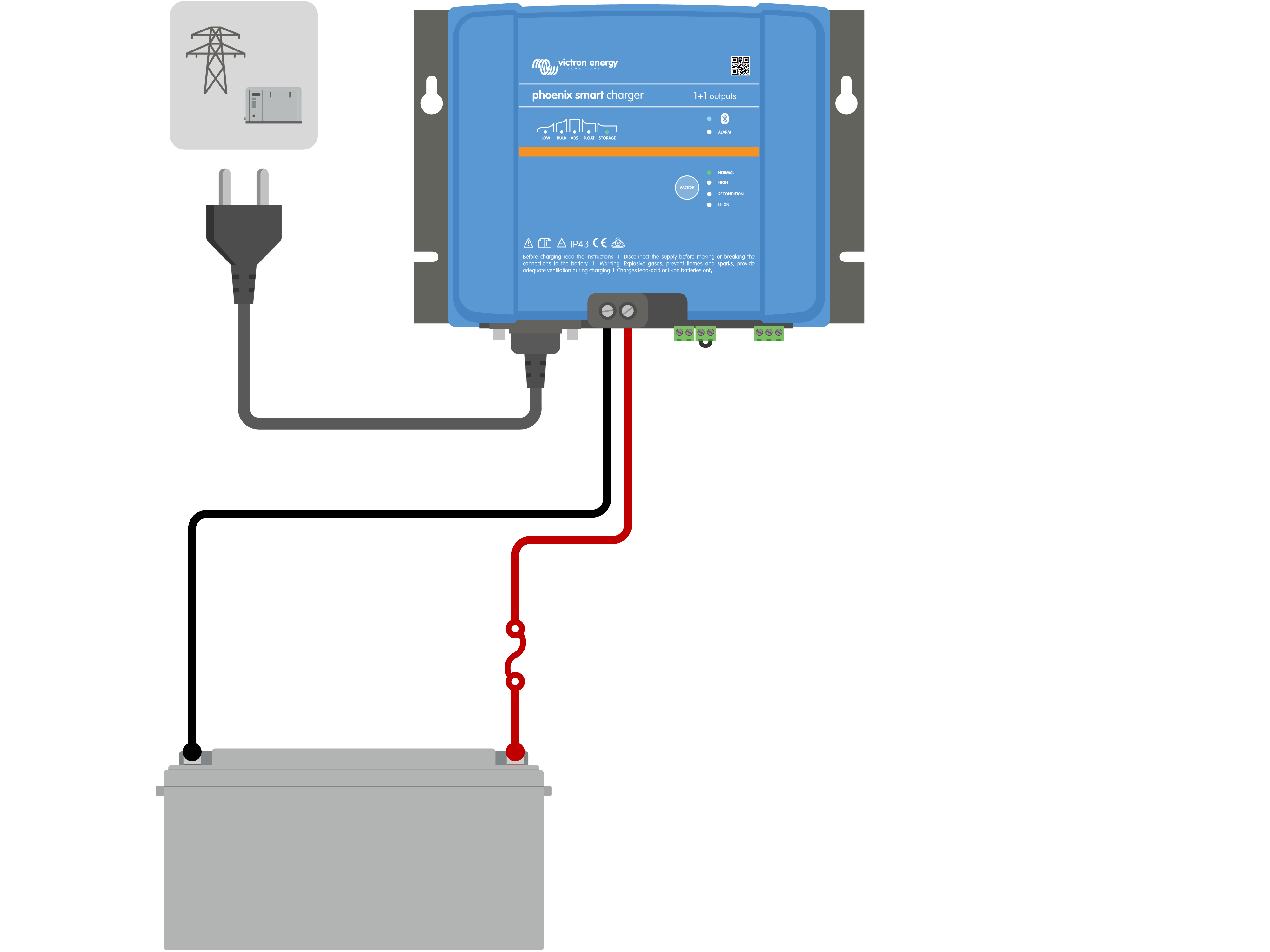

Connect suitable DC power cabling between the Smart IP43 Chargers BATTERY terminals (torque the terminal screws to 2.4Nm) and the battery or DC system distribution bus; all LEDs will illuminate briefly when DC power is connected.
There are specific wiring connection instructions for charging a battery installed within a vehicle; refer to the 'Installation > Wiring' section for more information.
Connect the Smart IP43 Charger AC power cable to a mains power outlet; after a short delay all LEDs will illuminate briefly, then the LEDs indicating the current charge mode and charge state will illuminate.

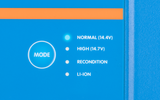

Press (and release) the MODE button on the Smart IP43 Charger to cycle through and select the most appropriate integrated charge mode (Normal, Normal + Recondition, High, High + Recondition or Li-ion).
The LED beside the currently selected charge mode (NORMAL / HIGH / LI-ION) will be illuminated, as well as the RECONDITION LED if enabled.

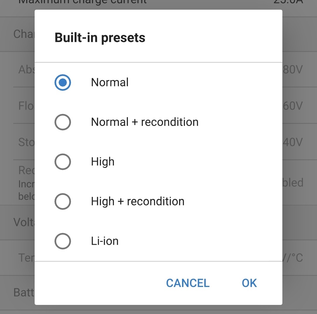

Using a Bluetooth enabled device (mobile phone or tablet), open the VictronConnect app and locate the Smart IP43 Charger in the Device list Local page, then connect to the device (the default PIN code is stated on a label located on the side of the charger, or try 000000 if there is no label).
Select the Settings icon (gear in the top right corner) to access the Settings page.
Select Battery settings to access the Battery settings menu.
Expand the Battery preset drop-down menu, then select Built-in preset or alternatively Select preset for more specialised battery types.
Select the most appropriate integrated charge mode (Normal, Normal + Recondition, High, High + Recondition or Li-ion) from the Built-in presets menu, then select OK.
