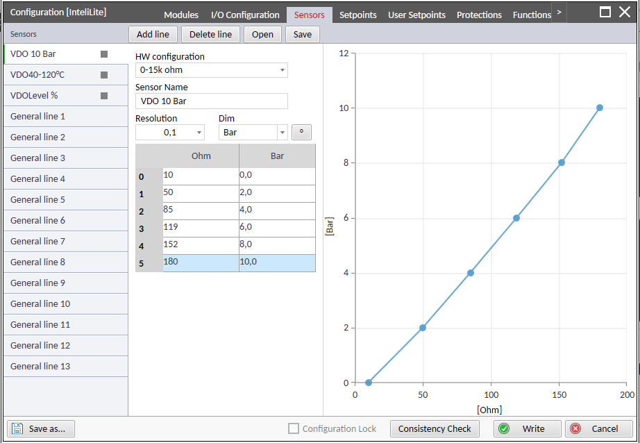

Ensure Correct Units/Power Format:
Select the Controller Configuration tab
Choose Others
Select Units/Power Format
Ensure that Units is set to “Metric - 20°C, 10.0 Bar, 11.4 l/h” and Power Format is set to “Standard 1 kW/kVA/kVAr 1 V
Choose Sensors
Select "VDO 10 Bar" and ensure that the Resolution is set to "0,1" and Dim is set to "Bar"
Now select "VDOLevel %" and ensure that the Resolution is set to "1" and Dim is set to "%"

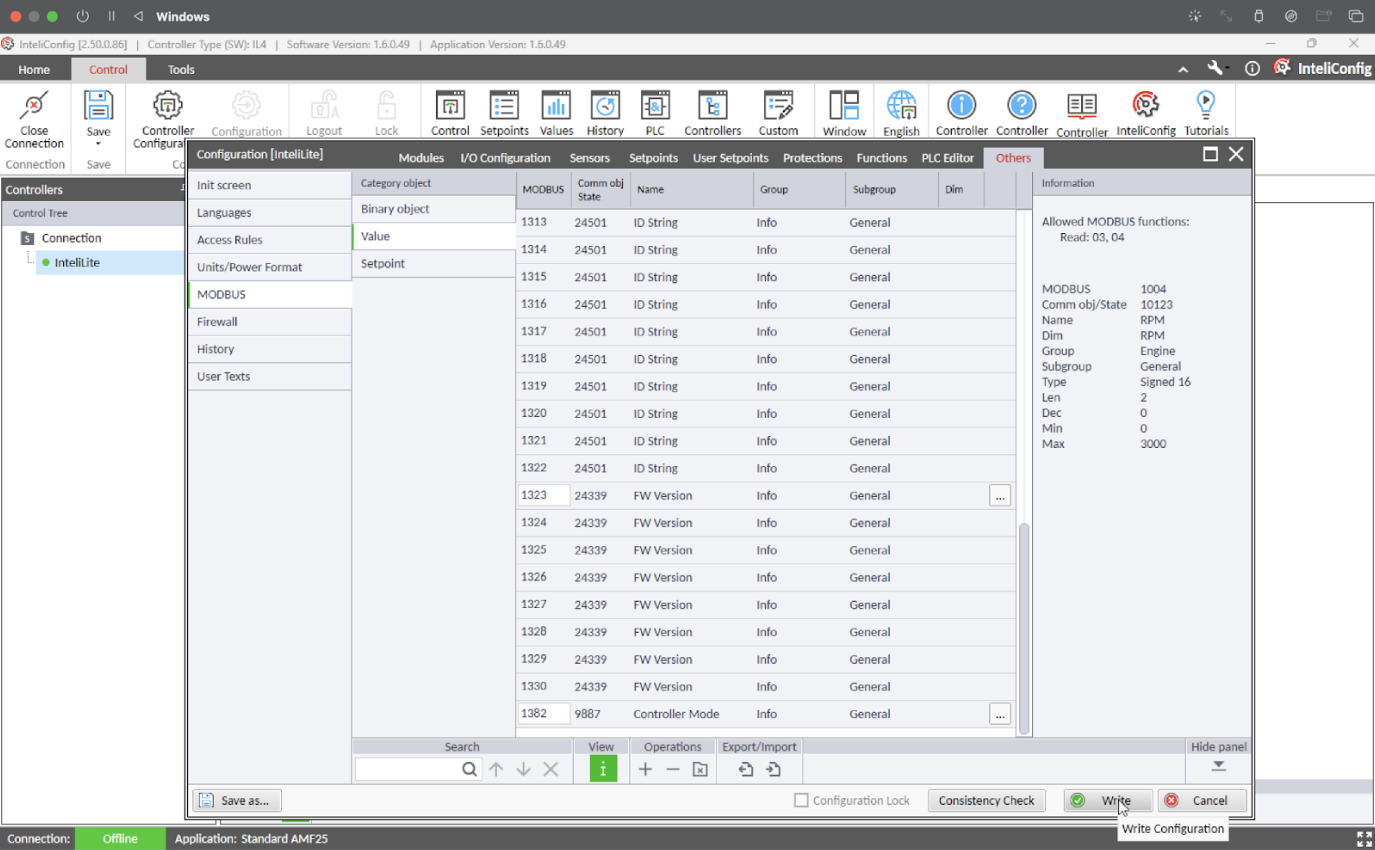

Re-mapping Modbus Registers:
In the same window, select MODBUS
Download the Modbus mapping file for Victron Energy: ComAp InteliLite GX mapping
At the bottom, under Import/Export, click the Import icon on the right
Select the downloaded mapping file and click OK
In the bottom right corner, click the Write button to save the configuration to the controller
The ComAp Modbus mapping UMOD file contains the necessary Modbus register mappings as required by the GX device. A human-readable format of the mapping can also be found in the appendix: Modbus holding registers for the ComAp InteliLite 4 controller.

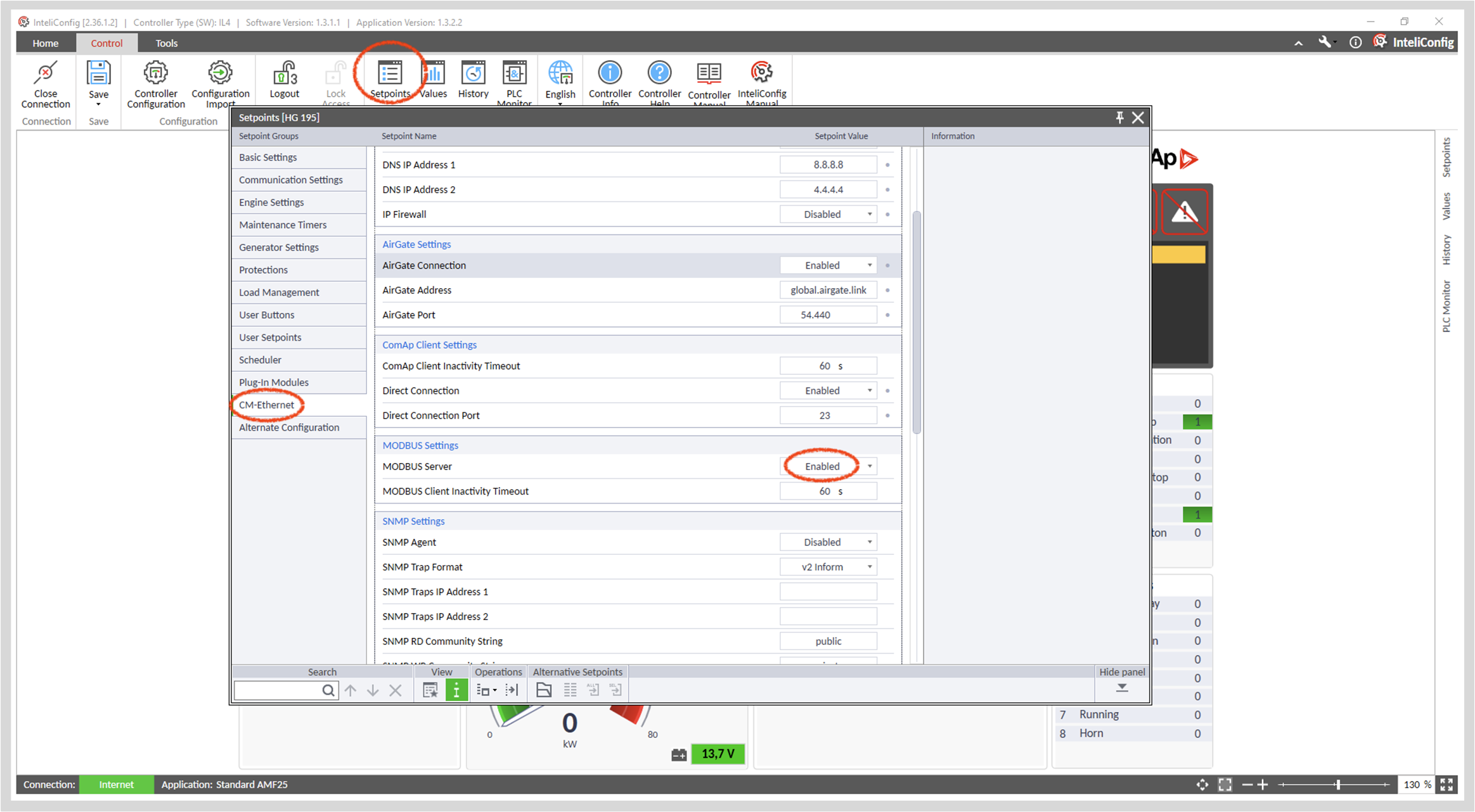

Enabling the controller’s Modbus server
Select the Setpoint tab
In the subsequent menu, select the CM-Ethernet module
Enable the Modbus Server

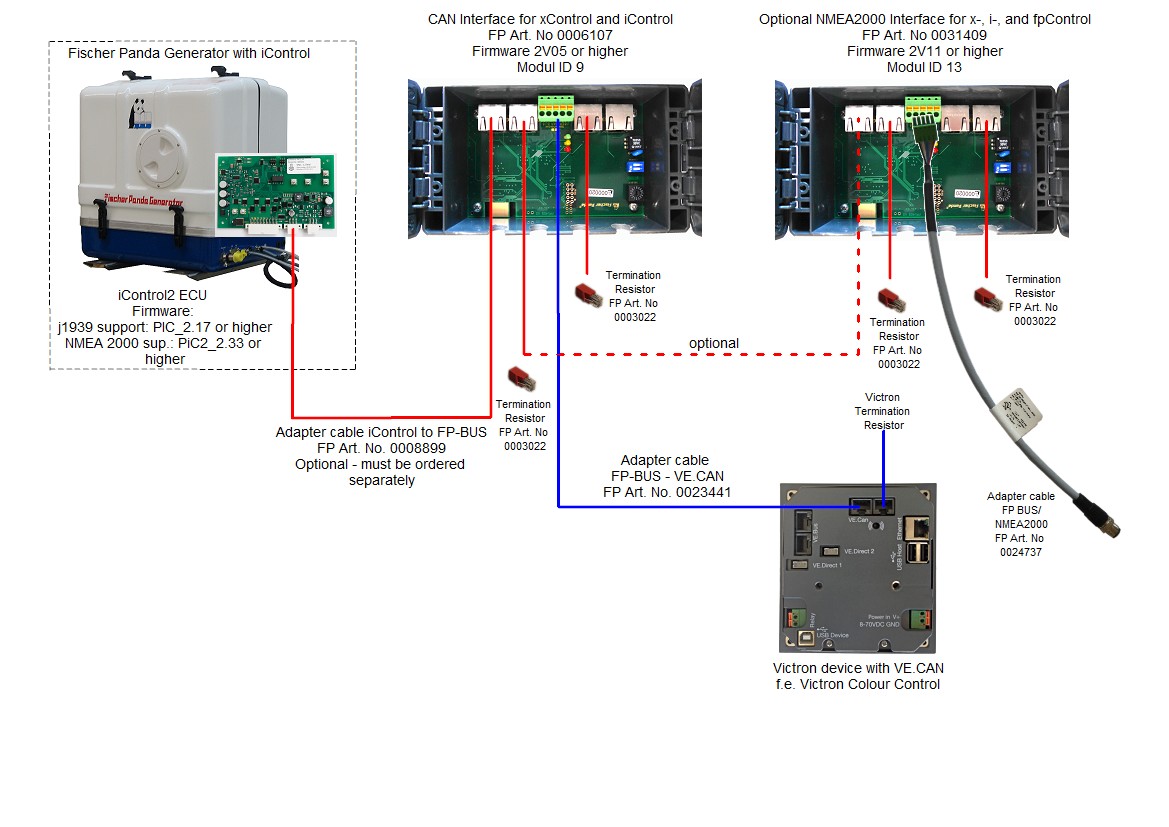

Connecting a Fischer Panda xControl generator
The schematic below shows how to connect a Fischer Panda xControl generator.
Connecting a Fischer Panda iControl generator
The schematic below shows how to connect a Fischer Panda iControl generator.
Connecting a Fischer Panda fpControl generator
The schematic below shows how to connect a Fischer Panda fpControl generator.
