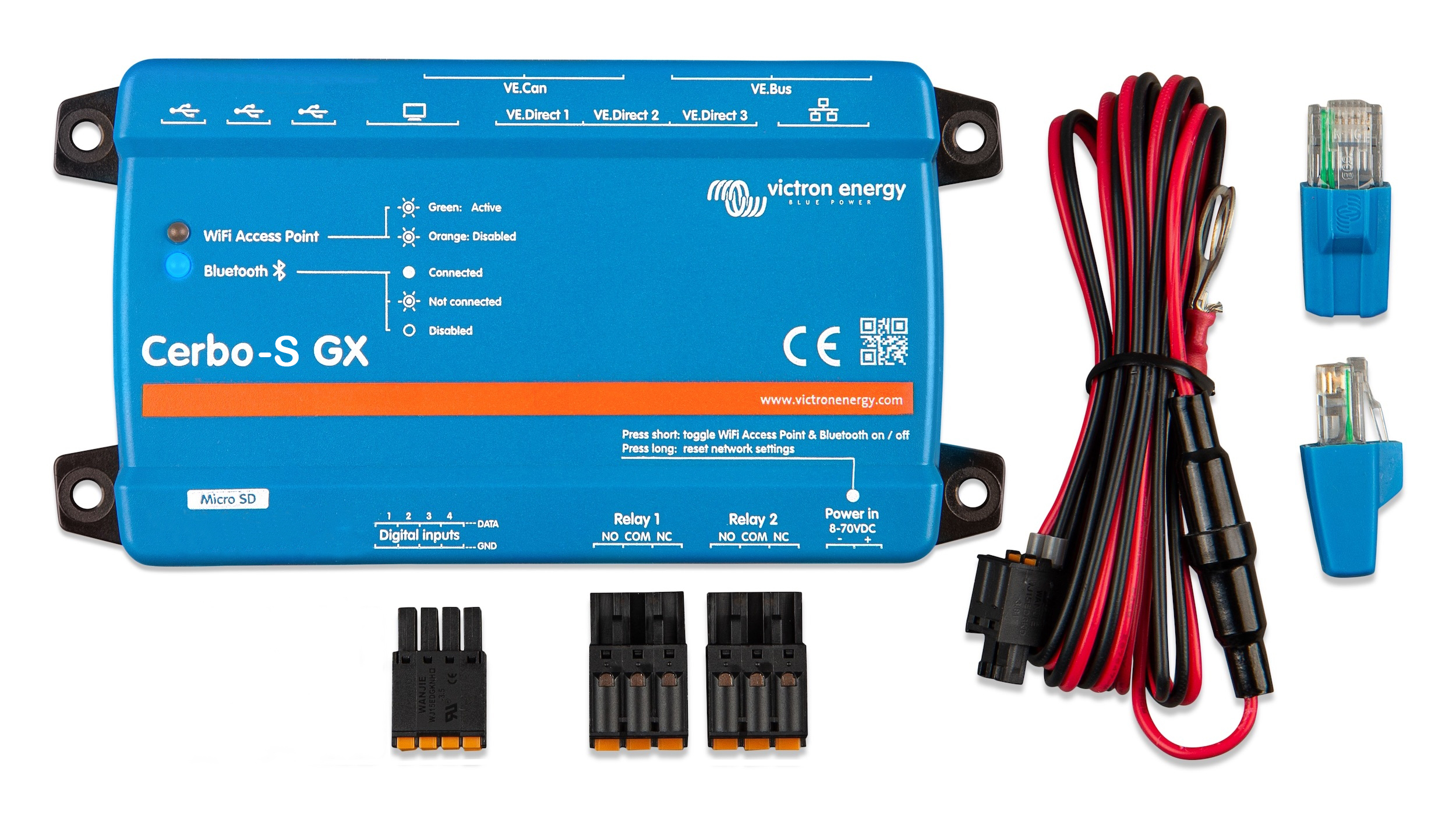

2.2. What's in the box?
Cerbo-S GX
Power cable with inline fuse and M8 terminal eyes for battery or DC busbar-attachment.
VE.Can terminators (2 pcs)
Terminal Blocks for all the connectors on each side.
