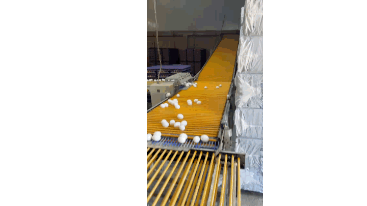

What began as a small chicken rearing operation 55 years ago in Arnavutköy, Türkiye has grown into a large farm business housing 110,000 chickens and 100,000 chicks at any one time. It also produces around 3,200 eggs a day.

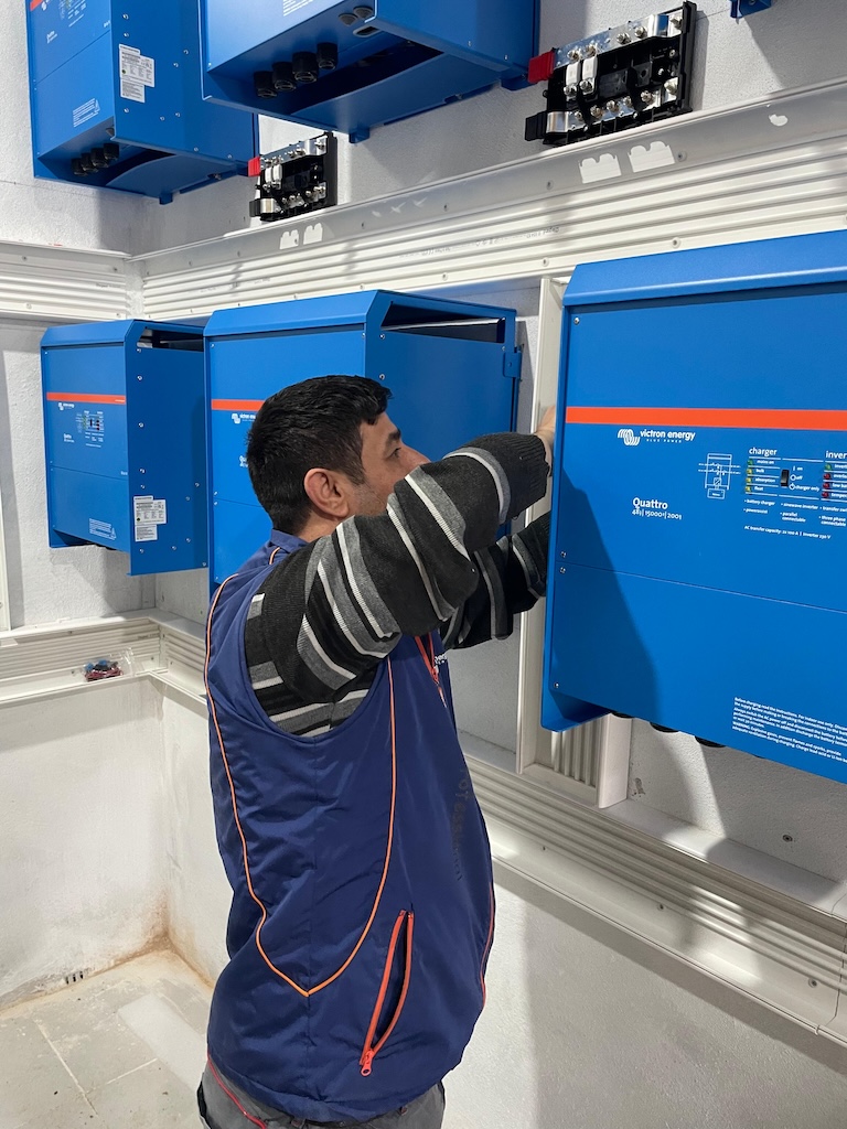

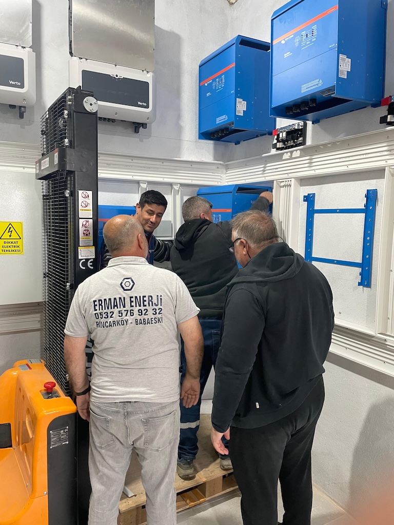

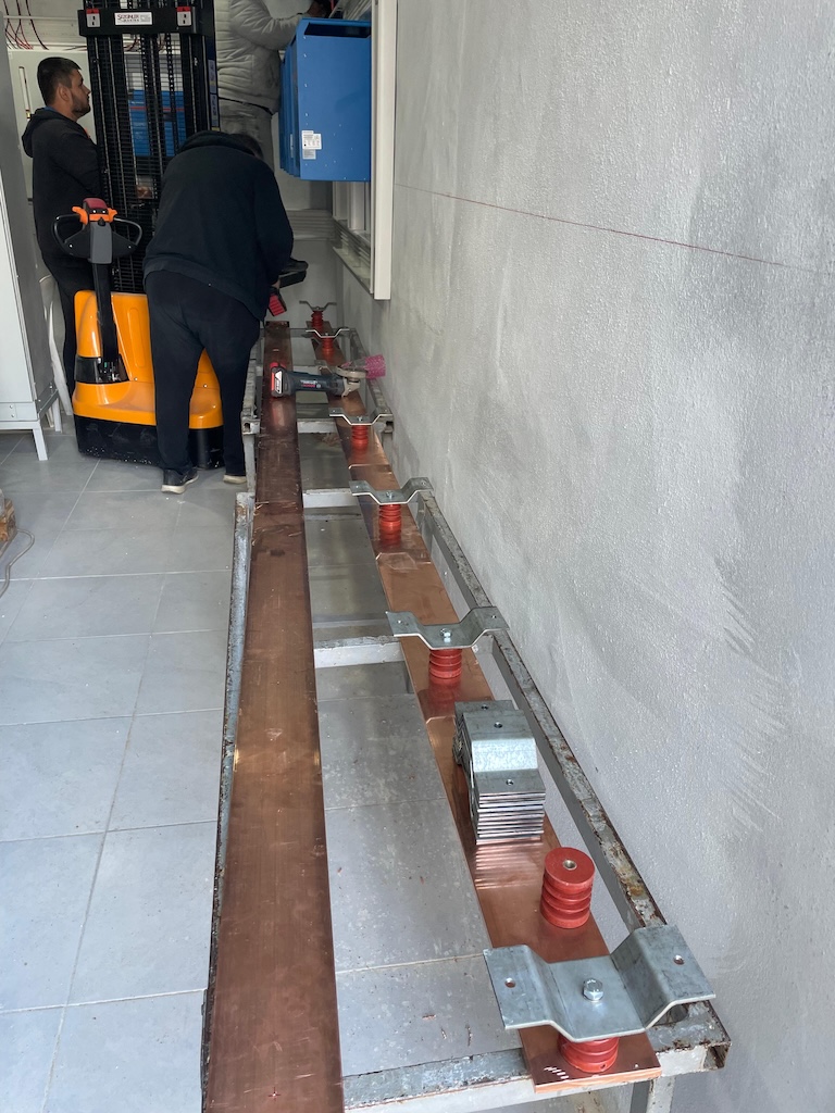

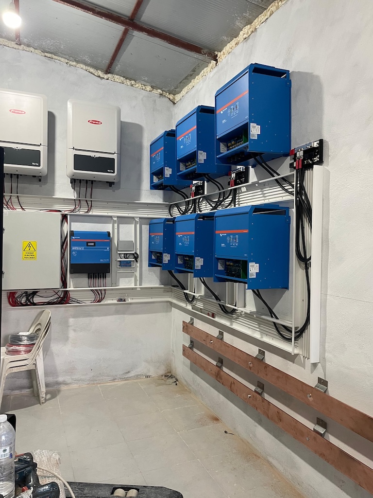

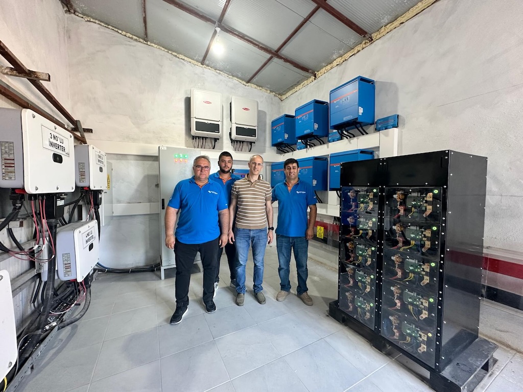

Construction work was carried out for a properly ventilated technical room. PV module strings were connected to Fronius inverters …along with Solar MD batteries. The system now operates flawlessly and has reduced electricity costs by half.
The farm installation now operates from two supplies: the enhanced grid-connected solar installation; and the 90kVA Victron Energy ESS system. The technical room – where the batteries are housed – has been designed to allow future expansion to 180kVA and further storage as the business grows.

System overview
The installation combines both AC-coupled and DC-coupled solar generation within a Victron Energy ESS.
The system is both AC- and DC-coupled and operates as an ESS and includes:
Standing with sales manager Bülent, in blue left to right are: Erman Tanyoldas – owner of Erman Enerji,  Enes Dik – technician, and  Hasan Tendik – project manager.
