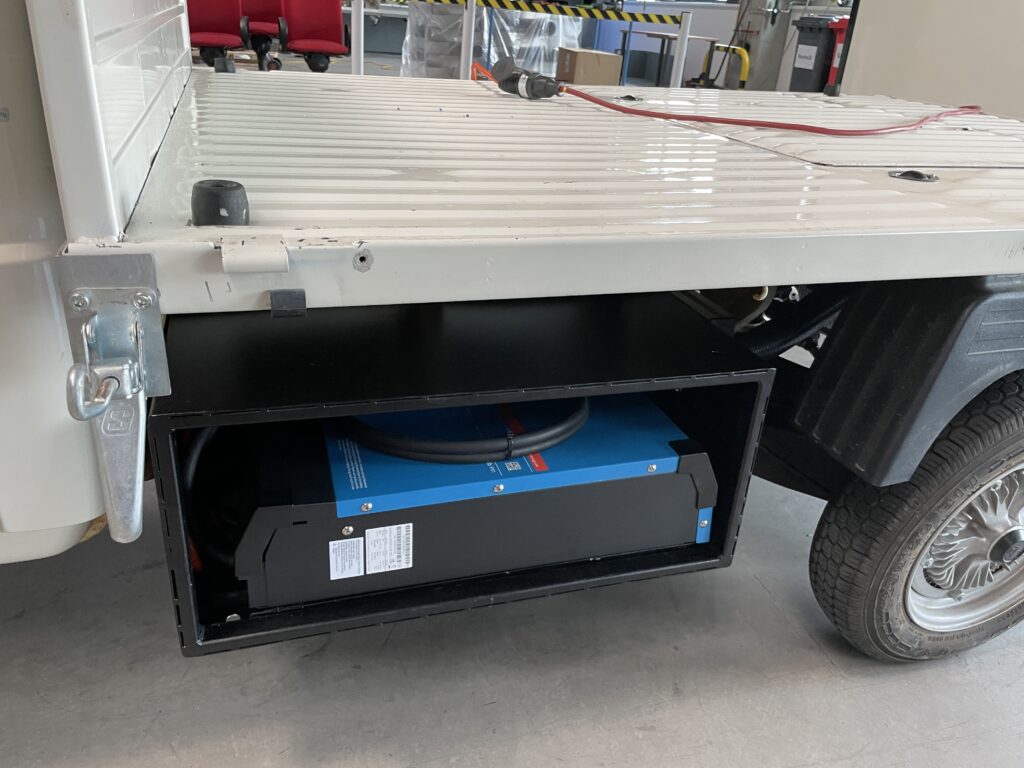

Devices used throughout the power installation have been thoughtfully located by the ERNI team to maximise use of the limited space available on the Piaggio Ape. Removing the engine, gearbox and associated fittings provided valuable extra space.
Tailor-made boxes to contain system devices are welded during the fabrication process using the GoFa™ CRB 15000 robotic arm!

- The ice cream maker draws quite a high start-up load at over 3kW for which reason two MultiPlus II 48/5000 inverter chargers have been installed, configured to provide 10kVA

Temperature sensors control the active ventilation of the inverters installed in compact housings to prevent overheating.

- Using the relays etc. it was really possible to control the fans (boxes from the MultiPlus’s and from the container itself).
