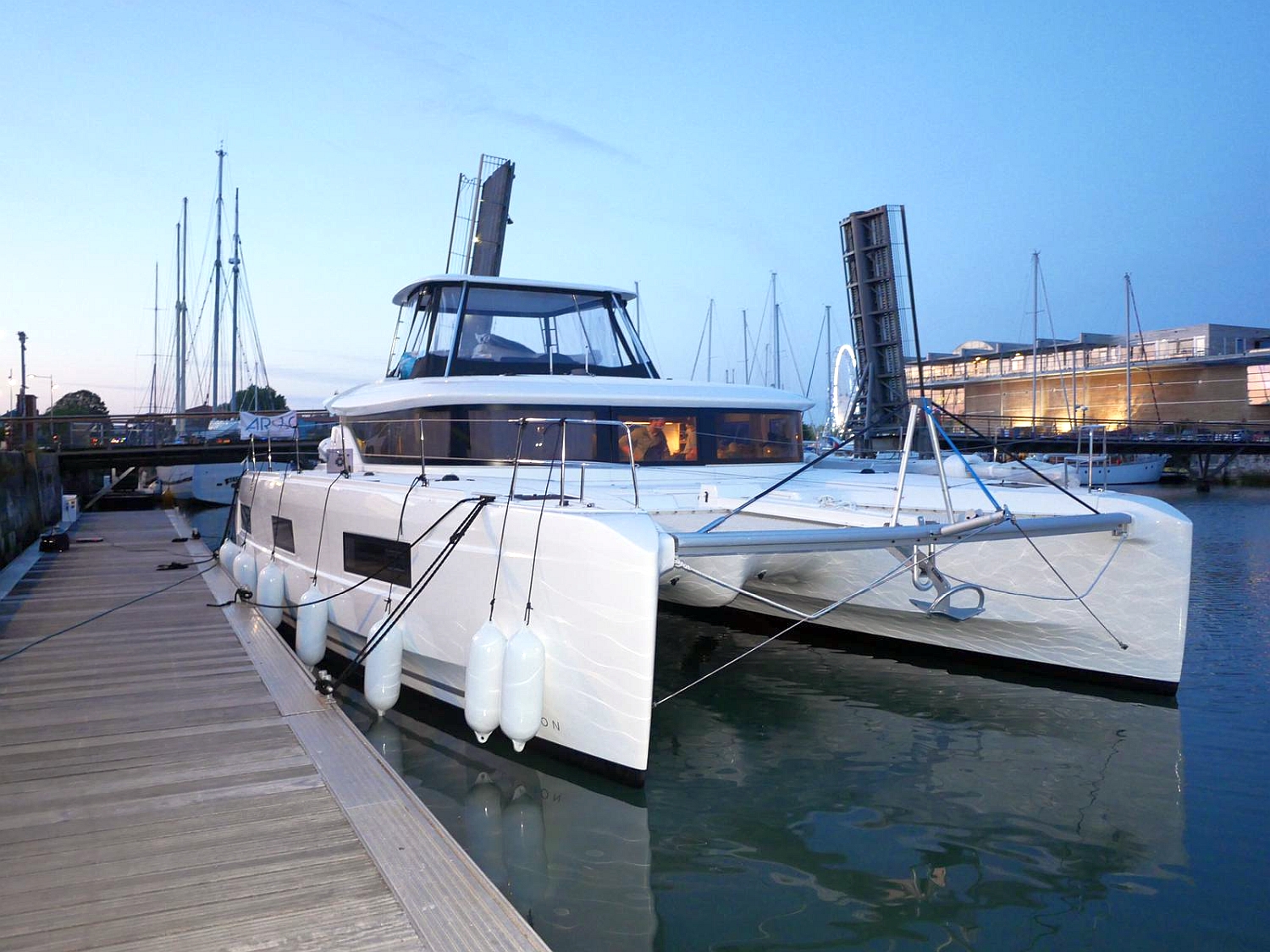

Integrel has now been fitted to a number of vessels – all of which use Victron Energy products. They include Armorel – a Hallberg Rassy 42 (using just one fuel), Topaz – a Sun Odyssey 44, plus a brand new Lagoon 46, which uses 4 x Victron 200Ah, 25,6V Lithium Smart batteries in series/parallel giving 20.48 kWh of energy storage @48V, along with an 8kVA Quattro combined inverter/charger.

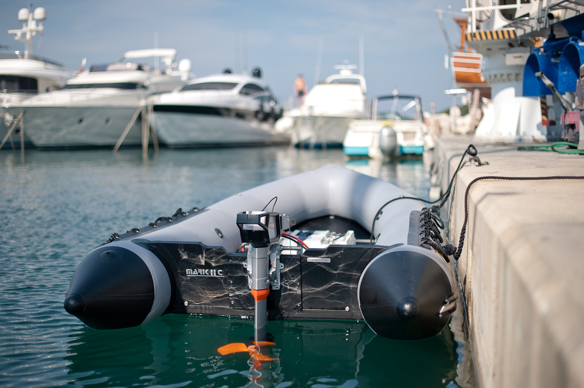

Secondly, we’ve done away with the 4 stroke outboard tender engine, the reasoning behind this is two-fold, we don’t want to have multiple fuels – yet another flammable hydrocarbon – therefore electric simplicity is key. Also, 4 stroke engines seem to struggle more and more with modern fuels as there’s a higher level of bio-ethanol in petrol these days, which gums up carbs and makes them less reliable. Modern electric outboards are great, requiring less maintenance with a similar performance and they charge straight from a 230V socket.
Torqeedo offer an excellent range of electric outboards. Their Cruise models range from 5 – 20hp.
Torqeedo Cruise electric outboard.

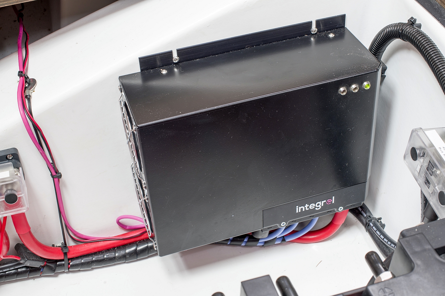

Integrel
“Integrel to our mind is the future of power generation afloat, completely replacing your stand-alone generator by using spare capacity from your existing inboard diesel engine. Integrel uses smart new technology to generate up to 9kW of electrical power without compromising your engine’s performance. In fact, the system actively manages its output, so that the engine is always running at its most fuel efficient.

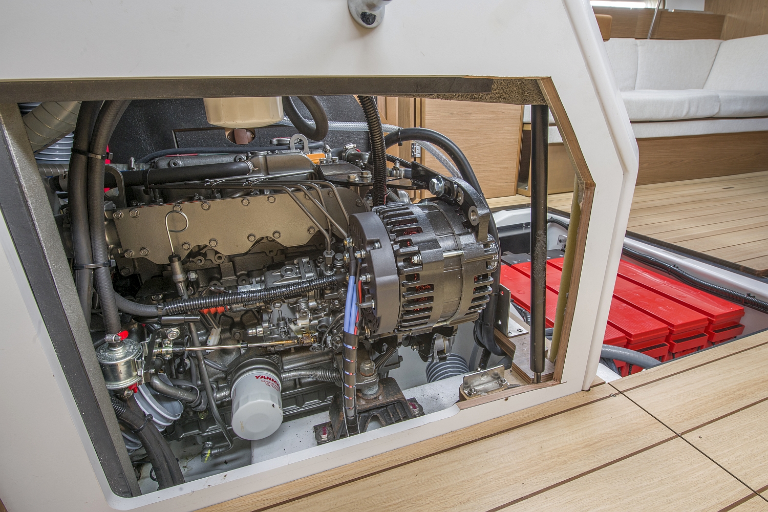

Side view of a standard diesel engine with an Integrel Generator, fitted to Topaz, a Sun Odyssey 44. The battery bank on the right is a 48V bank, comprising of 4 x Odyssey PC1800-FT batteries.
By using your engine for both propulsion and power generation, both tasks are delivered at optimum efficiency, resulting in overall fuel savings (in comparison to a separate generator and diesel engine) of up to 25%. One engine, two jobs, less fuel.

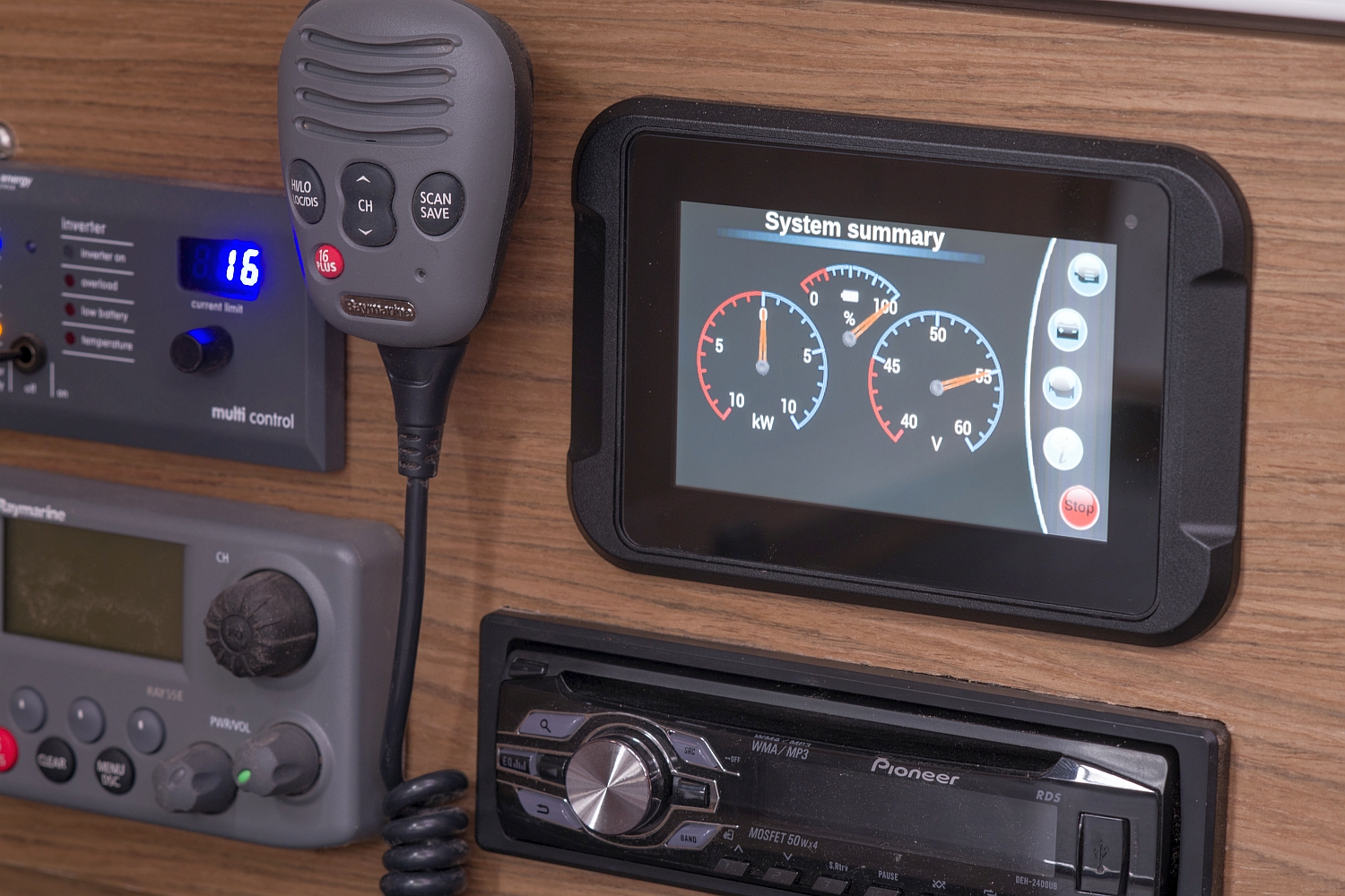

Integrel Smart Controller aboard Topaz, a Sun Odyssey 44.
Integrel is completely automatic, working in the background with no direct input from you. It requires no maintenance other than a periodic belt change, offering substantial savings on fuel and maintenance costs across its lifetime.”
Integrel Monitoring aboard Topaz, a Sun Odyssey 44.

Lagoon 46 – integrating Integrel and Victron Energy power products.
