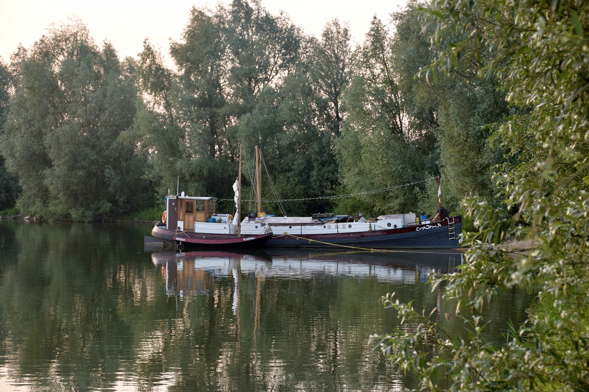

Before I go further, l shall explain some things. The ship on which the solar panels will be installed is called Clasina, being the mothership of the Sea Scouts in the Dutch city Deventer. Clasina is a 90 year old vessel that has been used until the late 1950s to maintain the waterways in Holland. She is a 17 metre long and 4.2 metre wide (58 x13 ft) vessel, maintained by a handful of volunteers on a tight budget.

Shown below is Clasina on a pontoon berth with the completed solar installation keeping the batteries topped up between trips – and not having to use any of the connected shore power you can see – whilst we dream of our next adventures on our scouting mothership Clasina.
