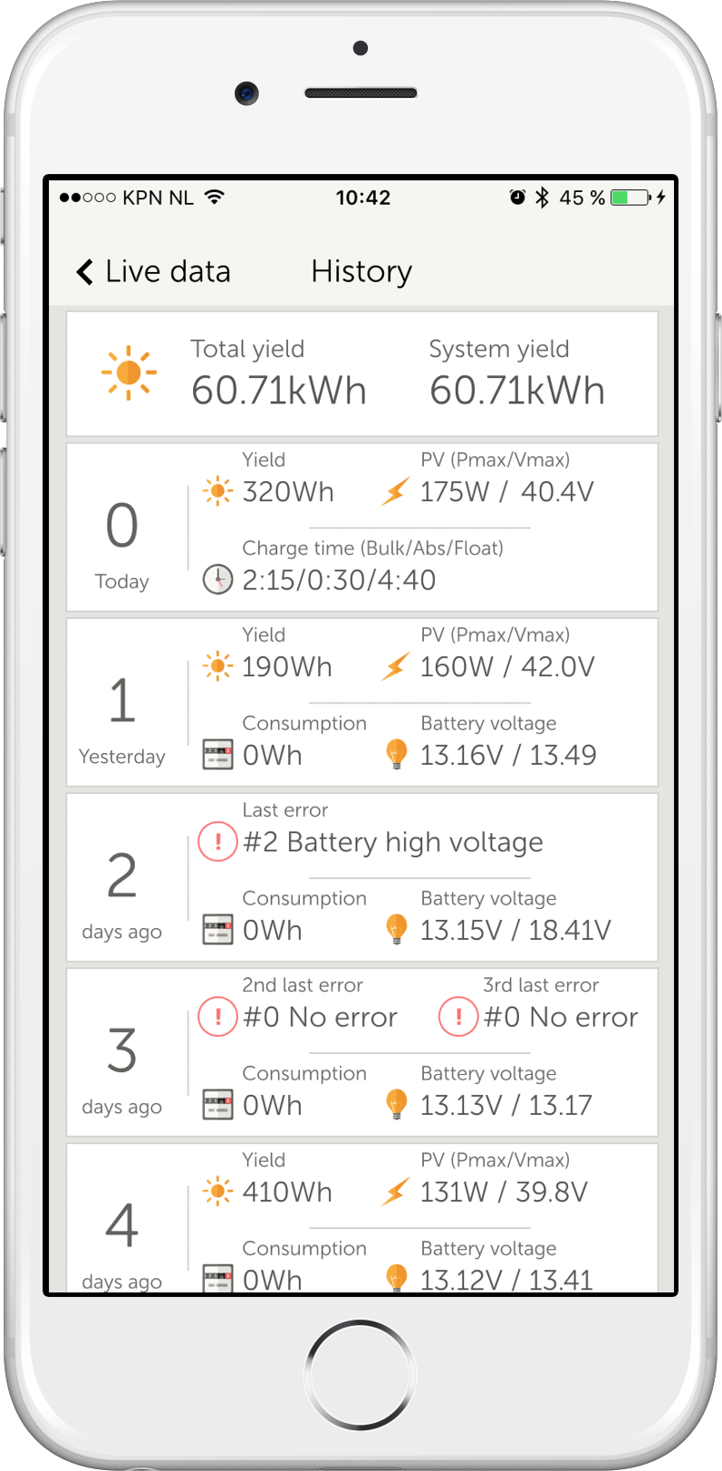

Saving 30-day BlueSolar MPPT history as a CSV file
Most of our solar chargers keep a 30 day history log. Visible in VictronConnect like this:

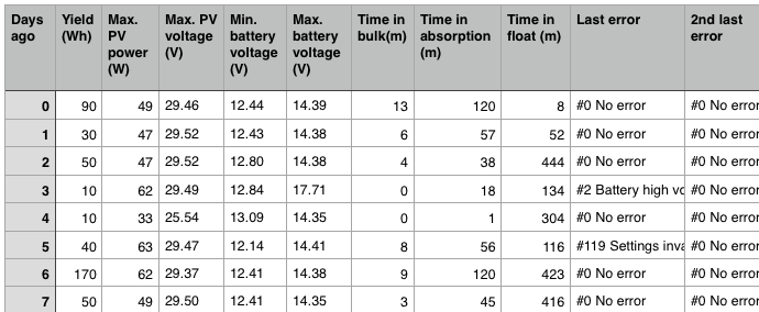

Now there is a new feature: save this data as a CSV file, and review it later. This is how the file will look in Excel or another similar tool:

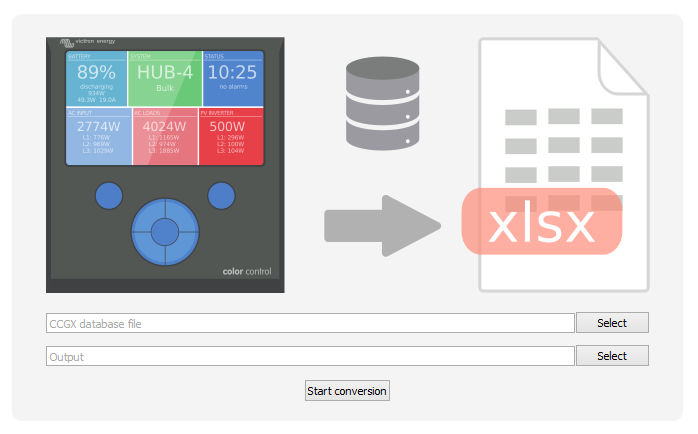

Use VictronConnect to convert Color Control data logs to Excel
In installations that have no internet connection, the Color Control GX can store the datalogs on an SD card or USB stick. VictronConnect can now be used to convert the file on that stick to an *.xlsx file. The procedure is quite simple:
  1. On the Color Control GX, navigate to Settings -> VRM Portal, and click the Eject function
  2. Take the SD card or USB stick out, and insert it into your computer
  3. Open the new feature in VictronConnect
  4. Select the file and then click the Start conversion button
  5. Done: open the file in Excel to see the result.
