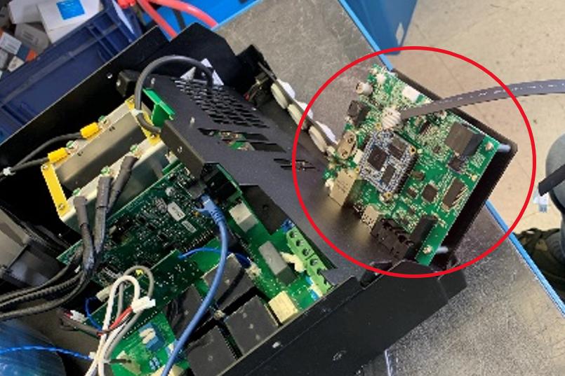

7 | Locate the GX card location, indicated by the red circle in the image below. ![]() |

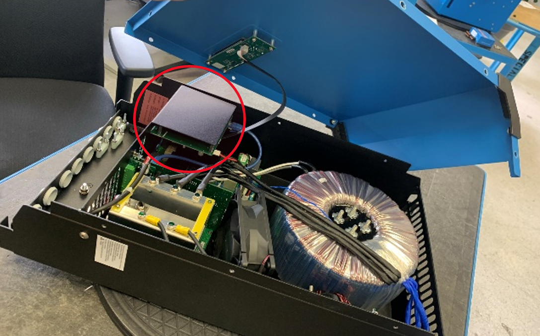

7 | Carefully flip the bottom plate over to reveal the GX card. ![]() |
