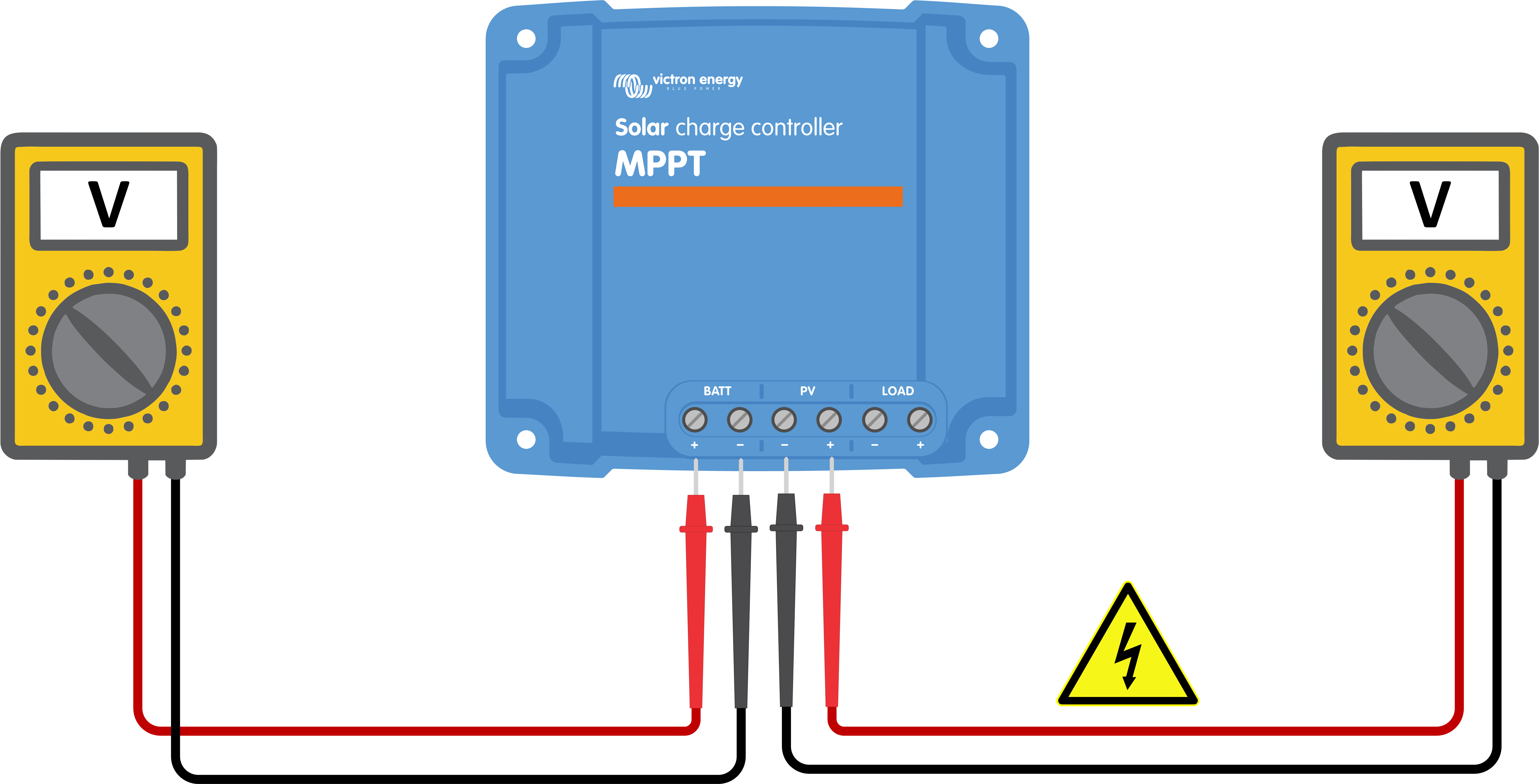

To troubleshoot, verify that the solar charger is receiving either battery or PV power, using the below procedure.
Unresponsive solar charger troubleshooting procedure | ||
Step 1 | Set a multimeter to DC voltage mode. | |
Step 2 |
WarningWARNING: Certain solar charger models may have PV voltages up to 250Vdc. Voltages exceeding 50V are generally considered dangerous. Only a qualified technician should handle dangerous voltages. | |

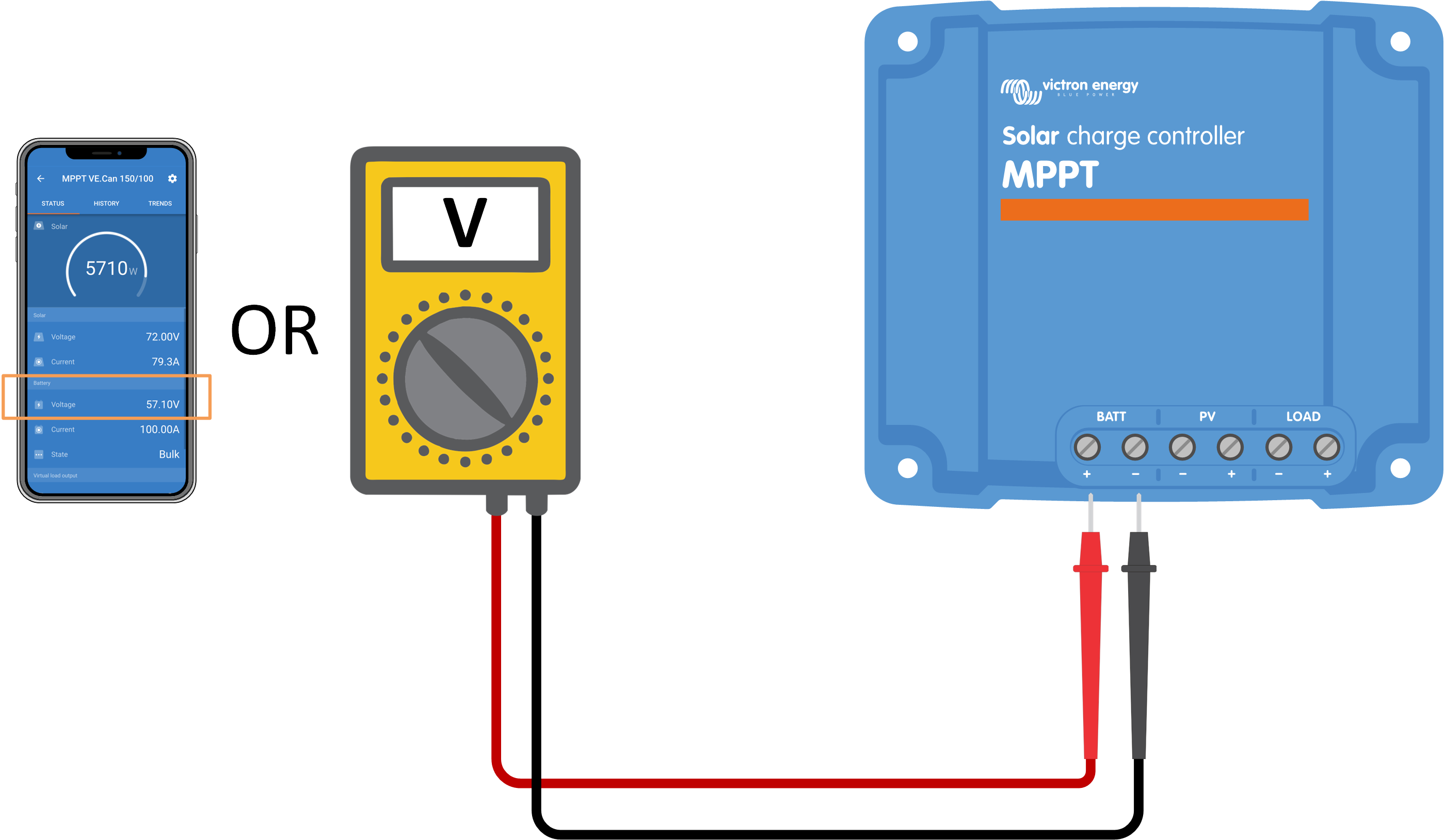

Battery voltage check | ||
Step 1 | Use the VictronConnect app, a connected display or a GX device to read the solar charger battery voltage. Alternatively, use a multimeter to measure the battery voltage at the terminals of the solar charger.
Step 2 | Use a multimeter to measure the voltage at the battery terminals.
Step 3 | Compare the two voltages. | |
Step 4 | In case of a voltage difference, investigate the reason behind it by tracing the path from the solar charger to the battery to identify the cause.
NoteShould you come across a blown fuse, make sure to check the correct wiring of the battery polarity before replacing it. Refer to the Reverse battery polarity chapter. | |

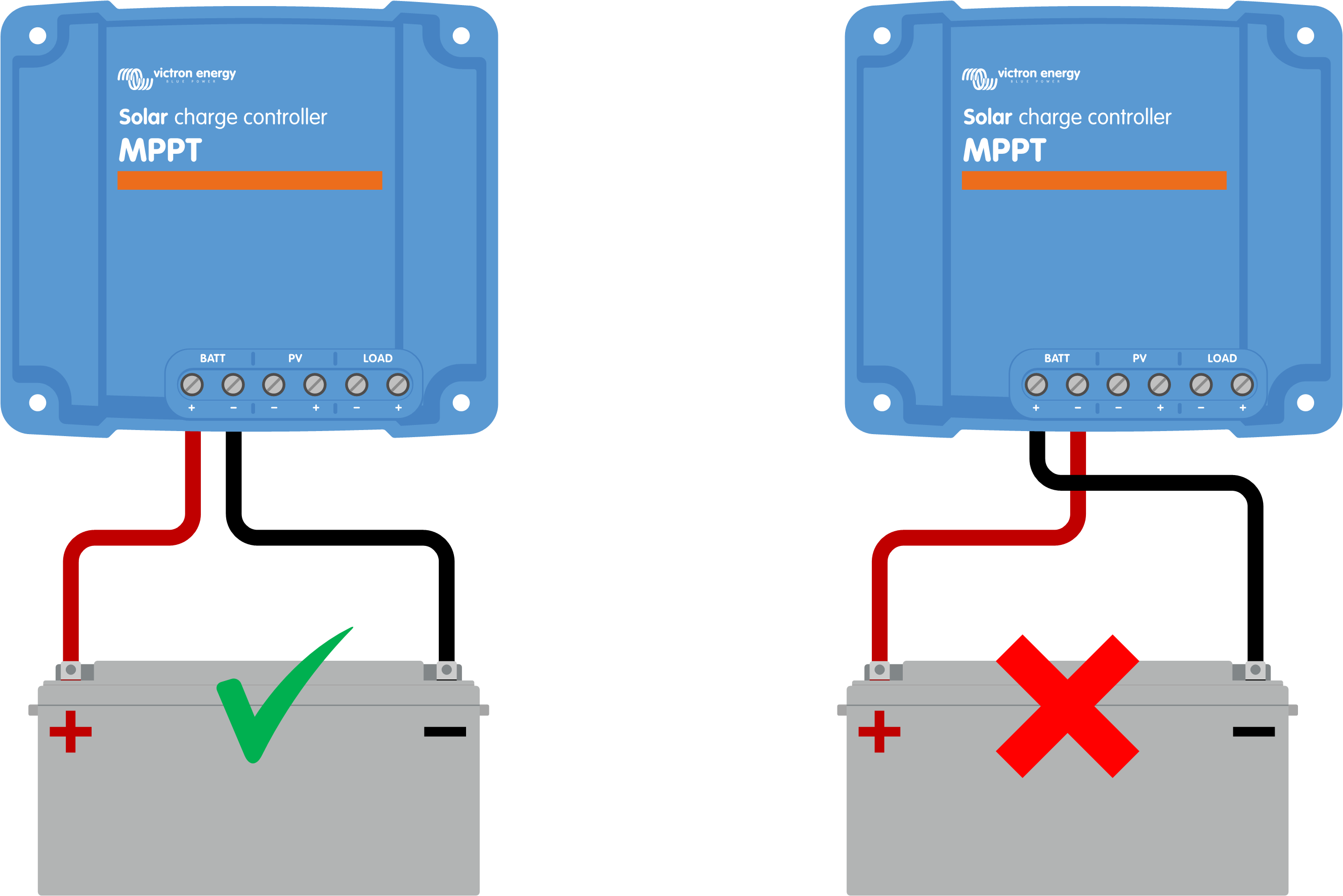

8.5.3. Reverse battery polarity
Reverse polarity occurs when the positive and negative battery cables are accidentally swapped. This means the negative battery terminal connects to the positive solar charger terminal, and the positive battery terminal connects to the negative solar charger terminal.
Examples of correct and incorrect (reverse) battery polarity.
Caution
Be aware that a red or positively labelled cable may not necessarily indicate the cable is positive. A wiring or labelling mistake during the solar charger installation is possible.
Always double-check the battery polarity before reconnecting the battery wires to the solar charger.
Reverse battery polarity has the potential to damage the solar charger, causing its fuse to blow for fail-safe protection. This fuse might blow before the external fuse in the battery cable. If you encounter a blown solar charger fuse, before attempting replacement, refer to the Blown fuse chapter to assess if replacing the fuse will fix the solar charger. In some cases, the solar charger may still be considered faulty even after a fuse replacement.
The solar charger is not protected against reverse battery polarity, and any resulting damage is not covered under warranty.

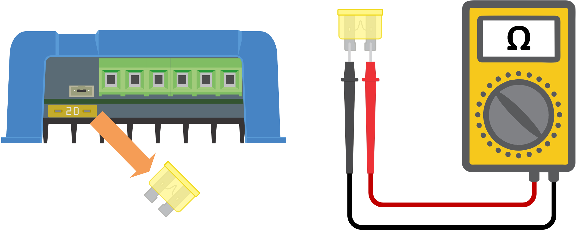

8.5.4. Blown fuse
The solar charger is equipped with an accessible fuse, which typically blows when the battery is mistakenly connected in reverse polarity.
Steps to check the fuse: | ||
Step 1 | Remove the fuse. | |
Step 2 | Use a multimeter in resistance mode to check for continuity.
Step 3 | If the fuse is faulty, verify the battery polarity and correct it if necessary. Refer to the Reverse PV polarity chapter. Keep in mind that reverse battery polarity is not covered by warranty. | |
Step 4 | If the new fuse also blows, the unit may be considered faulty. | |

Battery cable voltage drop check | ||
Step 1 | Make sure that the charger is charging with the full current, preferably in the morning. Use the VictronConnect app to confirm the output current. | |
Step 2 | Using the VictronConnect app or a multimeter, measure the voltage on the battery terminals of the solar charger.
Step 3 | Measure the battery voltage on the terminals of the battery using a multimeter.
Step 4 | Compare the two voltages to identify any voltage difference. | |

Ensure an accurate load output reading by connecting all loads to the solar charger's positive and negative load terminals(image A).
Incorrect current reading:
Do not connect the positive cable of the load to the load output and the negative cable to the battery (image B). This will result in an incorrect load current reading,

8.11.1. Only voltage readings, no current or power
This only applies to some 10A and 15A solar charger models.
If the solar charger only shows voltage readings and omits current and power readings, it indicates that the current monitoring is bypassed due to a potential PV negative being mistakenly connected to the battery negative.
To rectify this, make sure to connect the PV negative to its respective terminal instead of the battery negative.

This error will auto-reset after the battery temperature has dropped. The solar charger will stop charging to prevent damaging the battery. The battery temperature can be received by an external sensor (like Smart Battery Sense or BMV) or measured by the charger when this feature is available.
8.12.2. Error 2 - Battery voltage too high
This error will auto-reset after the battery voltage has dropped. This error can be due to other charging equipment connected to the battery or a fault in the solar charger.
This error can also occur if the battery voltage (12, 24, 48V) is set to a lower voltage than the connected battery.
