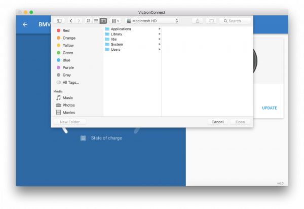

Instructions for Windows and MacOS computers

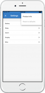

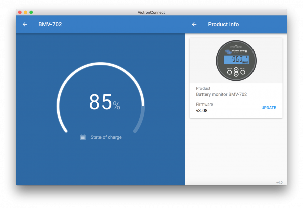

With your phone and Victron product connected to VictronConnect, go to the “Product info” page, click on “Update” and open the correct firmware file.
There is no need to worry about using a wrong file - VictronConnect will always first check if the file matches the product. And if wrong, it will show a “wrong firmware file error”.

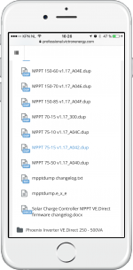

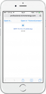

The process is slightly different from the Windows/macOS routine, as there is no file browser on a mobile device.

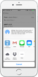

Firstly, you need to add the desired firmware file to the VictronConnect firmware library. Firmware files can be added to the library from an email attachment, web browser, Dropbox, file browser, and any kind of app that can handle files. For both iOS and Android the procedure to add the file is the same: go to the app that contains the firmware file, tap on it, and open it with VictronConnect. VictronConnect will be opened and show: “File added to the firmware library”.
If the message doesn't appear, repeat the previous step or try opening from a different app (for example, Dropbox instead of the internet, or Email).
In case you are not sure which file to use, it is not a problem to add multiple files to the library. In the next step, VictronConnect will automatically only show the files that match with the connected product.
Note for iOS: The current version of Google Chrome for iOS fails to download “.dup” files from the Victron Professional website - so we recommend using Apple Safari, the default browser on iOS, instead.
Note for Android: VictronConnect needs to be running before opening files.
Open VictronConnect and, without closing it, switch to the app containing the file, select it, and choose to open it with VictronConnect.

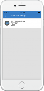

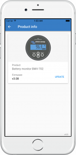

Now, after adding the firmware file to the library, go to the “Product info” page and tap on “Update firmware”:
Select the desired file from the list, see next screenshot - it shows one entry in the list:
Note that the update mechanism will detect-and-reject firmware files which are not targeted for the current product: there is no need to worry about loading a wrong firmware file.

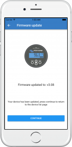

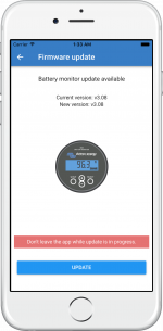

Once selected you will be guided through the update process:
