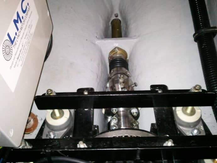

The photo shows 2 x 12.8V 200 Ah Lithium-iron-phosphate (LiFePO4 or LFP) propulsion batteries with cell balancing and BMS (shown centre). From front to back, starting on the left – Cyrix load & charge under/over voltage cut off relays, 200 Amp main fuse. Top left 1 x 10A and 1 x 6 A 230V shore power breaker with galvanic isolator (I didn’t realise Victron made a galvanic isolator when I bought that), then the PWM electric motor controller box with a BMV-702 shunt fitted inside and a 600 Watt Phoenix charger (for the LFPs) behind that. Right from front – 12 A extra charger for the 24V x 130 Ah AGM house bank, 16 A extra charger for Lithium propulsion bank, 75/15 MPPT Solar Charger Controller to run my 4G router which accesses the Victron VRM site, a 50Watt tube heater (behind the auto fire extinguisher) to keep moisture at bay in the propulsion space.
Out of sight, behind the batteries, is the L.M.C/Lynch electric motor, controller and propulsion drive train. The project is all my own work. Not too bad I hope for an ex Royal Navy steam engineer who is mostly mystified by electrics and electronics.
