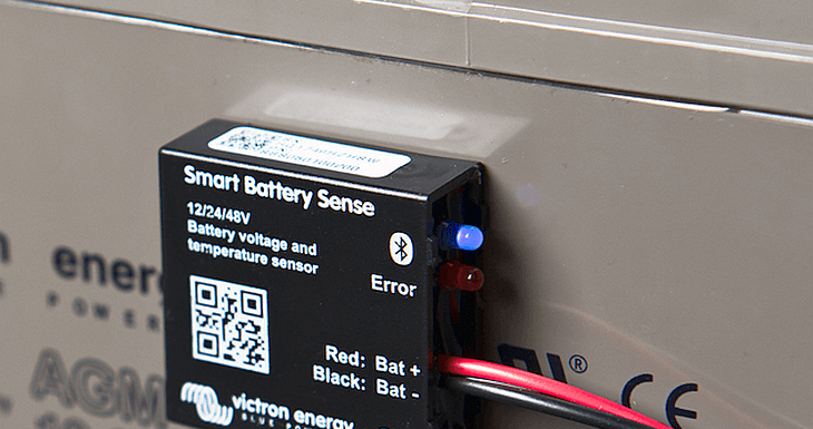

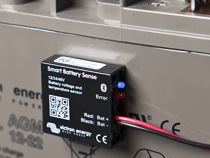

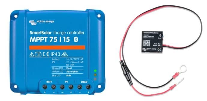

The Smart Battery Sense is a wireless battery voltage and temperature sensor for Victron MPPT Solar Chargers.
Perfect partners.
  • Simple installation – attach the unit to any battery by its self-adhesive tape.
  • Protected by an inline fuse.
  • Voltage and temperature data is transmitted wirelessly to the Solar Charger.
  • Monitor & configure the unit from your smart phone – via our free-to-use VictronConnect app.
  • Transmitted data can be networked to one, two – or more solar chargers connected to the same battery bank.
  • Works for 12, 24 and 48 volt battery banks
  • Works for both Lithium and Lead battery banks
  • Compatible with most BlueSolar and SmartSolar MPPT charger models: see VE.Smart Networking for compatible-models list.
Learn more from the Smart Battery Sense product page or from the Smart Battery Sense Manual – together with the VE.Smart Networking manual. Or watch the Smart Battery Sense introductory video:
