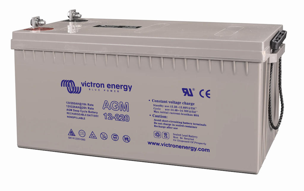

- The original battery storage was from 8 x 12V AGM Deep Cycle batteries of 220Ah each. We changed them for Lithium Battery Smart after seven years …though I still use some of the original Lead Acid batteries on my boat.

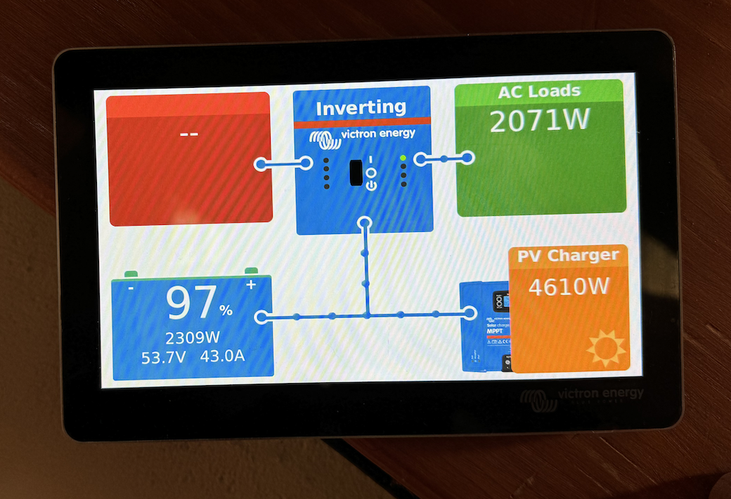

- We have a GX Touch screen display which allows us to do all the things above, at home.

The system worked fine, but after seven years I decided to upgrade the cables from 4mm to 6mm, and to daisy chain them on the roof (halving the cable run). I immediately noticed an improvement of over 15% in the solar harvest. Our 4kWp array will occasionally max out at 4.6Kw for short periods!

For the first seven years we used Lead Acid batteries offering 440Ah at 48V. They were perfectly satisfactory, and we were careful not to deplete them beyond 50% State of Charge (SoC). Key to this was only running large energy consuming devices – such as the washing machine – around the brightest part of the day wherever possible …or if it was overcast, delay the job until tomorrow, if ‘tomorrow’ was forecast to be sunnier.
If lead acid batteries are habitually allowed to drain below 50% SoC they will age prematurely, lose capacity, and need to be replaced much sooner than hoped.
We changed our batteries after seven years when I judged that their capacity had fallen to about 80% of the original – 440Ah had reduced to 350Ah. For the new battery storage we chose Lithium. That change brought an immediate advantage – as well as the usual long-term advantages:
One of the frustrations of using Lead Acid batteries becomes obvious during winter months when the days are short. Winter sun can be very bright because cold air carries less humidity, resulting in more irradiance for solar harvest. But Lead Acid batteries can only be charged relatively slowly – a 100Ah battery can only be charged at 20A, and in order to avoid boiling the battery even that charge current must be gradually reduced once the SoC climbs over about 80%. (Remember that you can only use the top 50% of SoC, in any case).
Lithium Batteries have much lower internal resistance – allowing them to accept charge at a much faster rate – the recommended charge rate for a 100Ah lithium battery is 50A – two and a half times faster – and they can accept that level of charge almost until they have reached 100% SoC. All this is a long way of saying that on short winter days when you may only get a couple of hours of decent sunshine, the difference between lead acid and lithium in terms of solar energy storage is remarkable. A lithium battery can frequently be fully charged from solar on days when lead acid will never get there.
The cost of lithium batteries is falling. At the time of writing the purchase price of lithium batteries is about two-and-a-half times the price of Lead Acid batteries per Ah. In the long run, however, the picture changes – Lithium batteries are the cheapest because they can achieve as many as ten times the number of charge-cycles of a lead acid battery. And during each one of those charge cycles more of the Lithium battery’s stored energy can be used – 80% for lithium vs 50% for Lead acid. The Lithium battery charge rate is faster (as already noted); and the charging process is more efficient – less energy is lost as heat, so more energy gets stored. Lithium Batteries store more than 95% of the energy they receive – Lead Acid might not manage much more than 80%. Get Lithium batteries if you can.

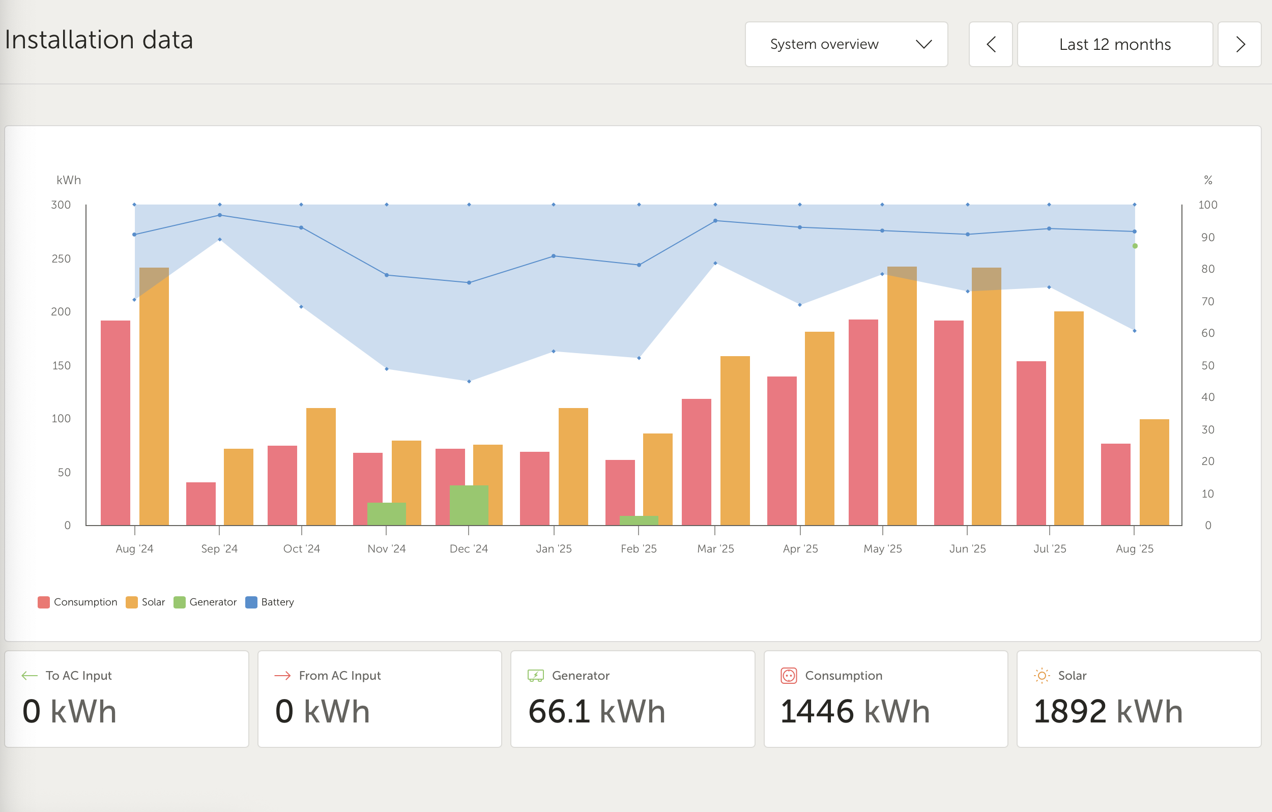

Our energy use is about half the typical household usage in the UK – there are only two of us. Our energy demand last year was met by Solar (95.5%) and Generator (4.5%). The cost of fuel for the generator was just over £40/$54/€46.

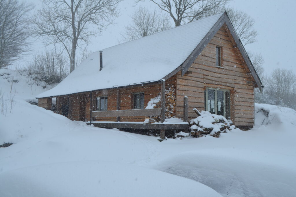

The more you do, the more you can do. I found that a willingness to try new skills of which I have no experience works every time! All it takes is the confidence to begin by taking the first step. Practical skills are learned by doing. I’ve taken it to extremes: I designed then built our home – carrying out every trade.

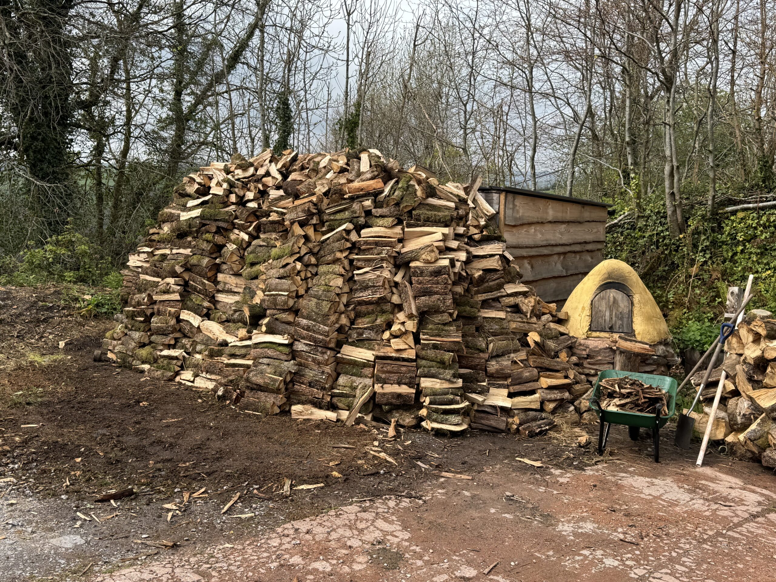

We’re off grid for all utilities; we heat our home with wood felled, sawn and split ourselves; I found a fresh water spring which is now tanked, pumped and filtered. And we have a private waste treatment plant. As a result the only bill that arrives in the post is a community charge (aggregated local service tax) at a cost of about £1100 / $1500 / €1275 per annum.

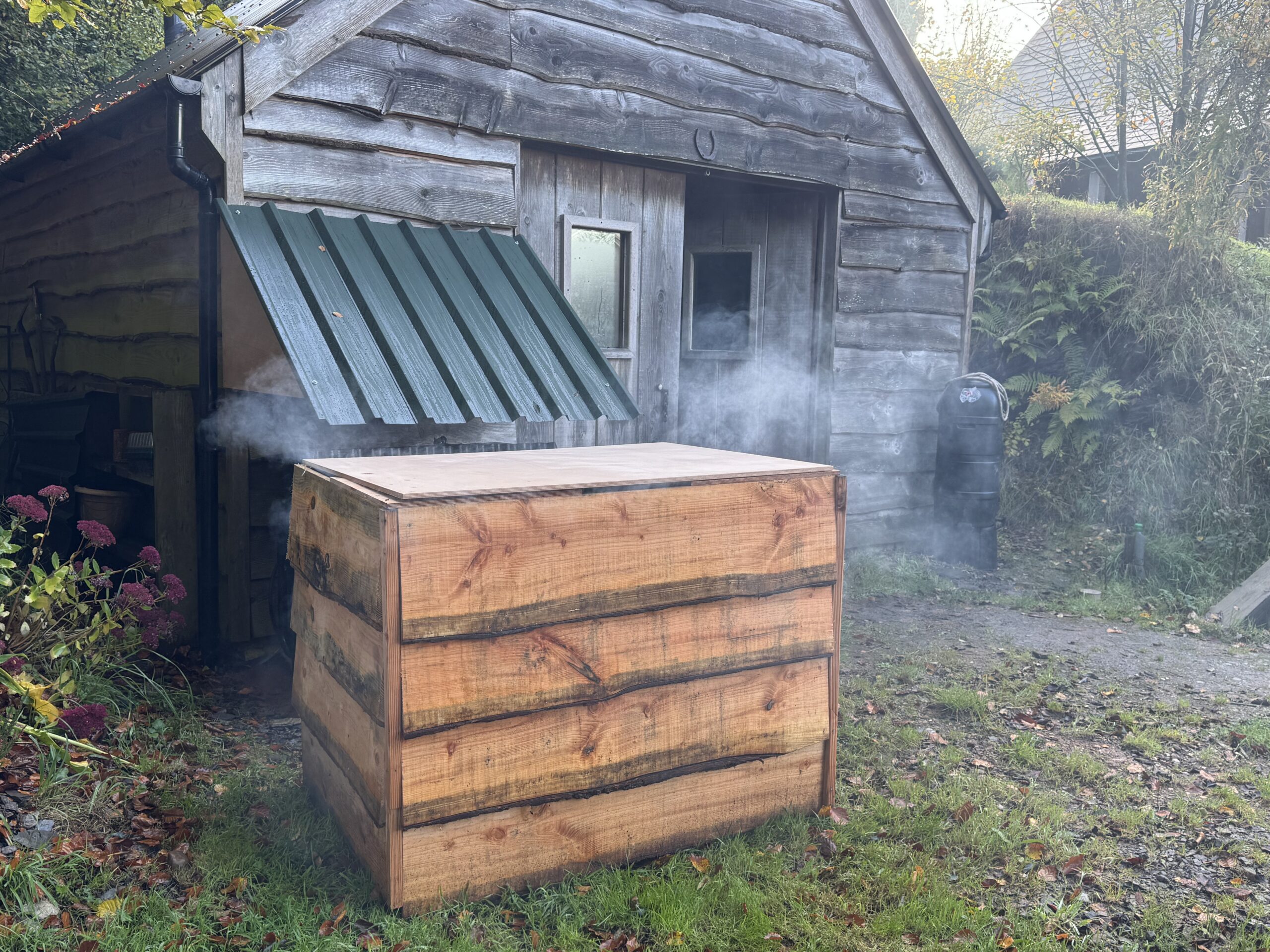

and then a smoker!:
