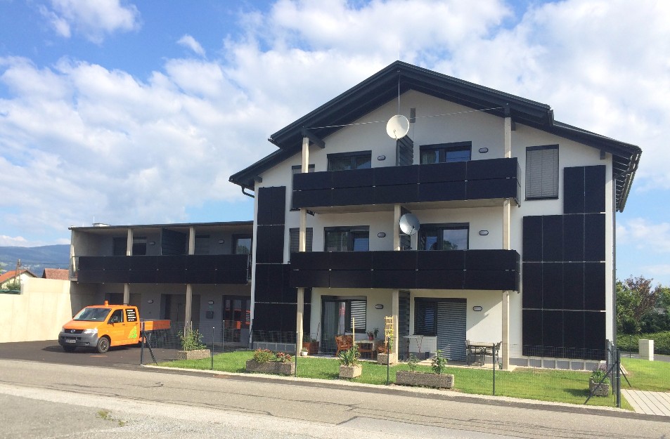

Apartment building in Frauental
This 8 apartment building is in Frauental in the Austrian region of Styria and it is shown in the headline image of this blog, where you can see that the PV system is placed on the roof, the facade, and even the balconies of the building.
This project is a showpiece in terms of self-consumption and increased self-sufficiency. The installed 30kWp photovoltaic system generates enough energy to heat and produce hot water for all of the 8 apartments, as well as enough to charge the Aquion batteries to ensure that all consumers are supplied by the battery stored solar power during the night hours.
The project was implemented by BlueSky Energy and their partner Langmann Consulting.
The energy storage system comprises:
  • 3 x Victron MultiPlus inverters for 3-phase operation.
  • Victron Color Control GX for system monitoring.
  • DC fused switchgear.
  • 12 x Aquion S30 batteries with a power of  8.1kWp and a storage capacity from 21.6 to 25.9 kWh (depending on charge/discharge power).
