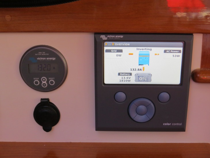

Victron Color Control GX
N.B. The photograph below was taken pre battery sync and a Color Control GX (CCGX) software upgrade. To keep abreast of software upgrades and enhanced features see the ‘Firmware & Software’ category of this blog:
https://www.victronenergy.com/blog/category/firmware-software/
