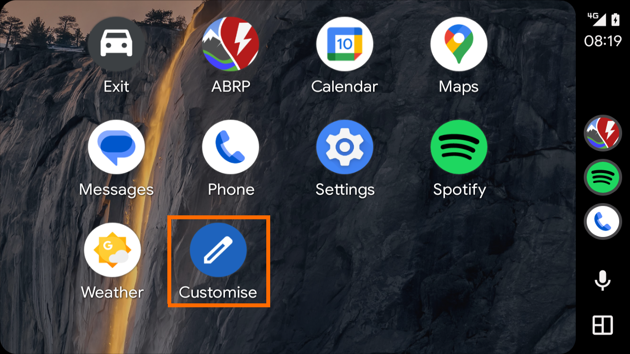

  • From the app launcher screen, tap "Customise".
This will open the "Customise Launcher" app on your phone.

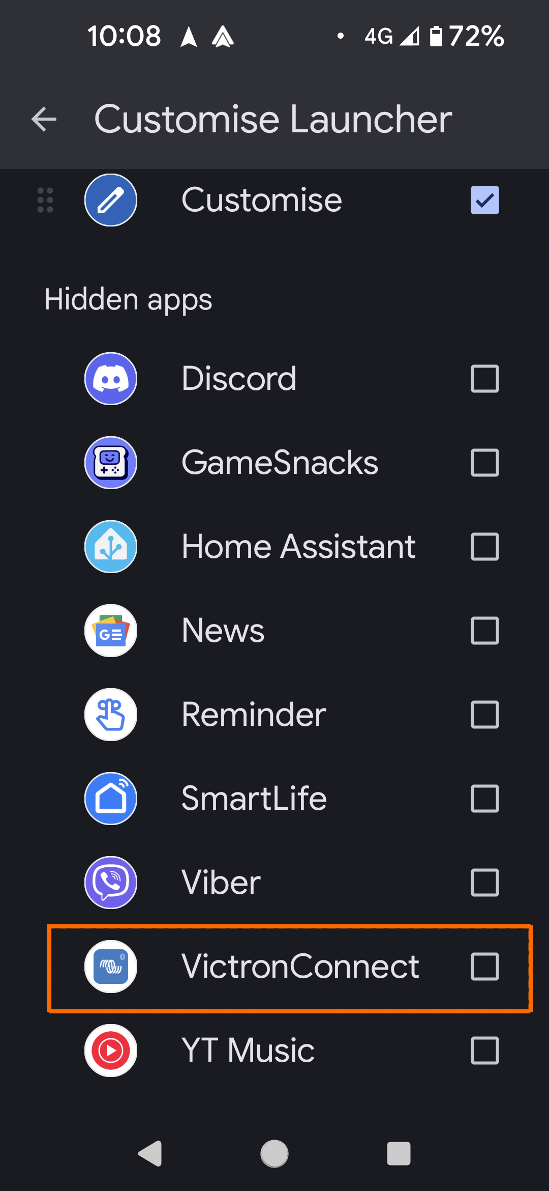

  • Scroll to the bottom of the list to find VictronConnect.
  • Tap the empty checkbox to the right of the field to select VictronConnect.
VictronConnect will now appear near the top of the list. The checkmark indicates that it will be available on your Android Auto app launcher screen.

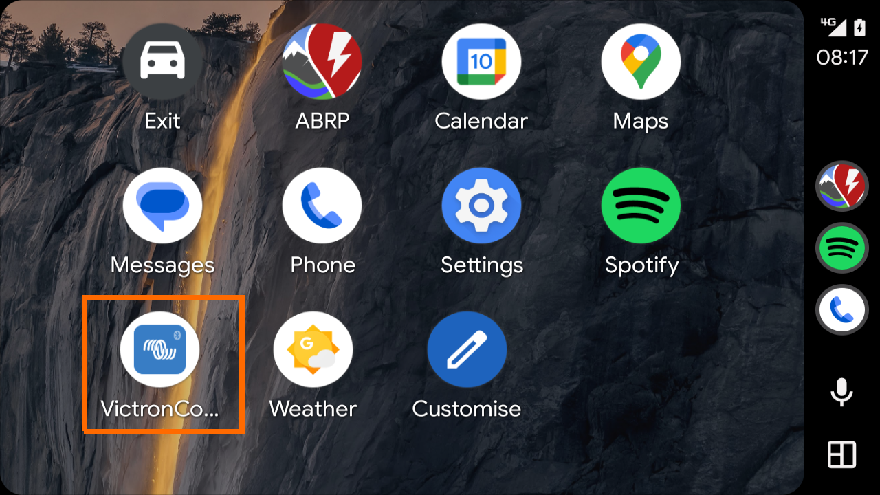

The VictronConnect shortcut will now appear on your app launcher screen.
  • Tap the shortcut to launch VictronConnect.

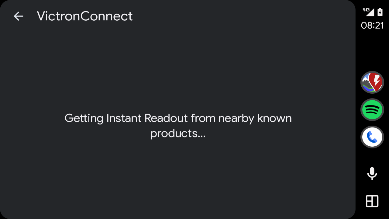

After launching VictronConnect from the app launcher screen, you may need to wait a short while for known products to be shown.

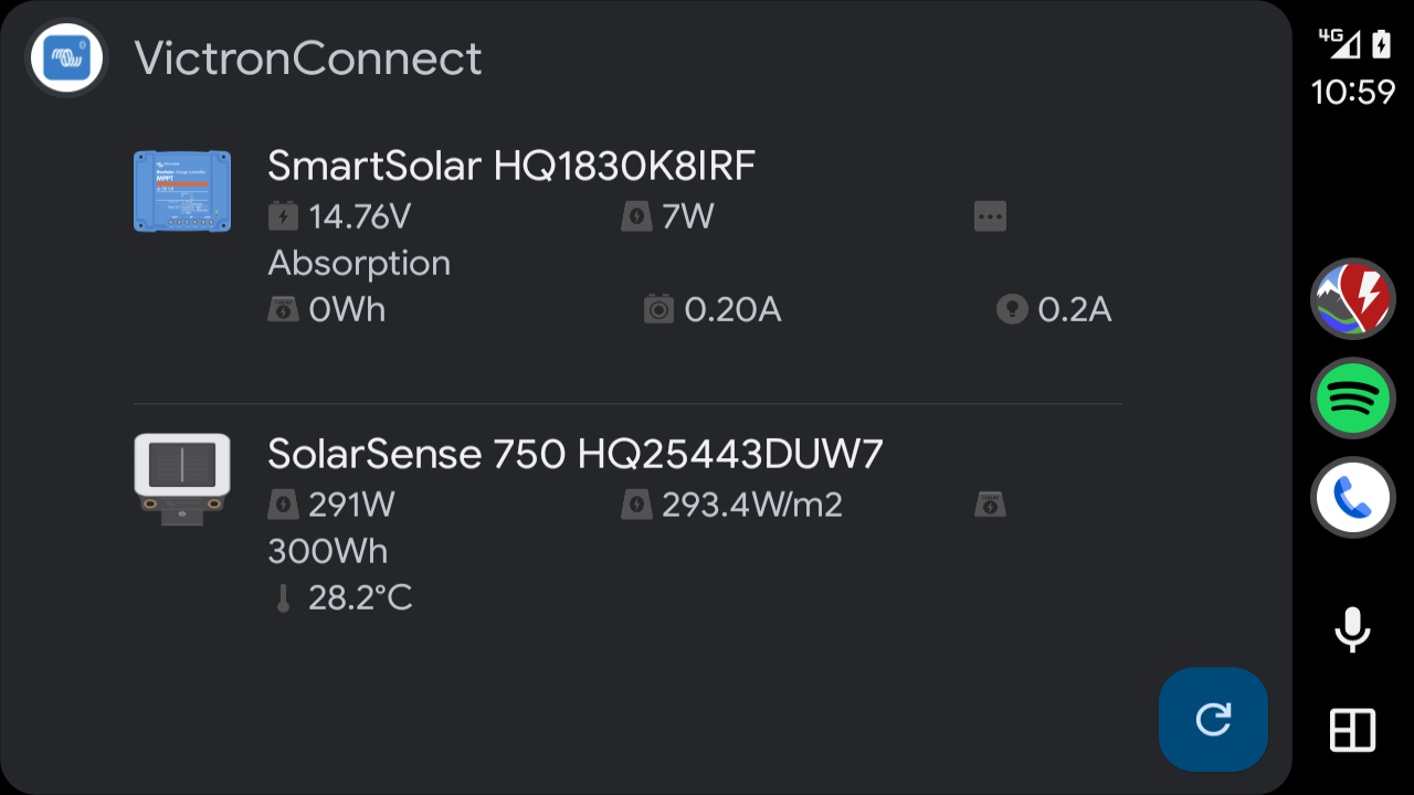

Any known products which are currently connected to your phone will be displayed.
Instant readout information for each connected device will be shown.

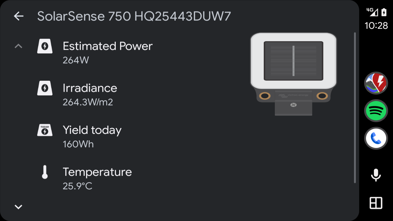

You can select a specific device to view only its data.
  • Tap a device in the list to view its details.
  • Drag the list up or down to scroll. You can also use the up/down arrows on the left.
