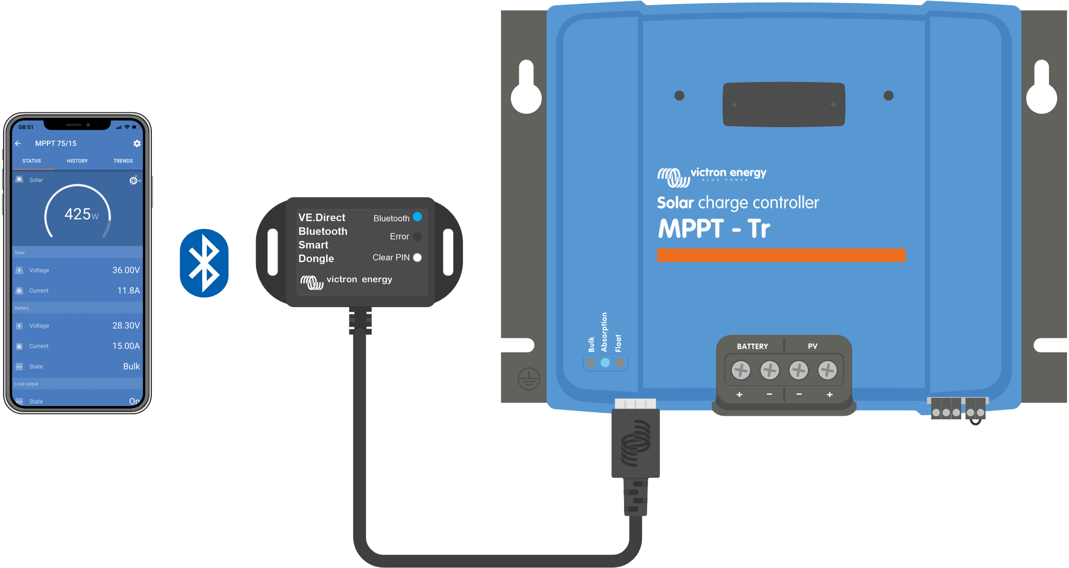

The app can connect to the solar charger in the following ways:
Via Bluetooth, using an optional VE.Direct Bluetooth Smart Dongle.
Via USB, using an optional VE.Direct USB interface.
Via internet or LAN, through the VRM portal, using an optional GX device or GlobalLink 520.
![]() Connection via Bluetooth. | ![]() Connection via USB. |
