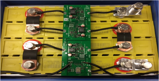

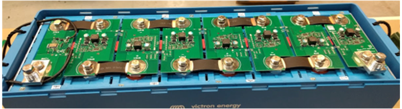

2. Lithium Battery Smart spare parts list
The table below lists the battery model, part number and what circuit board part number is used in that particular battery. The list also shows if the lid is screwed or glued onto the battery.
Battery part number | Battery description | Circuit board part number | Lid | Image | |
BAT512050610 | LiFePO4 Battery 12.8V/50Ah Smart | SBP210050000 | Glued up to HQ2132 Screwed from HQ2132 |
BAT512110610 | LiFePO4 Battery 12.8V/100Ah Smart | SBP210110020 | Glued up to HQ2115 Screwed from HQ2116 |
BAT512116610 | LiFePO4 Battery 12.8V/160Ah Smart | SBP210116020 | Glued up to HQ2119 Screwed from HQ2120 |
BAT512120610 | LiFePO4 Battery 12.8V/200Ah Smart | SBP210120020 | Glued up to HQ2111 Screwed from HQ2112 |
BAT512132410 | LiFePO4 Battery 12.8V/330Ah Smart | SBP210132120 | Screwed |
BAT524110610 | LiFePO4 Battery 25.6V/100Ah Smart | SBP220110020 | Screwed | ![]() | |

BAT512060410 | LiFePO4 Battery 12.8V/60Ah Smart (EOL) | SBP210060000 | Glued | ![]() | |
BAT512130410 | LiFePO4 Battery 12.8V/300Ah Smart (EOL) | SBP210130000 | Glued | ![]() | |
BAT524120410 | LiFePO4 battery 25.6V/200Ah Smart (EOL) | SBP210120120 | Glued | ![]() |
