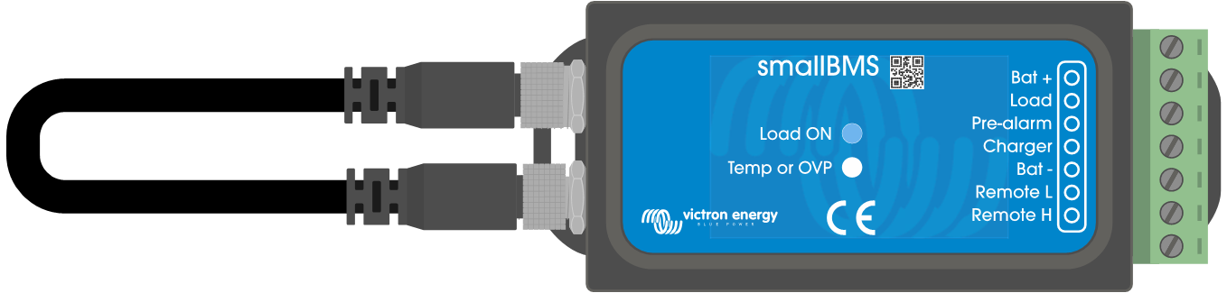

A way to rule out if a fault is originating from a faulty BMS or from a faulty battery is to check the BMS using one of the following BMS test procedures:
Single battery and BMS check:
Disconnect both BMS cables from the BMS.
Connect a single BMS extension cable between both BMS cable connectors. The BMS cable should be connected in a loop, as in the below diagram. The loop tricks the BMS in thinking that there is a battery connected without any alarms.
If the alarm is still active after the loop has been placed, the BMS is faulty.
If the BMS has cleared the alarm after the loop has been placed the battery is faulty and the BMS is not faulty.
