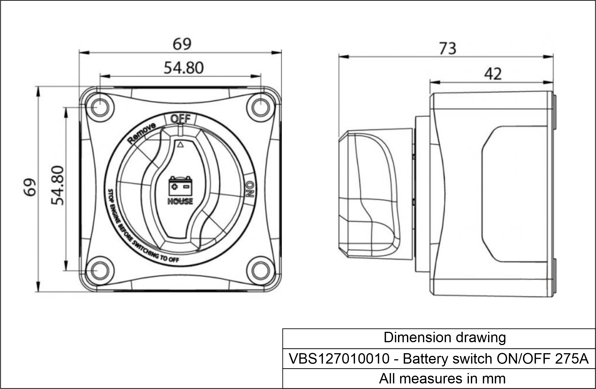

Dimensions (l x w x h)
2.71 x 2.71 x 2.87 inch (69 x 69 x 73 mm)

4.1. Enclosure dimensions
