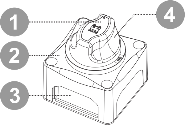

1.1. Features
  1. Interchangeable label stickers
  2. Glass fibre reinforced nylon enclosure
  3. Removable cable access window on all 4 sides
  4. Removable ergonomic knob

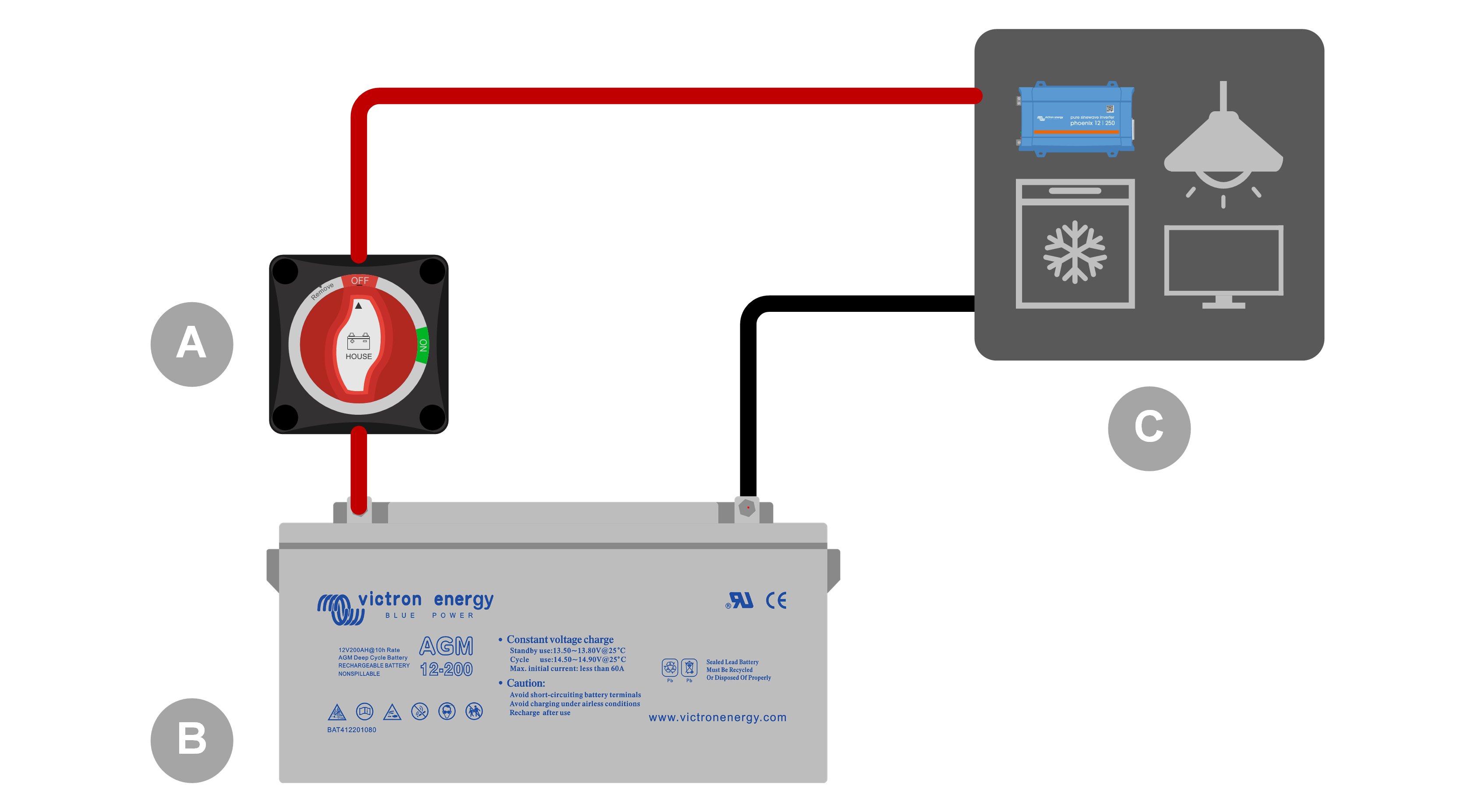

Battery Switch used to disconnect the house system from the house battery. Use to preserve battery charge, system maintenance or in an emergency.

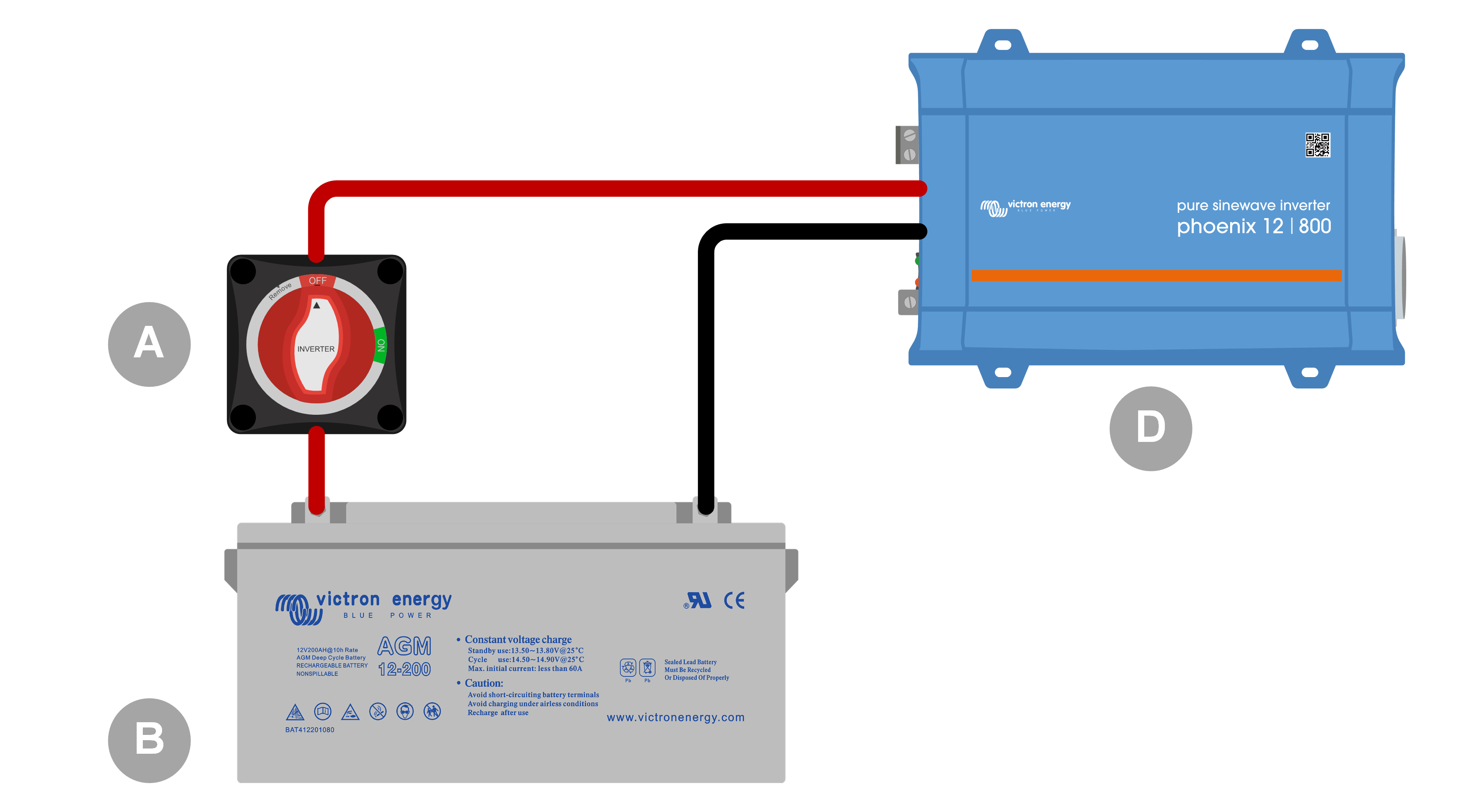

Battery Switch used to disconnect an inverter from the house battery. Use to preserve battery charge, system maintenance or in an emergency.

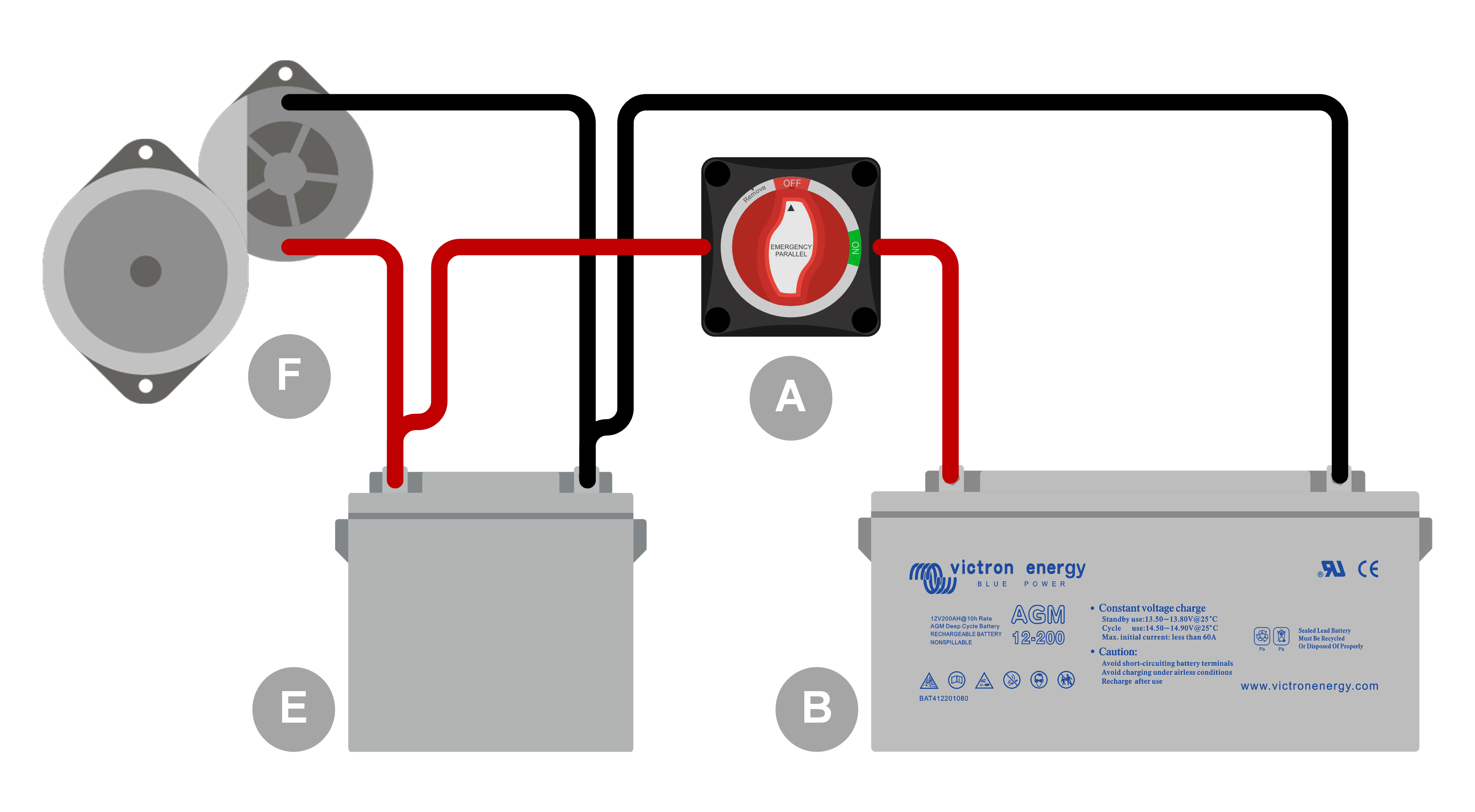

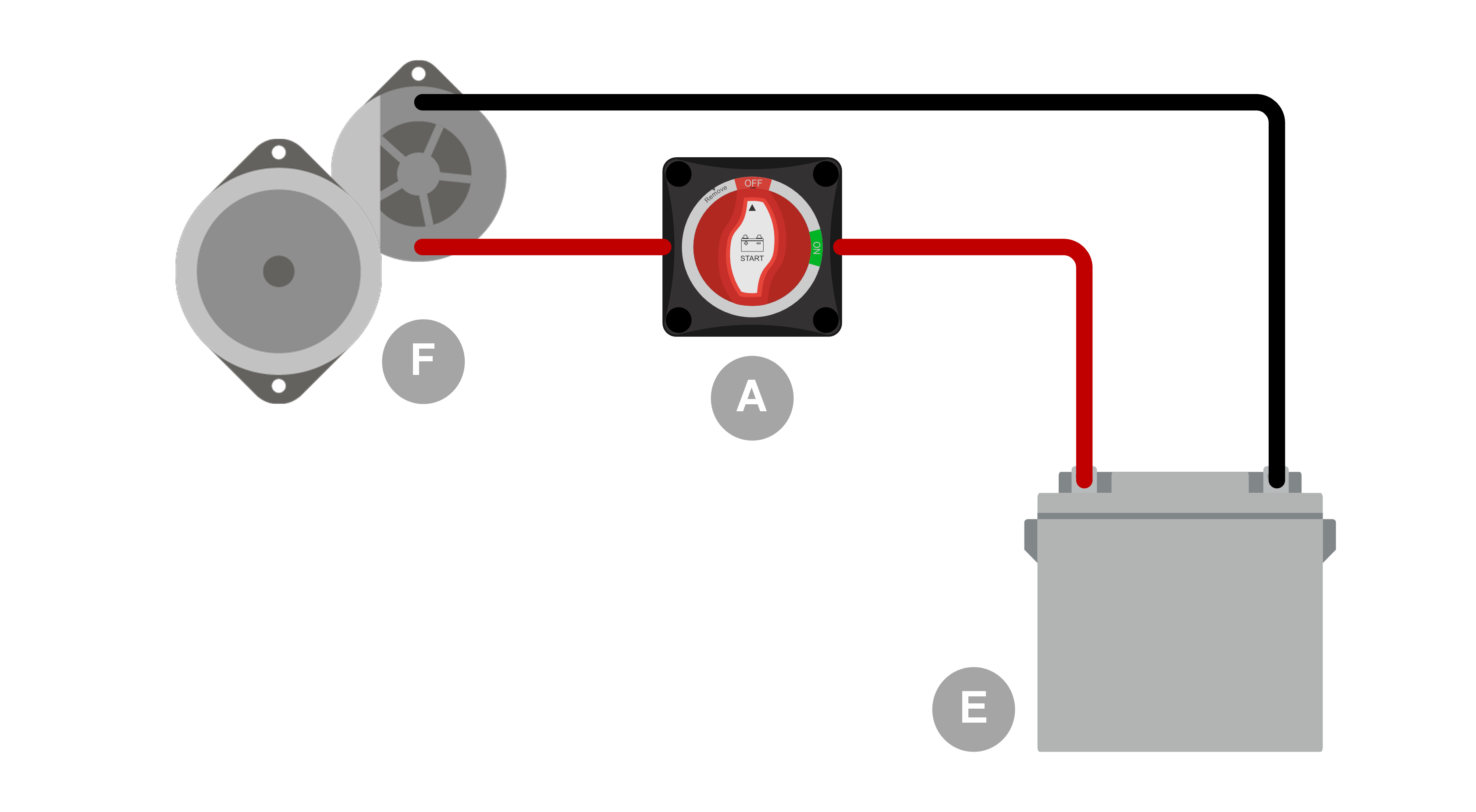

Battery Switch used to disconnect alternator from the starter battery. Use to preserve battery charge, system maintenance or in an emergency.
Battery Switch used to parallel connect the house battery to the starter battery. Use in case of an emergency, like a flat starter battery or a flat house battery.

A
Battery Switch
B
House battery
C
House system DC loads and/or chargers
D
Inverter
E
Starter battery
F
Engine and alternator
