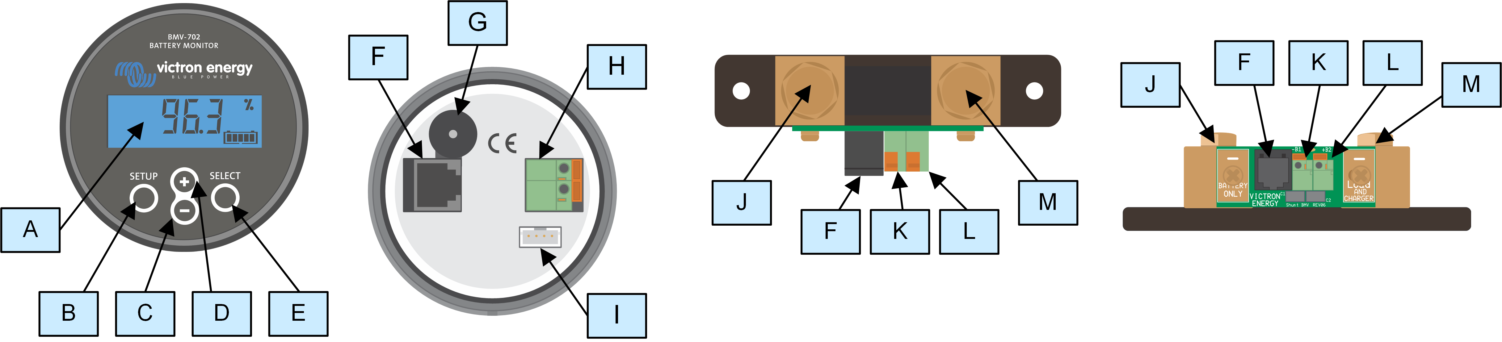

3.4. Connections overview
# | Name | Terminal type |
A | Display | - |
B | Setup button | - |
C | Down button | - |
D | Up button | - |
E | Select button | - |
F | RJ12 connector | RJ2 terminal |
G | Buzzer | - |
H | Programmable relay connector | Push connector |
I | VE.Direct connector | VE.Direct terminal |
J | Negative battery connection | M10 bolt |
K | Positive battery connection | Push connector |
L | Auxilary connection | Push connector |
M | Negative load connection | M10 bolt |
