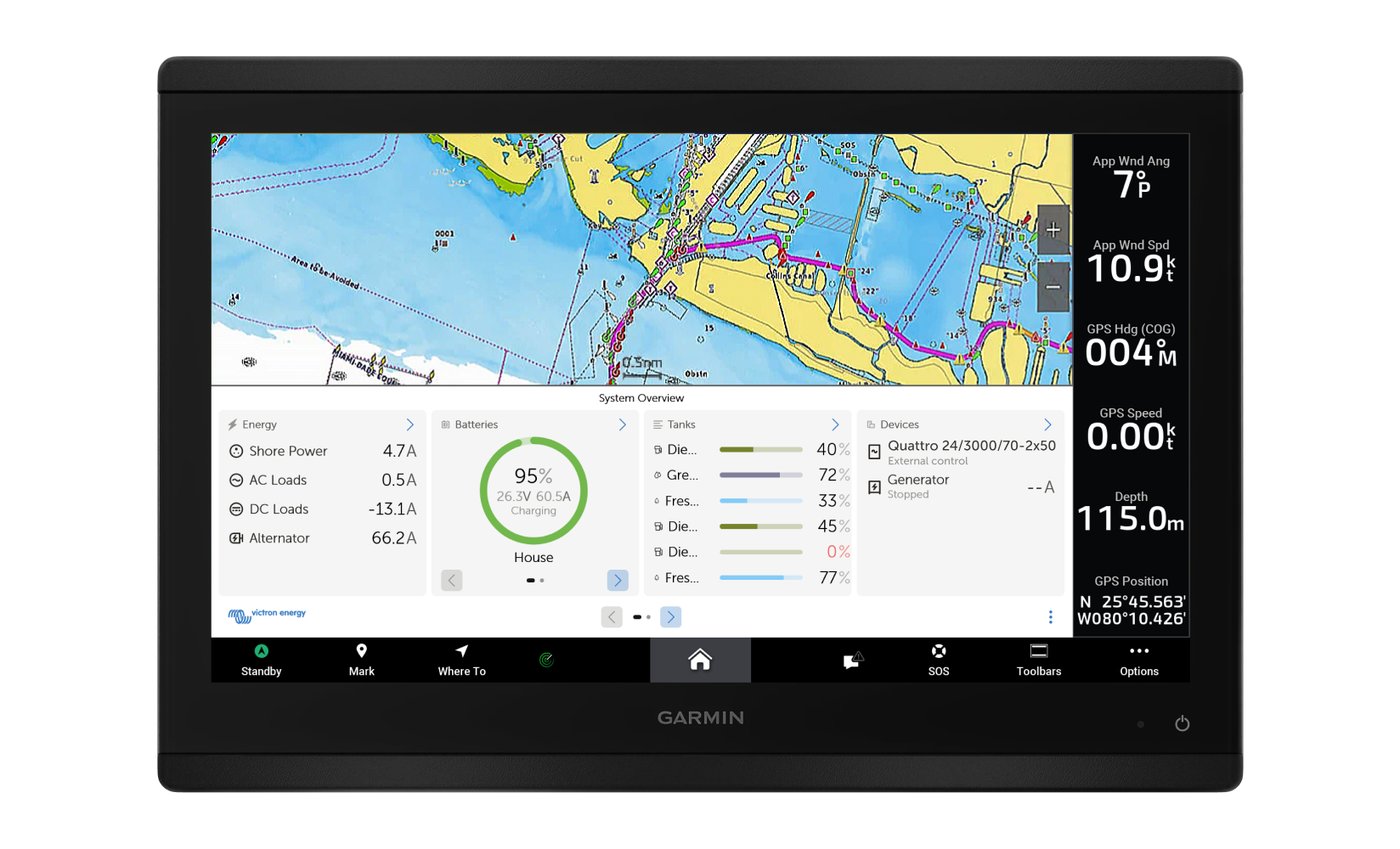

Illustration:
- Right bar: NMEA2000 data.
- Bottom: HTML5 App integration.

Q1: Can or must both Ethernet and and N2K connection be made between Victron GX and MFD?
Both can be made at the same time.
Ethernet is needed to get the MFD App, as explained above.
And an N2K connection is needed to get data to show in other fields on the MFD.
See annotated screenshot above for which is what.
