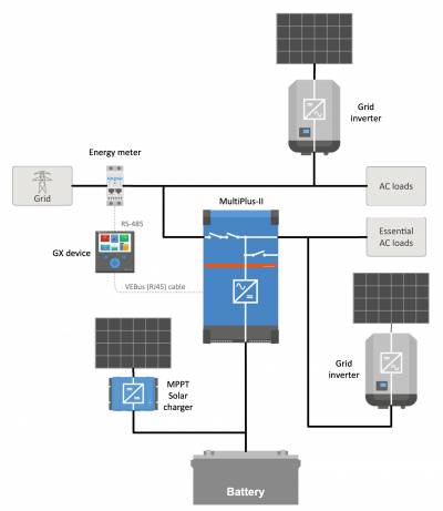

With and without grid-meter
ESS can be used both with an external grid-meter, or without one.
Where there is a grid-meter; either a full or partial grid-parallel system can be configured to run alongside.
Where there is no grid-meter; all loads are connected to AC-out. And where there is a PV Inverter present, that is also connected to AC out.

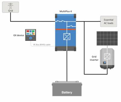

Backup system with Solar
All loads are wired on the AC output of the inverter/charger. The ESS mode is configured to 'Keep batteries charged'.
When using a grid-tie inverter, it is connected to the AC output as well.
When grid power is available the battery will be charged with power from both the grid and the PV. Loads are powered from PV when that power-source is available.
Feed-in is optional, and can be enabled or disabled depending on local regulations.

Grid Meter (optional)
For a full or partial grid-parallel installation an Energy Meter can be installed in the main distribution panel between the grid and the installation.
A grid meter is not required where there are no AC renewable-energy source(s) and also no AC load(s) present on the the input side of the Multi/Quattro system (i.e. where all such sources and loads are on the output side of the Multi/Quattro system).
If there is any AC renewable energy source or any AC load between the grid connection point and the input side of the Multi/Quattro system, incorrect results will be calculated and recorded by the GX unless a grid meter is installed and enabled.
In particular, without a grid meter:
  • When renewable energy is being provided on the input side, the grid value will be wrong (too low/negative); and
  • The AC Load value shown will be too low (and will show zero where there is a surplus of renewable energy).
Both issues are resolved by installing a grid meter.
Click here for more information about the configuration of grid meters.
