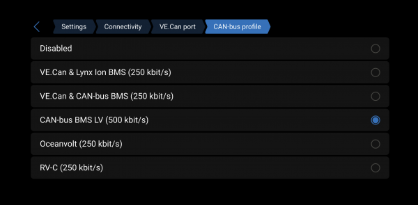

Manual Configuration
On the GX device,
  • If your GX device has a BMS-Can port, the battery should be connected to this.
  • If you connect the BMS to the VE.Can port you will need to adjust the port speed. Select the CAN-bus BMS (500 kbit/s) CAN-profile in the GX device. Menu path: Settings → Services → VE.CAN port.
After properly wiring and setting the correct CAN-bus speed, the Pylontech will be visible as a battery in the device list. If you have multiple batteries a single entry will show up, which represents all batteries:
