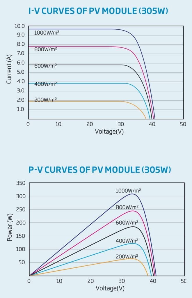

Have a look at these I-V (Current vs Voltage) and P-V (Power vs Voltage) charts for a 305W solar panel from Trina Solar.
You can see in the P-V curve that as the solar radiation decreases from 1000W/m2 to 200W/m2, the power drops proportionally – from 300W to 60W. The Voltage output range remains nearly constant, however with the Maximum Power Point (MPP) voltage at 33V, and the maximum open circuit voltage only dropping from 43V to 38V.
If the voltage is pretty constant regardless of the intensity of the light, then the Current must be changing. (Note that these tests were all run at 25°C)
You can see this clearly in the I-V curve, where the output current has dropped from 9.8 A at 1000W/m2 to 2 A at 200W/m2.

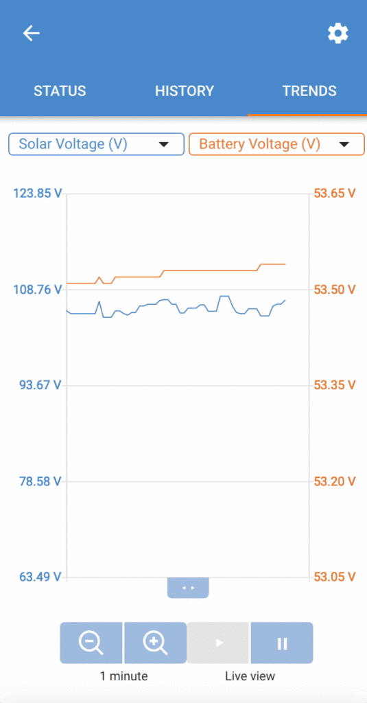

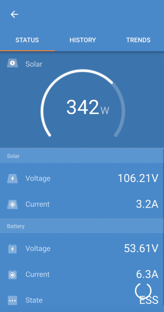

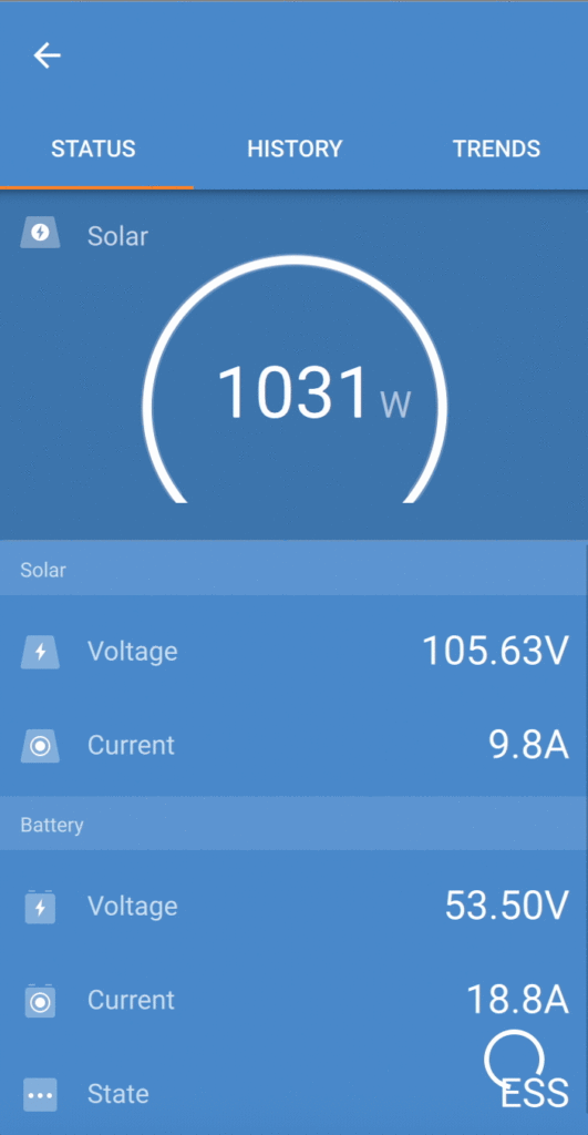

Take a look at GIFs below displaying information from a Victron MPPT – as seen on an iPhone via the free-to-use app VictronConnect – and you will see the relationship between Solar Voltage, and the Battery Voltage. These images are dynamic when clicked:
Now here is the same solar array a short time later when the sun has come out. Notice how the power has increased from ~350W to ~1000W, but the PV Solar Voltage is the same!

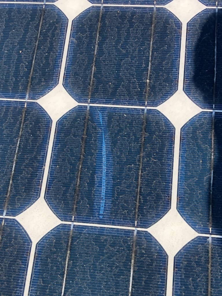

Close inspection can reveal damage, or delamination.
The second image shows a problem where two columns of cells are hotter than those around them. A closer inspection of the cells revealed some cracking and delamination. Depending on the severity, and the cause, it could be panel warranty issue.
