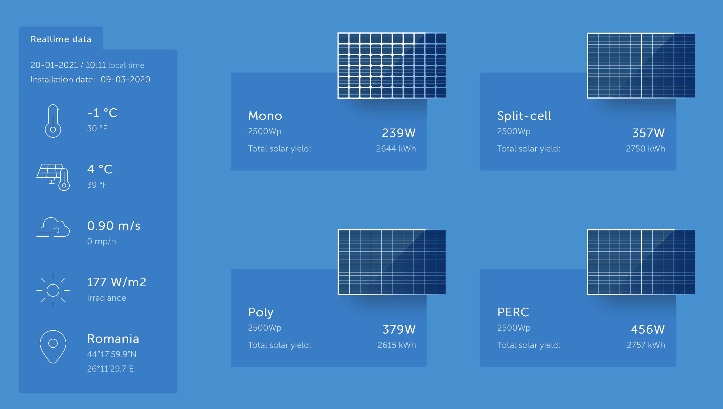

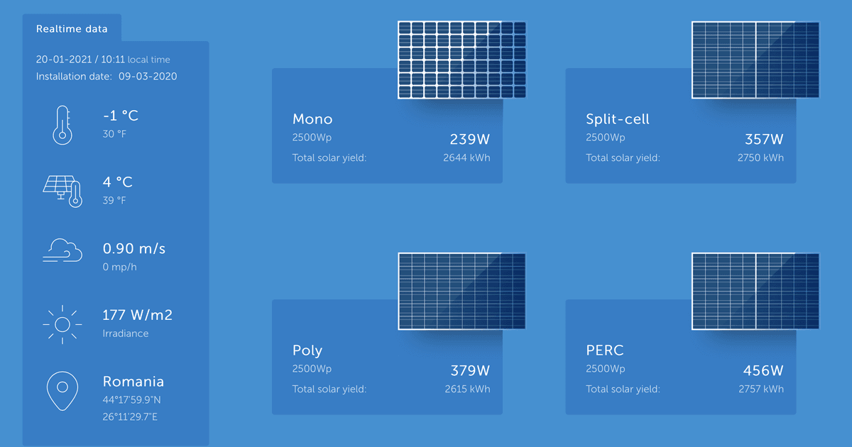

By way of an example here’s a snap-shot comparison for one moment in time: When the monos were producing 1430 Watts, this was the live comparison:
What makes the experiment interesting is that different panels offer their best performance under different weather conditions. Local ‘live’ meteorological conditions are reported alongside the panel readings.
At the time of writing, in the Northern Hemisphere, we are coming into our winter. Clear cold winter days of brilliant sunshine are great for harvesting solar energy – so let’s see what happens!
