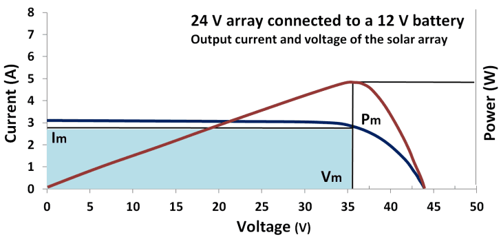

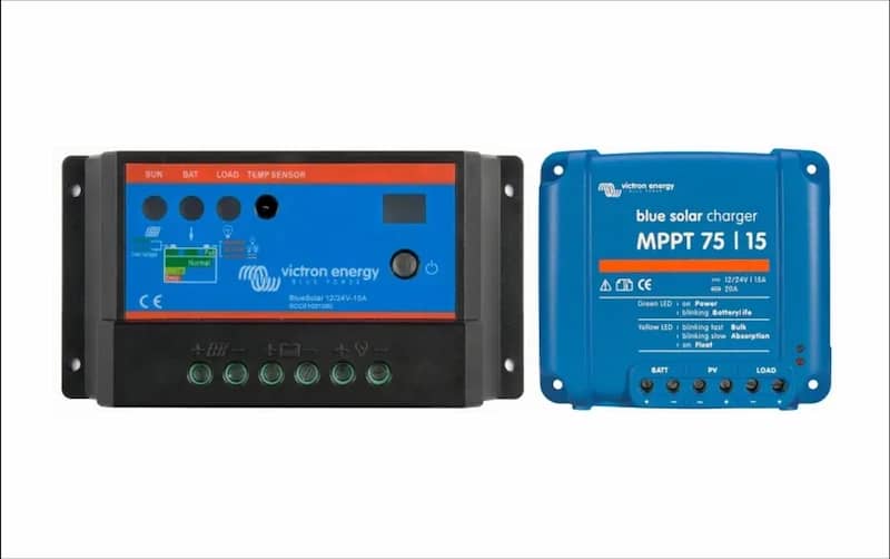

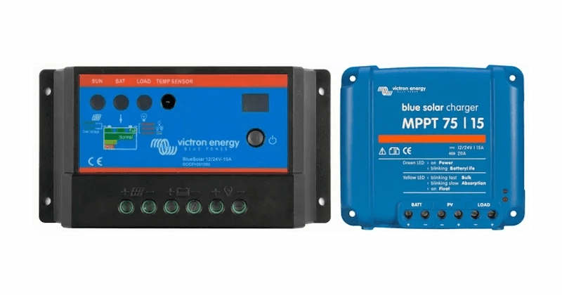

The PWM controller is in essence a switch that connects a solar array to a battery. The result is that the voltage of the array will be pulled down to near that of the battery.

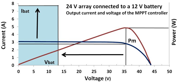

The MPPT controller is more sophisticated (and more expensive): it will adjust its input voltage to harvest the maximum power from the solar array and then transform this power to supply the varying voltage requirement, of the battery plus load. Thus, it essentially decouples the array and battery voltages so that there can be, for example, a 12 volt battery on one side of the MPPT charge controller and a large number of cells wired in series to produce 36 volts on the other.

The MPPT controller will harvest more power from the solar array. The performance advantage is substantial (10% to 40%) when the solar cell temperature is low (below 45°C), or very high (above 75°C), or when irradiance is very low.
At high temperature or low irradiance the output voltage of the array will drop dramatically. More cells must then be connected in series to make sure that the output voltage of the array exceeds battery voltage by a comfortable margin.
