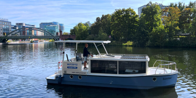

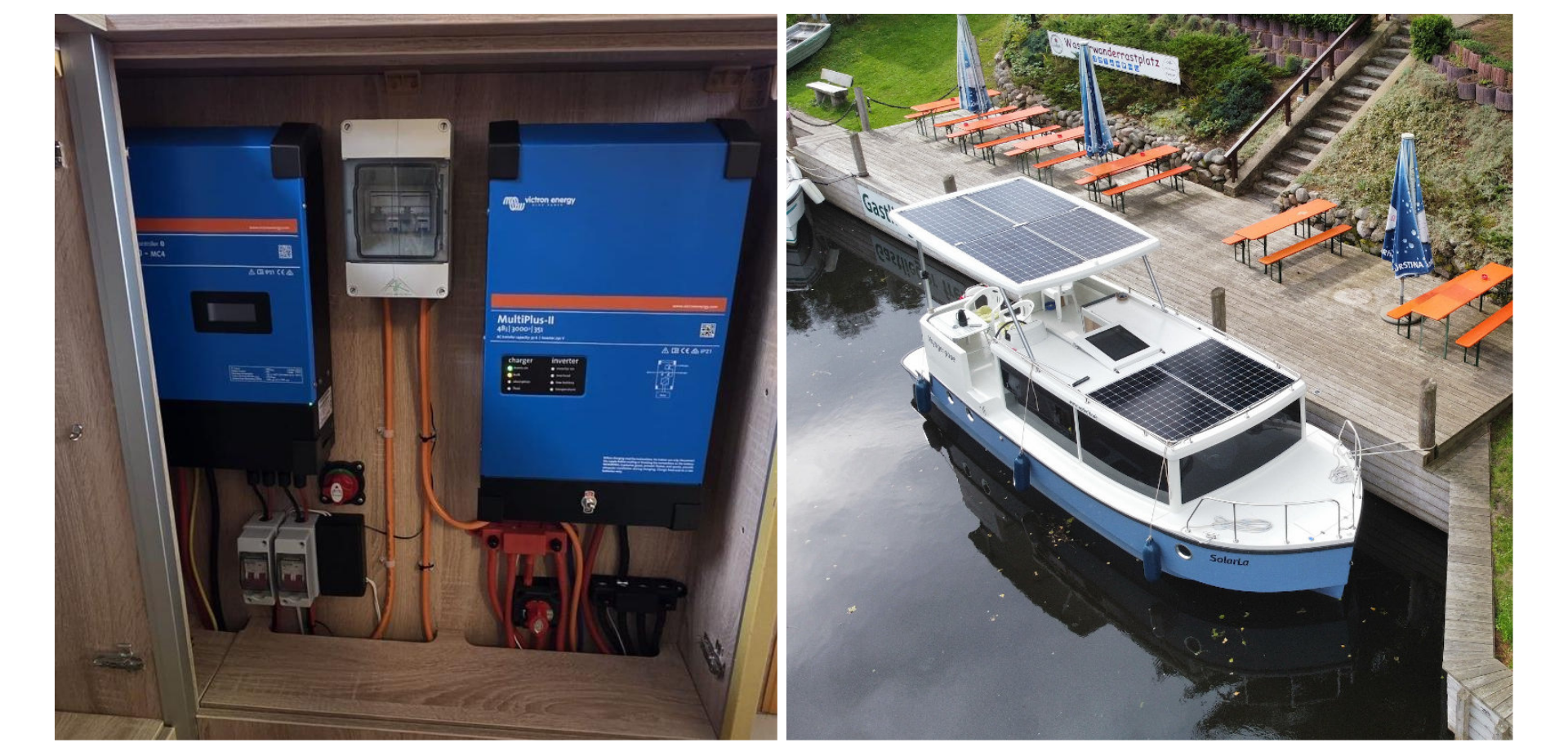

Based in Rechlin/Müritz, Germany, Woterfitz designs and builds 9-metre electric motor boats at its own small shipyard. The vessels, known as the Voyager 900e, are offered as charter boats, as well as, upon special request from previous charter customers, custom-built boats for sale.
Since their launch in 2023, the charter fleet has already grown to around 20 boats operating throughout the summer season on Lake Müritz, allowing customers to enjoy the Mecklenburg Lake District, from Lake Müritz itself to the surrounding canals, which lead all the way to Berlin and beyond. Each boat in the fleet is fully self-sufficient, with only an optional shore power connection for convenience.
Victron Energy system on each boat includes:
The result is a vessel with remarkable range: in late September 2025, for example, Bernd covered 102km through central Berlin over 2.5 days, using only around 40% of the battery’s state of charge.

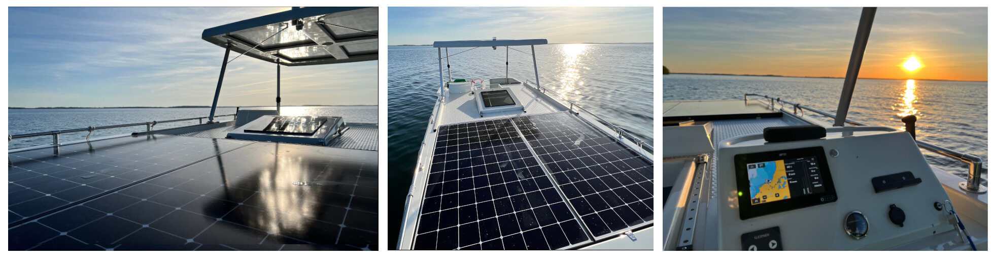

The Voyager 900e is driven by an ePropulsion electric motor. At a speed of 8 km/h, the motor draws around 1.5kW. On a sunny day during the summer season, the 2.4kW solar array can comfortably power the motor as well as charging the battery bank.

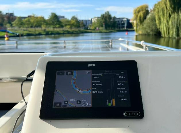

When Bernd was cruising through the canals at 6.3 km/h on a September afternoon, for instance, the display showed 820W of motor power being drawn, with 838W coming in from the PV array.
The challenge and the solution
With such an energy-efficient electric boat, an unexpected challenge emerged. When the sun is out, the 2.4kW of solar panels can propel the boat and charge the battery at the same time, so the input exceeds the output, resulting in an infinite ‘time to go’ being displayed. Even though technically correct, this is not particularly useful for a captain planning a longer journey through the canals.
To tackle this challenge, Bernd and the Woterfitz team built a custom software solution running on the Cerbo GX. The Cerbo GX sits at the centre of the integration, connected to a custom mainboard that handles all the wiring between the cockpit and the rest of the vessel’s systems. On top of VenusOS, the team runs NGINX and PHP directly on the Cerbo to serve a bespoke web-based Human-Machine Interface (HMI), which is displayed on a Raymarine device in the cockpit
The HMI pulls live data via MQTT and presents it in a way that is immediately relevant for the captain, displaying:
