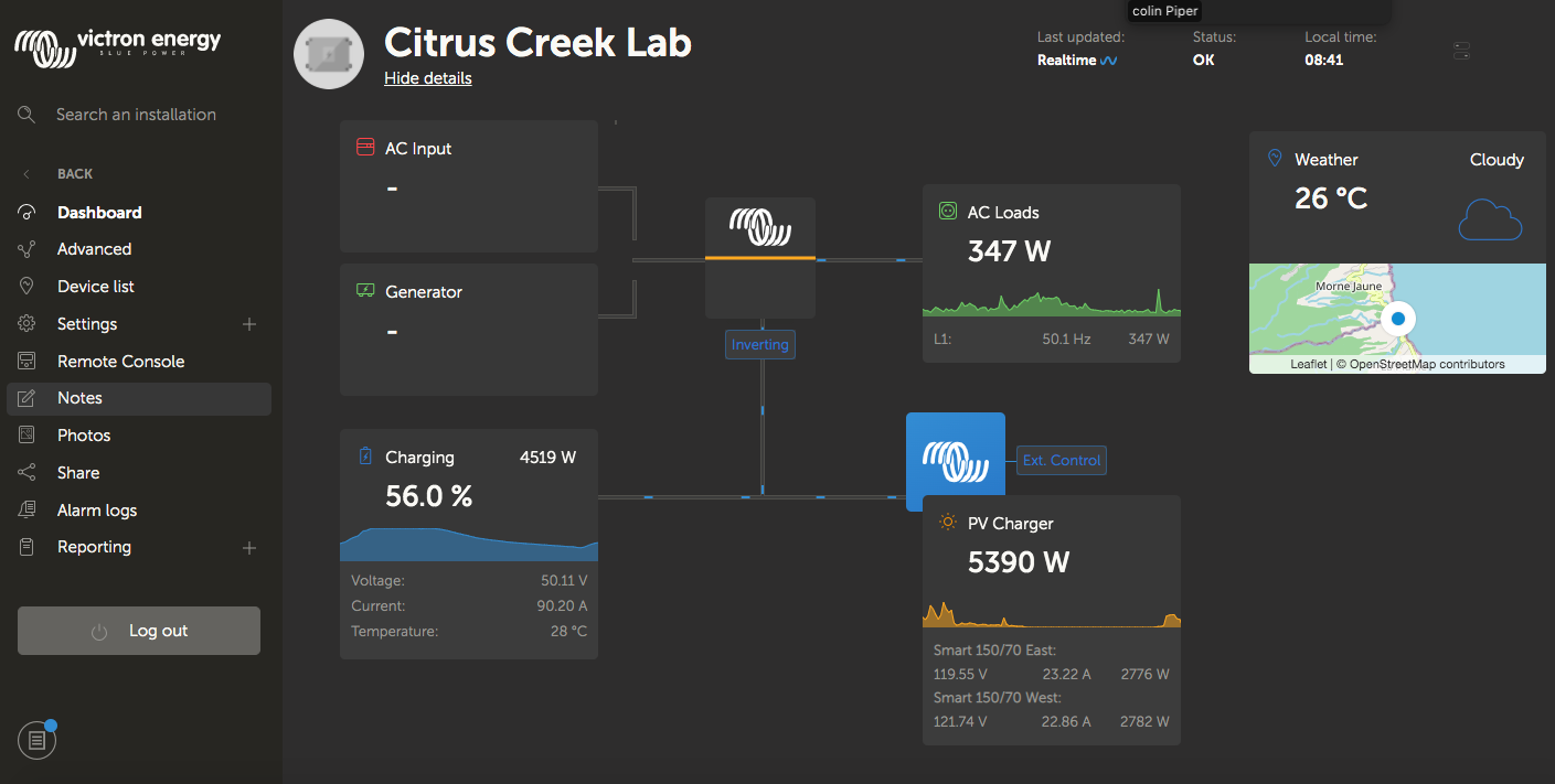

Sustainable Earth solar lab is located within Citrus Creek Plantation property . This is where Sustainable Earth stores their inventory, and tests solar products and is also where Sustainable Earth Inc prepares, pre-wires and mounts the solar systems which are to be installed by their island customers.

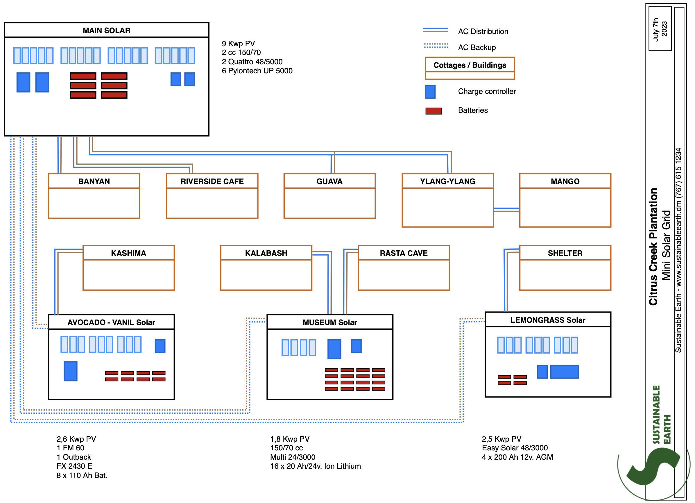

The Citrus Creek Plantation solar system is designed as a Mini grid – but with a grid connection: Three solar installations radiate from Citrus Creek Plantation’s main hub, which is connected to the Grid using Grid-Assist with Virtual Switch settings on VEConfigure.
  • The hub has a 9 kWp solar array feeding 2 x SmartSolar MPPT 150/70 solar charge controllers. AC power is provided by two Quattro 48/5000 units working in parallel. Energy is stored  in 6 x UP5000 Pylontech Lithium batteries have a capacity of almost 30kWh. Being an island, wind is frequently available as a power source and the system includes a 3kW Wind turbine.
  • The three satellite power systems are typically each provided with around 2kWp solar arrays. AC socket outlets are powered by 3 kVA inverter/chargers – either the MultiPlus or, for easy installation, an EasySolar II unit which has a solar charge controller built-in. Energy storage of between 8 and 10kWh is provided by AGM batteries – and using Lithium batteries in the most recent development. Whenever these satellite power systems for the accommodation or attractions need a battery top up – this is provided by the main hub.
