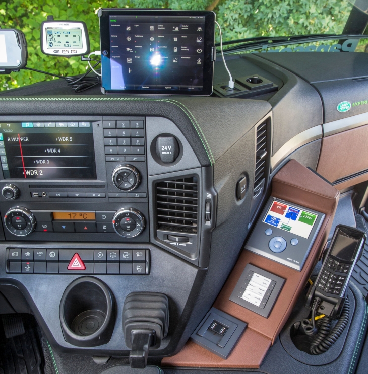

Inside the driver’s cab with a Color Control GX for system monitoring
