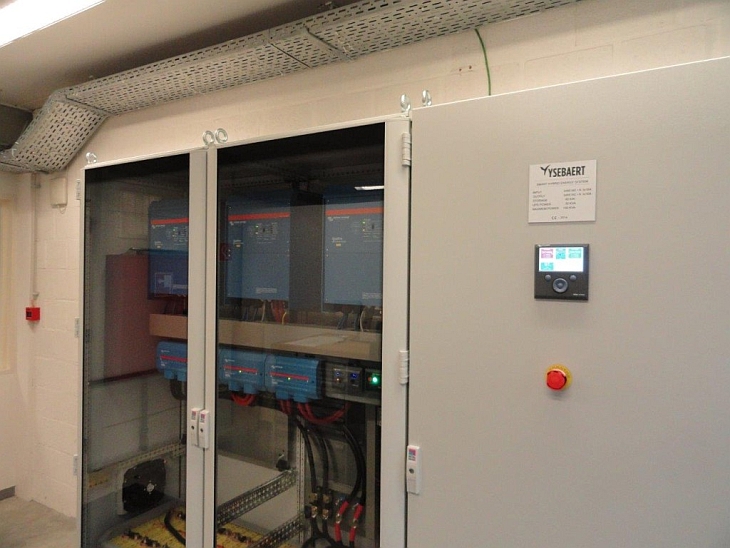

The company Ysebaert, one of our distributors in Belgium, recently installed a Hybrid Back-up System at their company. This system supplies them with electricity during power outages, currently a real problem in Belgium. The system also buffers their solar energy, which they would otherwise feed back into the grid.

Electrical properties
Ysebaert no longer sufers from power outages now they have a Hybrid Back-up System. The system has the following characteristics:
  • Input : 3×400 VAC + N – 3 x 100A
  • Output : 3×400 VAC + N – 3 x 143A
  • Battery storage : 40kW Lithium Power Pack
  • UPS power : 30KVA
  • Maximum power : 100KVA
System components
Three Quattro inverter/chargers 48/10000/140-100-100 and a Lithium Power Pack of 40kW form the heart of this unique system. The complete installation also has a Lynx DC distribution system and a bypass unit with coupling to the existing electrical installation and solar energy system.
The entire installation dat can be seen with the built-in Color Control Display and via the VRM website (Victron Energy Remote Management). Status messages are sent by e-mail via the VRM website and a mobile phone module ensures the necessary SMS messages in case of a power failure.

The system has a threefold set-up:
  • During a power outage there is a converter capacity of 30KVA available and a battery storage of 40kW. This allows Ysebaert to shut down their CNC machines in a controlled manner and continue working for 12 hours.
  • The solar energy that was not consumed and fed back into the grid can now be buffered in the Lithium Power Pack and used at night, during a power outage or to better handle peaks in demand.
  • The maximum peak current is set by the distribution grid manager for one year in the distribution and transport rates. Avoiding such current peaks can generate significant long-term savings. The Smart Hybrid Energy System can offset these current peaks by adding supply via the battery and the converters, when a certain power is met which is set in advance.
