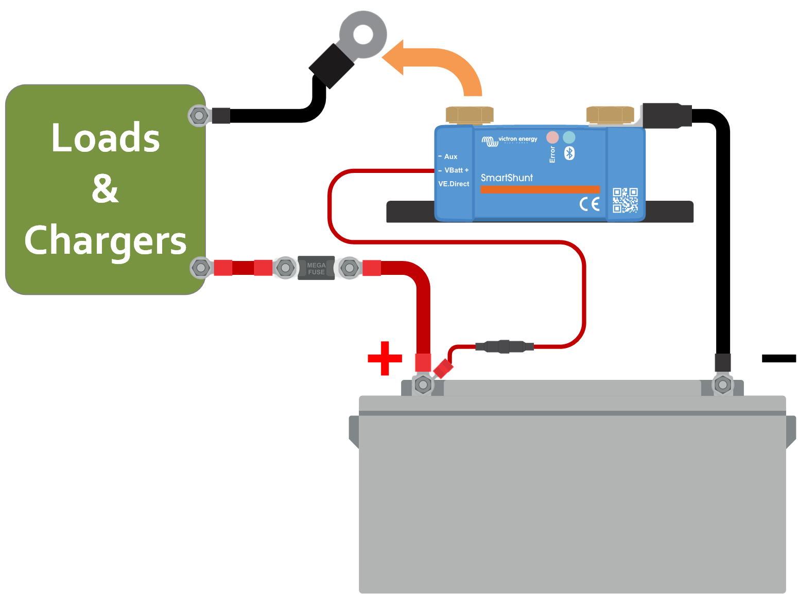

7.4.4. Current measurement direction
The current-measurement direction setting allows you to choose on which side of the shunt the battery (or battery bank) is connected. This ensures that current-flow calculations use the correct polarity.
Normal mode: the battery negative is connected to the shunt’s battery terminal.
Reversed mode: the battery negative is connected to the shunt’s load terminal.
VictronConnect app setting | Default setting | Modes |
Current measurement direction | Normal | Normal Reversed |

Reverse shunt direction (setting 76) | off | off on |
Notice
This setting was introduced in firmware version v4.19 and is not supported in earlier versions.
This setting is protected by the "Settings Lock" feature (so if the settings are locked, this setting cannot be changed).
