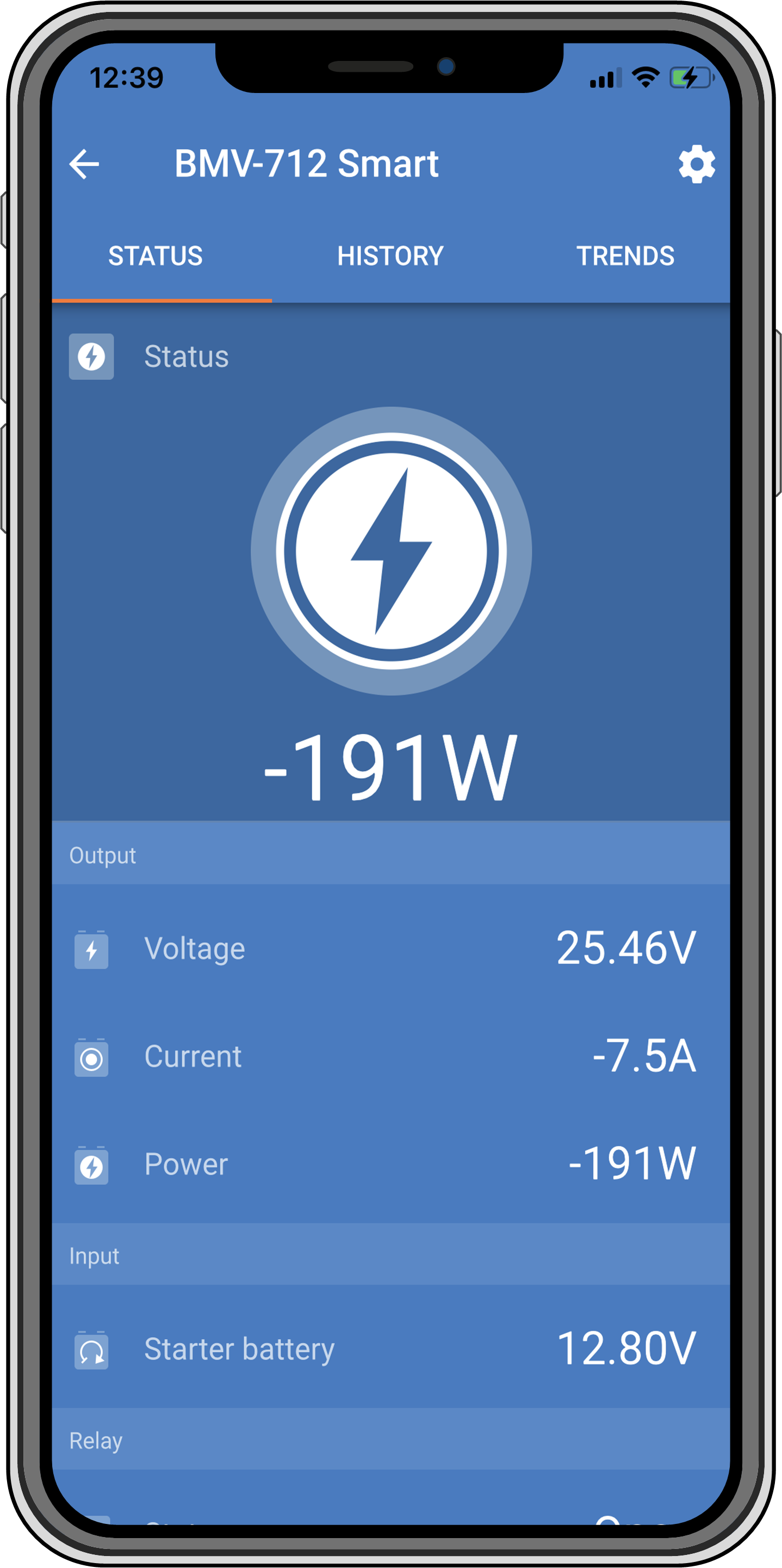

The the VictronConnect app battery monitor status screen, displays an overview of the most important parameters. These are:
State of charge
Battery voltage
Battery current
Power
Aux input reading (starter battery, midpoint or temperature)

5.8. Operation as a DC meter
The battery monitor can be set up as a DC energy meter. It is used to measure DC production or consumption of a specific device in a system, like for example an alternator, wind turbine or hydro generator. Or similarly, the consumption of a specific circuit or load in a DC system.
When in DC monitor mode, the voltage, current and power is displayed.
VictronConnect app status screen of a battery monitor running in DC monitor mode.
