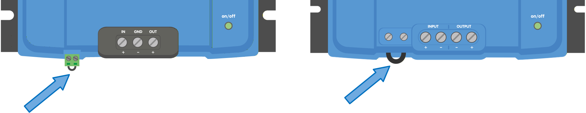

7.2.1. Remote terminal is missing, disconnected or external control is active
The charger only operates when its remote on/off input is active. Most commonly, this is done with the remote connector with a wire link between the L and H terminals.
Remote on/off connector with wire loop
There are two more ways to activate the remote on/off input; see Remote on/off wiring for the wiring details:
  • ON when the L terminal is pulled to battery minus or ground (ON switch level < 5V)
  • ON when the H terminal is pulled to battery plus (ON switch level > 3V)
General remote on/off terminal check
  1. Check that the charger is not being turned off remotely by an external control (see the note below).
  2. Check that the remote terminal connector has been plugged in all the way.
  3. Check that the wire link, or the remote control wires, are making good electrical contact.
