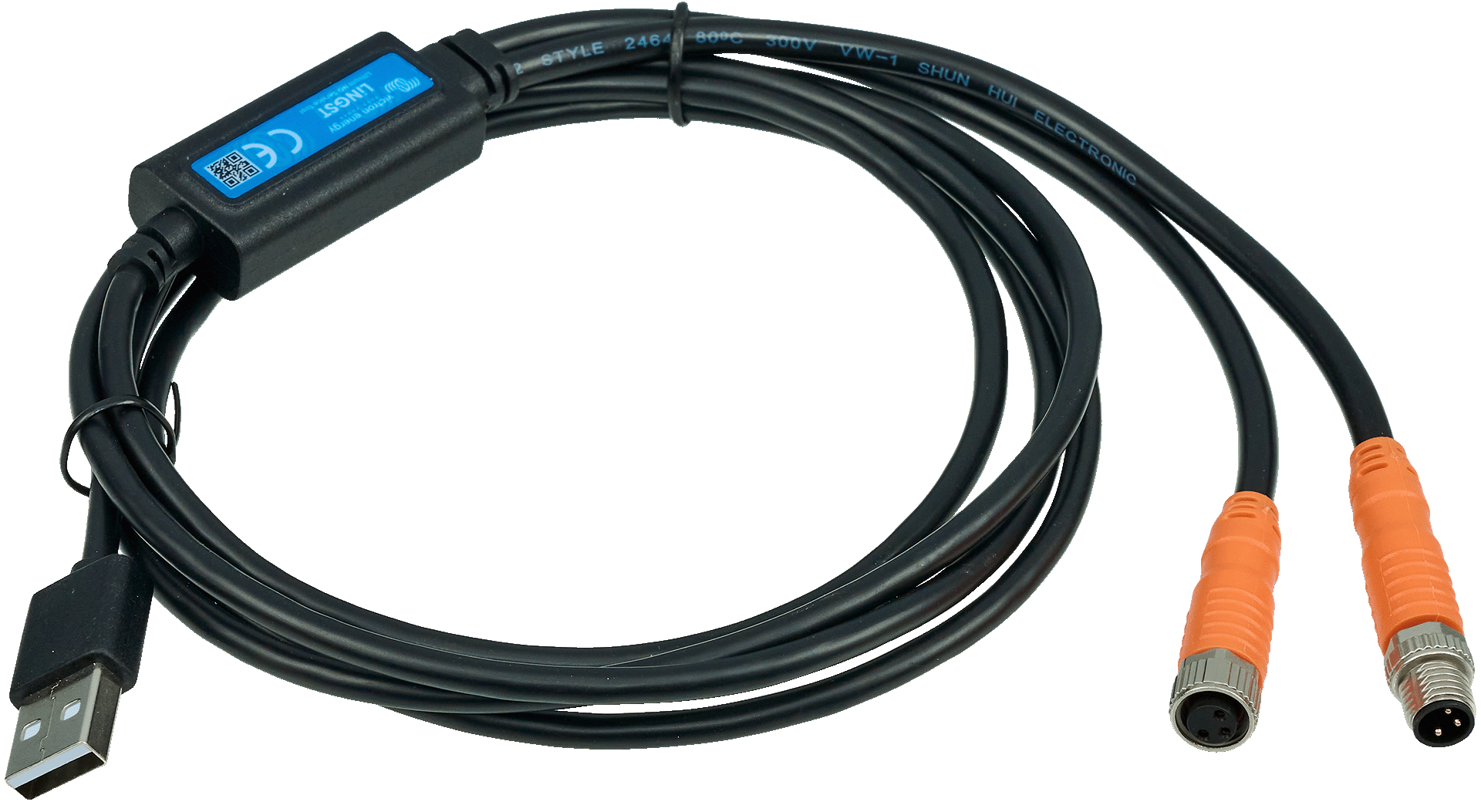

The Lithium NG Service Tool (LiNGST) provides a direct wired connection between a Windows PC and the M8 service connector on Lithium NG batteries and the BMS NG range.
It is intended for commissioning, debugging, and in-depth system analysis during installation or support work, especially in cases where wireless access is not available. The scope of this service tool is to support technical assistance during on-site activities.

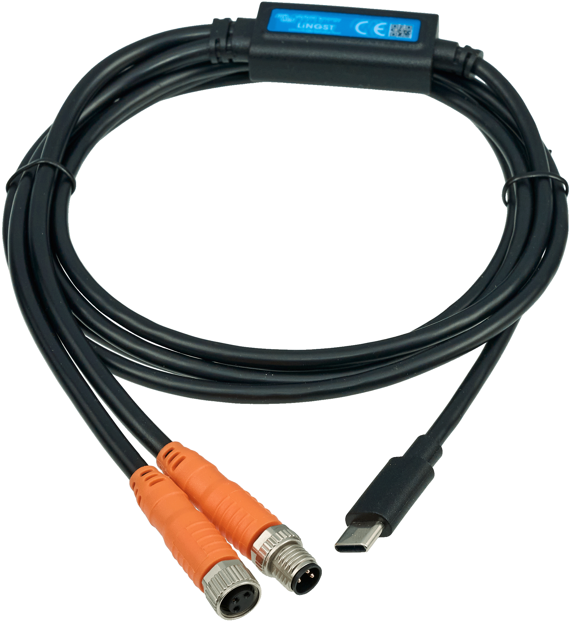

2.1.2. Product variants
The Lithium NG Service Tool is available in two models:

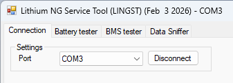

Windows PC
Lithium NG Service Tool application for Windows (download from the Software downloads section on the Victron Energy website).
2.1.5. Initial connection
