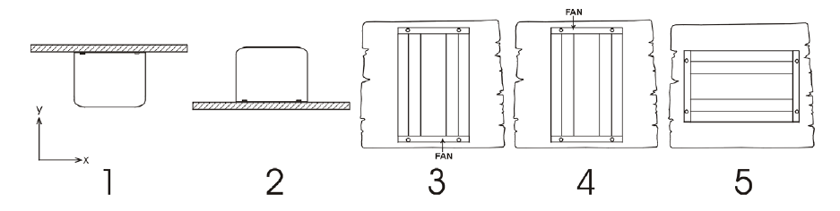

3.1.2. Mounting
Mount the inverter against a sturdy wall or horizontally on a suitable ground surface.
Mount the inverter with four screws vertically up- or downwards or horizontally up- or downwards. See the table and figure below for the best mounting options.
Mounting directions.
# | Mounting type | Recommended? | IP rating | Notes |
1 | Ceiling mounting (inverted). | No | n/a | |
2 | Base mounting | Yes | IP21 | |
3 | Vertical wall mounting, fan at the bottom. | Yes | IP20 | Be aware that potentially small objects or dust can fall into the inverter through the ventilation openings at the top. |
4 | Vertical mounting, fan on top. | No | n/a | |
5 | Horizontal wall mounting. | Yes | IP20 |
