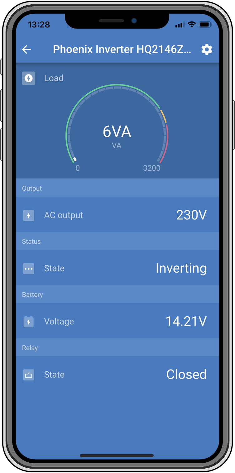

5.4. Monitoring via the VictronConnect app
The VictronConnect app can be used to monitor the inverter.
VictronConnect app.
For information on how to connect see the The VictronConnect app chapter and/or the VictronConnect manual which can be found on the VictronConnect app information page.
The VictronConnect app will display the following information:
  • Inverter load in VA.
  • AC output voltage.
  • Battery voltage.
  • Operational state.
  • Programmable relay state.
  • Warning or alarm messages *.
*) Please note that the app is not active in the background. This means that the app will not send alarms or warnings to your phone unless the app is active in the foreground.

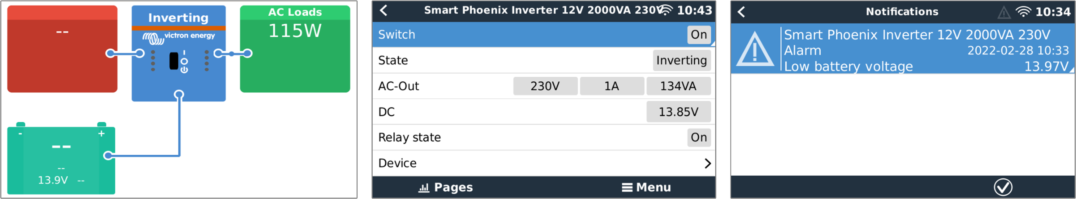

5.5. Monitoring via a GX device, GlobalLink and the VRM portal
The inverter can be connected to a GX device, like a Cerbo GX or an Ekrano GX. When connected the GX device will display the inverter on the system overview screen and the device list. The GX device will also display a message in case of an inverter warning or alarm.
Example of GX screens from left to right: system screen, inverter device screen and an alarm message.
If the GX device is connected to the internet, the inverter can be remotely monitored via the VRM portal. For more information on the VRM portal, see the VRM - Remote monitoring information page.
