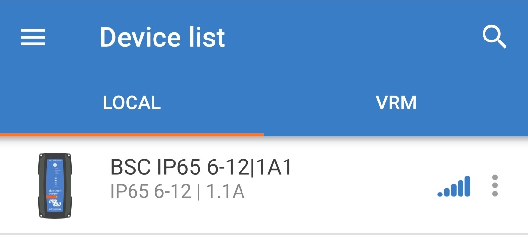

- Connect the Blue Smart IP65 Charger AC power cable to a mains power outlet; after a short delay the 12V (green) and the 6V (yellow) LEDs will begin blink slowly (standby mode), until the charger automatically determines the battery voltage or the battery voltage is manually set.
- Open the VictronConnect app and locate the Blue Smart IP65 Charger in the Device list Local page, under Other devices. - In case the Blue Smart IP65 Charger does not automatically appear, ensure that the mobile phone or tablet has Bluetooth enabled and is within close range, then perform a manual scan for devices by selecting the Scan button (round orange button with circular arrow) in the bottom right corner.
- Select the Blue Smart IP65 Charger from the Device list Local page, under Other devices.
- VictronConnect will attempt to establish a Bluetooth connection with the Blue Smart IP65 Charger and display the connection progress in the Connecting pop-up dialog box.
- When attempting to establish a Bluetooth connection with a new/unpaired device, the Bluetooth pairing request pop-up dialog box will appear after a short delay; enter the default PIN code stated on a label located on the back of the charger (or try 000000 if there is no default PIN code label), then select Pair.

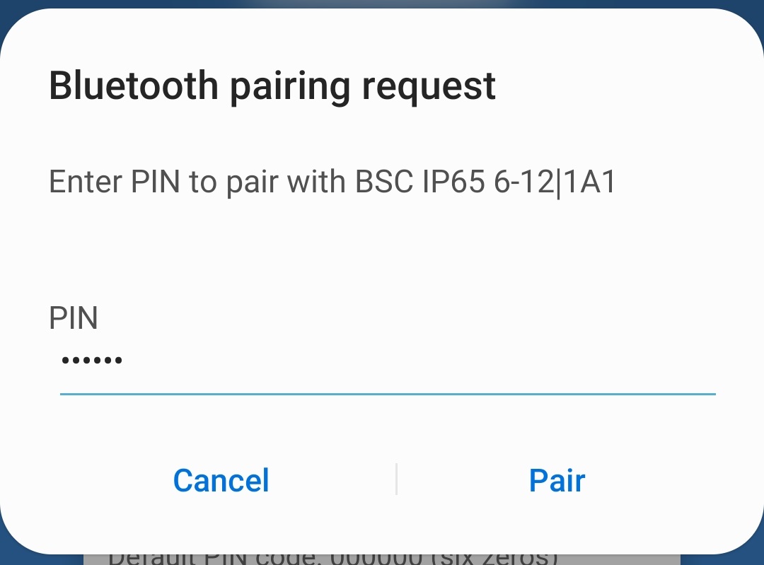

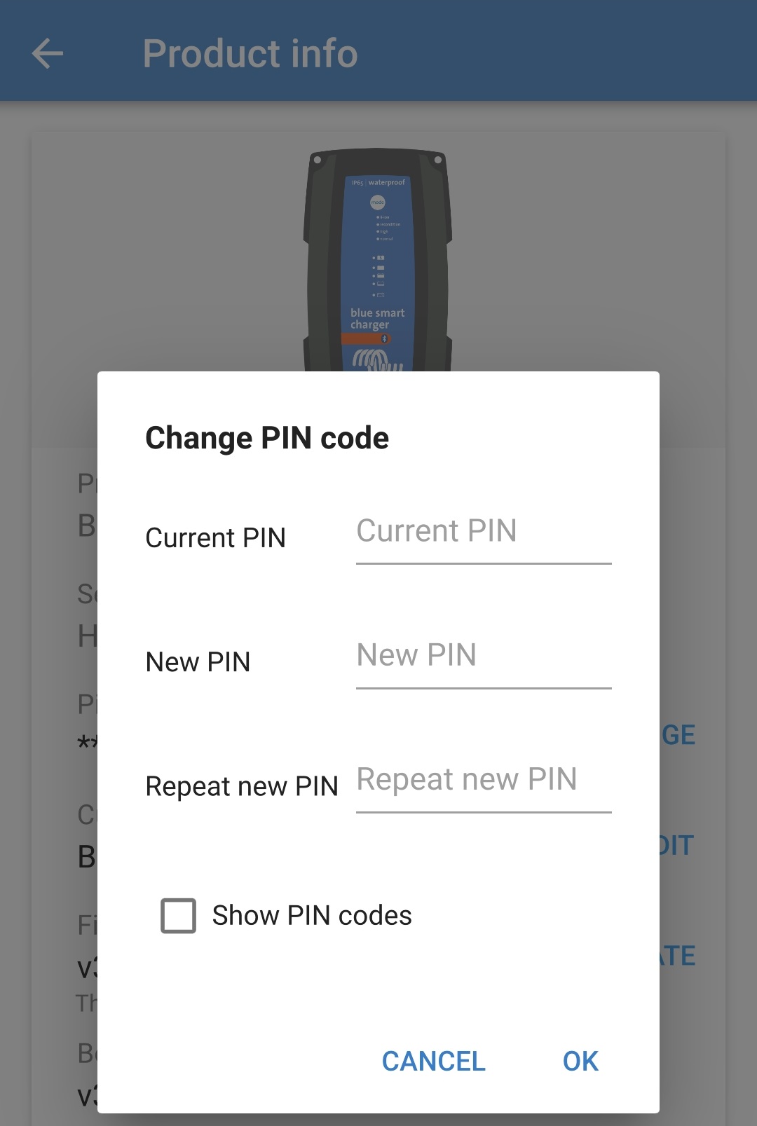

5.3. Bluetooth
5.3.1. Changing the PIN code
To prevent unauthorised Bluetooth connections, it is highly recommended to change the default PIN code to a unique PIN code that that offers a greater level of security.
The Bluetooth PIN code can be changed using a Bluetooth enabled device (mobile phone or tablet) with the VictronConnect app.
To change the Bluetooth PIN code:
- Using a Bluetooth enabled device (mobile phone or tablet), open the VictronConnect app and locate the Blue Smart IP65 Charger in the Device list Local page, then connect to the device (the default PIN code is stated on a label located on the back of the charger, or try 000000 if there is no label).

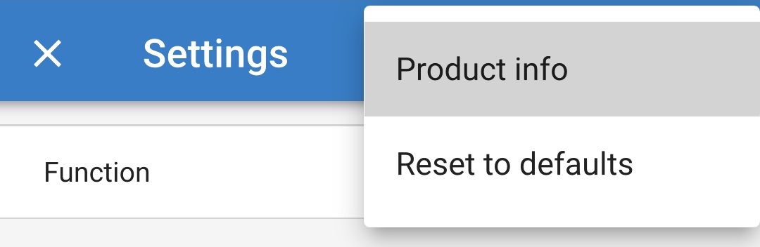

- Select the Settings icon (gear in the top right corner) to access the Settings page.
- Select the Device options icon (three vertical dots in the top right corner) to access the Device options dropdown menu.
- Select Product info from the dropdown menu to access the Product info page.
- Select CHANGE in the Pin code field to open the Change PIN code pop-up dialog box.
- Enter the current PIN code and the desired new PIN code (twice), then select OK; avoid using a simple PIN code that is easy for someone else to guess, such as 123456.
- After a short delay a pop-up dialog box will appear confirming that the Bluetooth PIN code has been successfully changed.
- The Bluetooth PIN code has now been changed to the new PIN code.

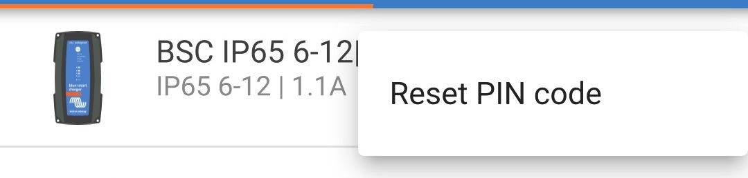

5.3.2. Resetting the PIN code
If the PIN code is forgotten/lost or does not work, it can be reset to 000000 (not the default PIN code stated on the label) using a Bluetooth enabled device (such as a mobile phone or tablet) with the VictronConnect app.
To reset the Bluetooth PIN code:
- Locate the PUK code stated on a label located on the back of the charger and record it for use later.
- Using a Bluetooth enabled device (mobile phone or tablet), open the VictronConnect app and locate the Blue Smart IP65 Charger in the Device list Local page.
- Select the Device options icon (three vertical dots on the right side of the description) to access the dropdown menu.
- Select Reset PIN code from the dropdown menu to open the Reset PIN code pop-up dialog box.
- Enter the PUK code (recorded earlier) and select OK.
- A pop-up dialog box with the text "Busy" will be displayed while the Bluetooth PIN code is being reset.
- After a short delay a pop-up dialog box will appear confirming that the Bluetooth PIN code has been successfully reset; select OK to exit into the VictronConnect Device list LOCAL page.
- The Bluetooth PIN code has now been reset to 000000.

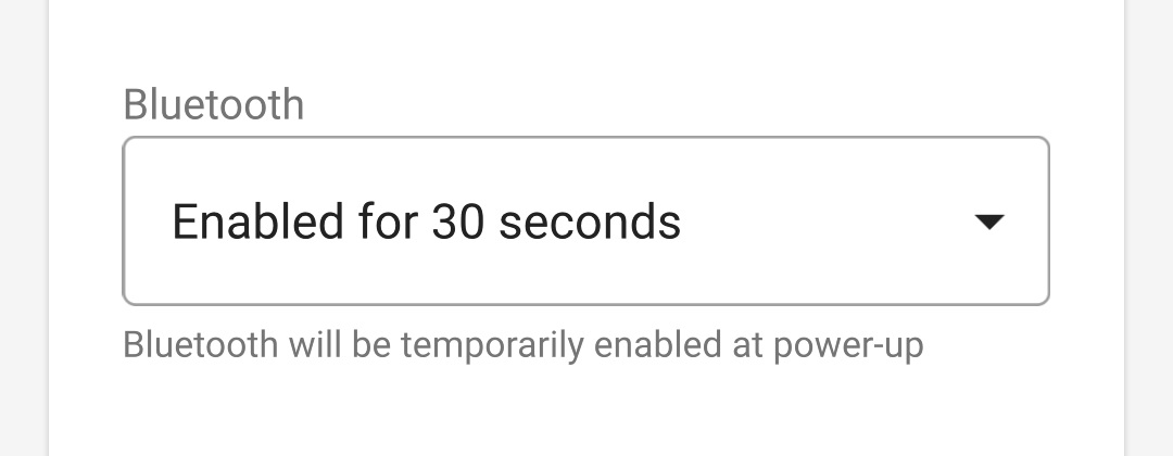

There are two options available:
This option allows a Bluetooth connection to made within the first 30 seconds after a power-up; enabling a firmware update to be completed or Bluetooth to be re-enabled. If no Bluetooth connection is made within the first 30 seconds, then Bluetooth is disabled thereafter.

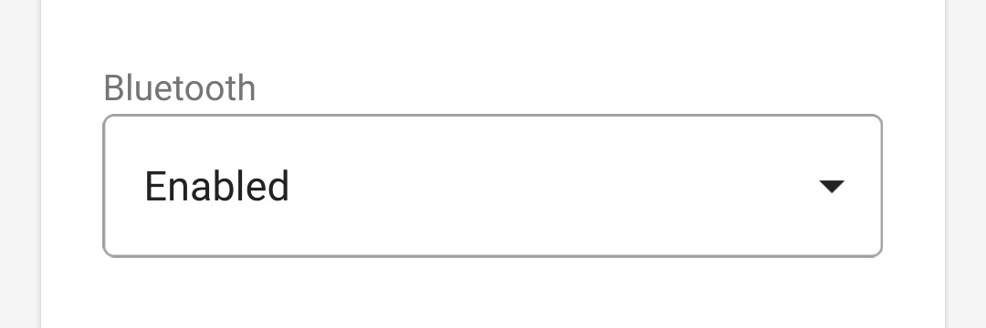

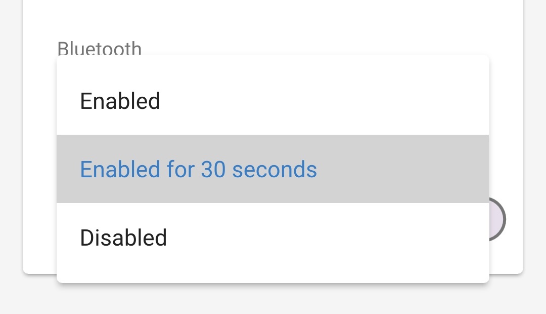

To disable Bluetooth:
- Using a Bluetooth enabled device (mobile phone or tablet), open the VictronConnect app and locate the Blue Smart IP65 Charger in the Device list Local page, then connect to the device (the default PIN code is stated on a label located on the side of the charger, or try 000000 if there is no label).
- Select the dropdown arrow in the Bluetooth field, then select Enabled for 30 seconds from the dropdown menu.
- Read the warning message, then tick the checkbox and select OK to proceed.
- End the current Bluetooth session by exiting into the VictronConnect Device list, a final pop-up dialog box will appear when attempting to exit. - Read the warning message, then select OK to accept and progress.
- Bluetooth operation has now been disabled, except for 30 second after every power-up.

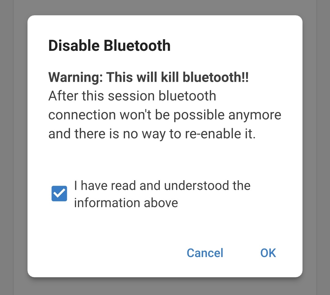

Notice

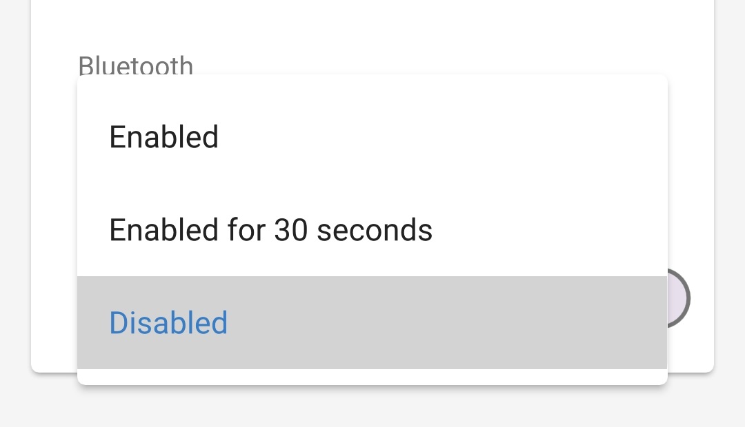

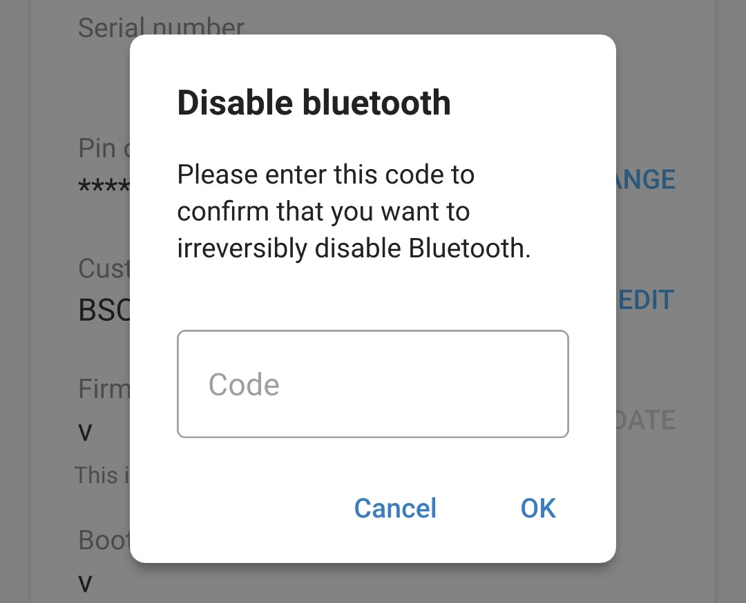

Note: This option will permanently disable Bluetooth; use with extreme caution, as this procedure is irreversible.
To disable Bluetooth permanently:
- Select the dropdown arrow in the Bluetooth field, then select Disabled from the dropdown menu.
- A four digit code is provided to avoid Bluetooth being permanently disabled accidentally, if you are sure that you want to permanently disable Bluetooth enter the code, then select OK. - This is the last chance to abort; after Bluetooth has been permanently disabled it is irreversible and cannot be re-enabled later.
- End the current Bluetooth session by exiting into the VictronConnect Device list Local page, a final pop-up dialog box will appear when attempting to exit. - Read the warning message, then select OK to proceed.
- Bluetooth operation has now been permanently disabled.

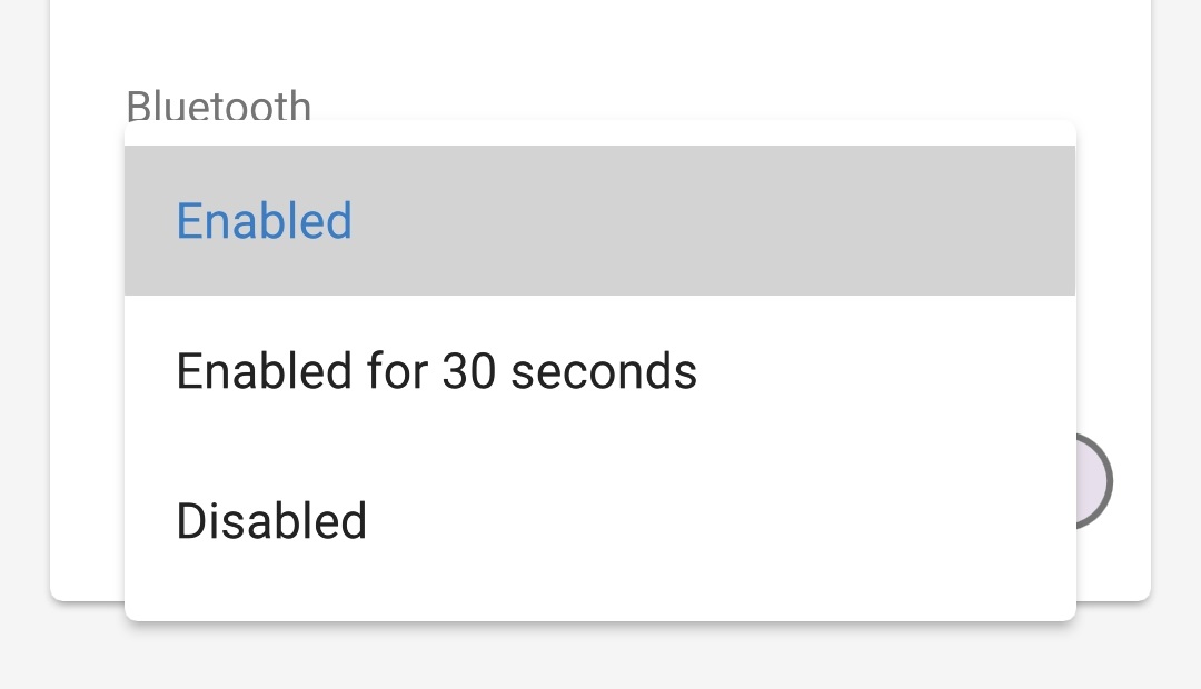

5.3.4. Re-enabling Bluetooth
Notice
During this procedure:
- Bluetooth operation is re-enabled
- The Bluetooth PIN code is reset to 000000 (not the default PIN code stated on the label)
- Bluetooth pairing information is cleared
Accordingly it is necessary to unpair all devices (mobile phones or tablets) previously paired with the Blue Smart IP65 Charger and establish a new Bluetooth pairing.
If Bluetooth was disabled using option #2 ‘Disabled’, this is irreversible and Bluetooth communication cannot be re-enabled.
If Bluetooth was disabled using option #1 ‘Enabled for 30 seconds’, Bluetooth communication can be re-enabled using a Bluetooth enabled device (mobile phone or tablet) with the VictronConnect app.
To re-enable Bluetooth:
- Using a Bluetooth enabled device (mobile phone or tablet), open the VictronConnect app and locate the Blue Smart IP65 Charger in the Device list Local page, then connect to the device within the first 30 seconds after power-up while Bluetooth is temporarily enabled (the default PIN code is stated on a label located on the side of the charger, or try 000000 if there is no label).
- Select the dropdown arrow in the Bluetooth field, then select Enabled from the dropdown menu.
- Bluetooth operation has now been re-enabled.

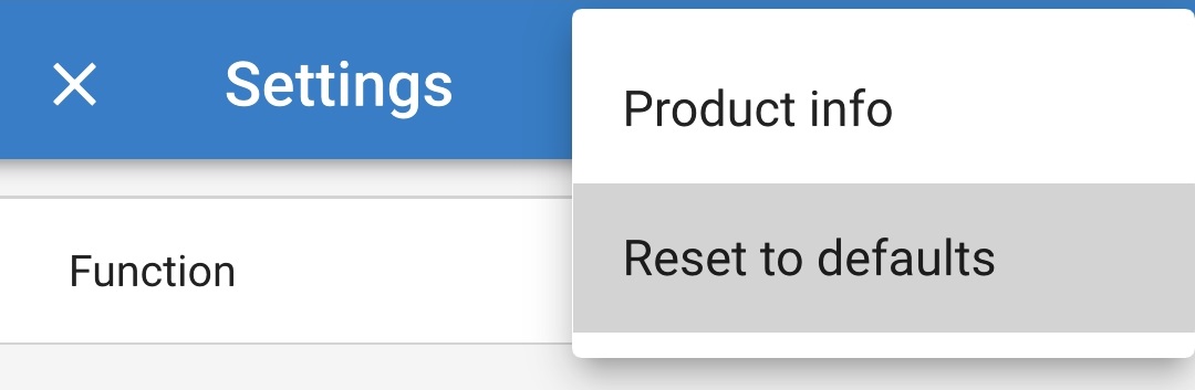

5.4. Reset to defaults
If required, all Blue Smart IP65 Charger settings can be reset/restored to factory defaults using a Bluetooth enabled device (mobile phone or tablet) with the VictronConnect app.
Note this operation does not reset any Bluetooth related settings, such as the Bluetooth PIN code or pairing information.
To reset all settings to factory defaults:
- Select Reset to defaults from the dropdown menu to open the Restore device pop-up dialog box.
- Read the warning message, then select Yes to proceed.
- All settings have now been reset/restored to factory defaults.
