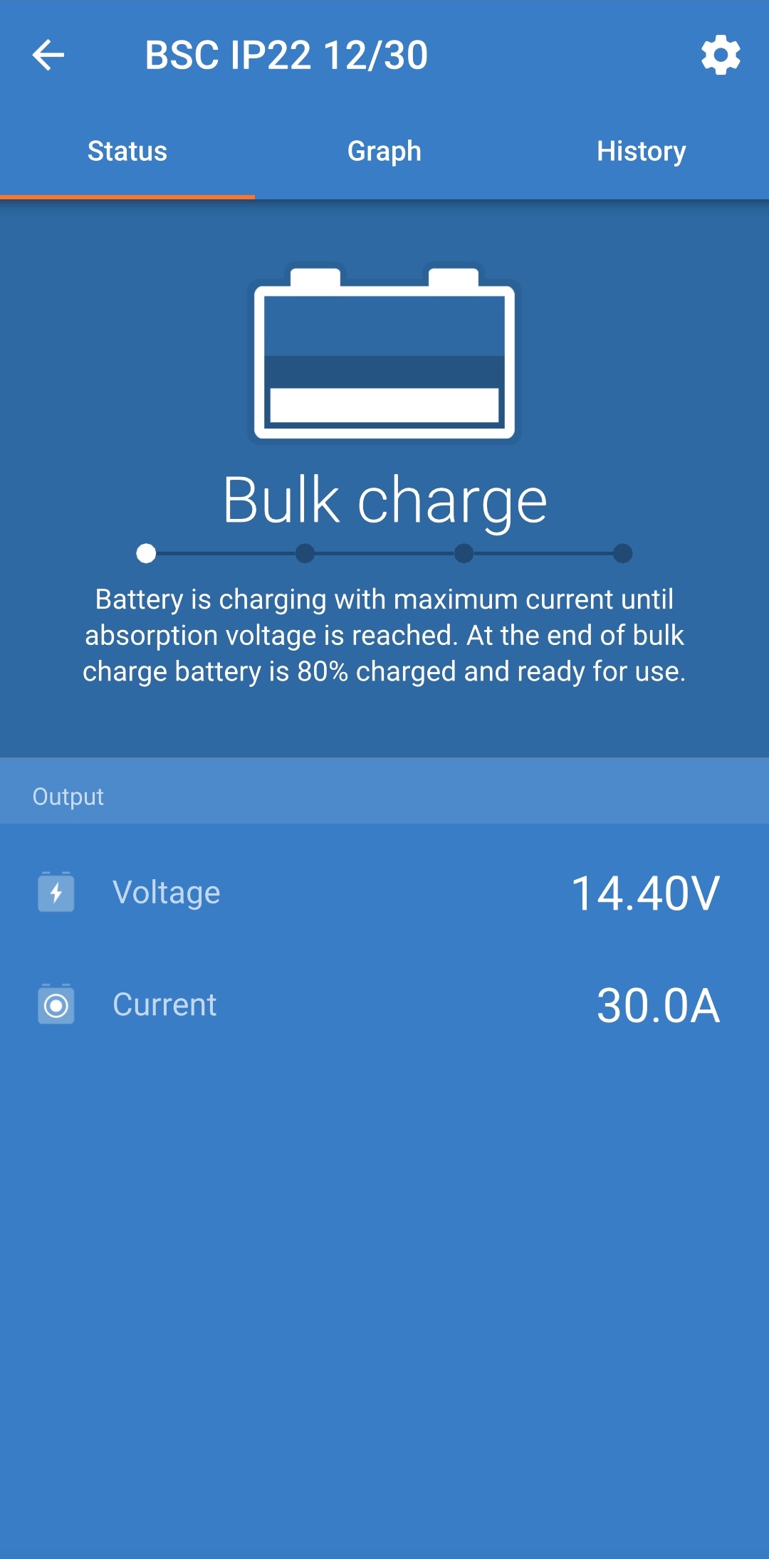

7.2.1. Status screen
The Status screen is the main overview screen; it displays the function mode (charger or power supply), the active charge state (in charger mode), the battery voltage and the charge/output current.
This data will update continuously in real time as the charge cycle progresses.

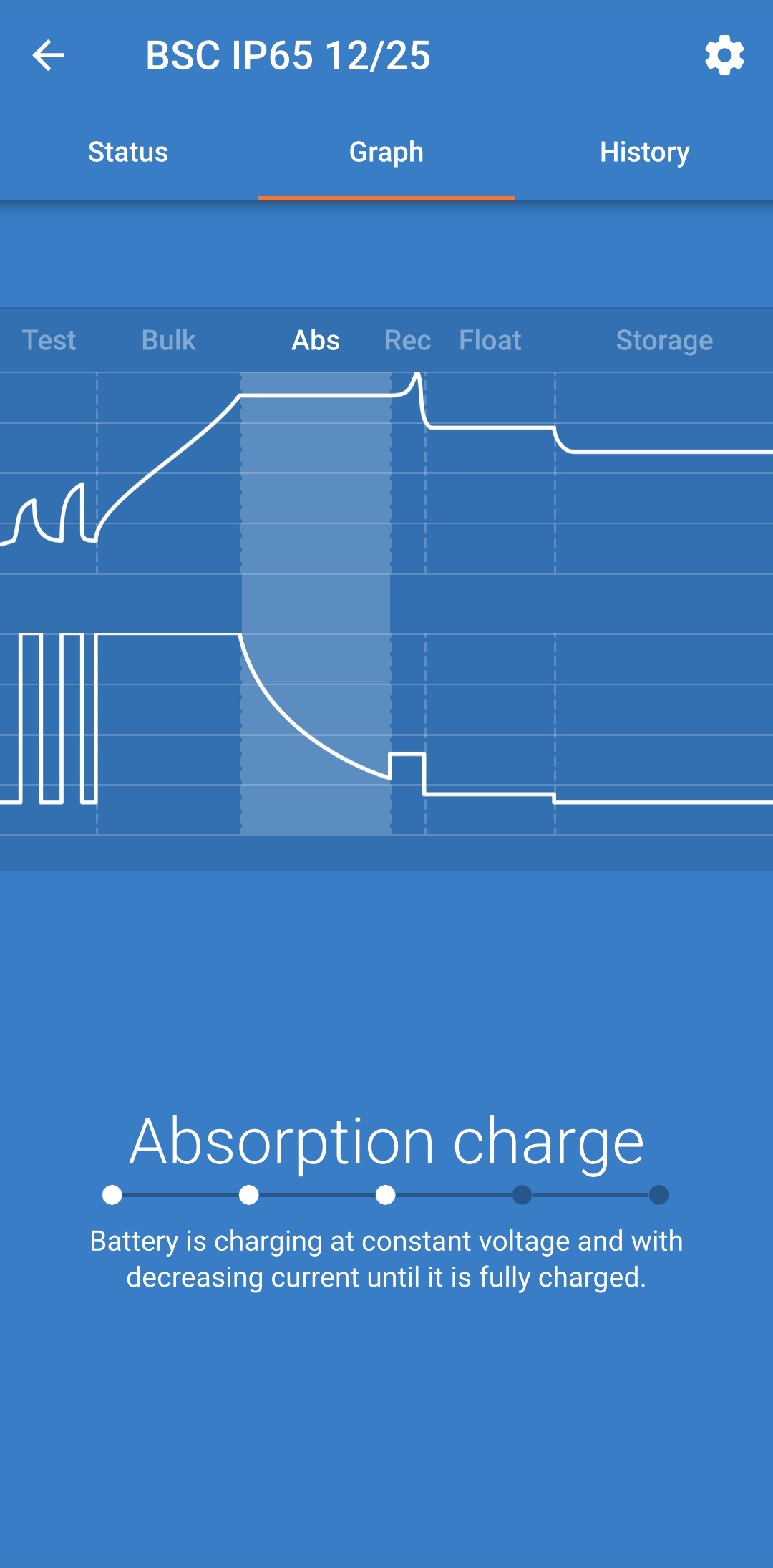

7.2.2. Graph screen
The Graph screen provides an easy to understand graphical representation of each charge state with respect to typical battery voltage and charge current.
The active charge stage is also highlighted and stated, along with a brief explanation.
