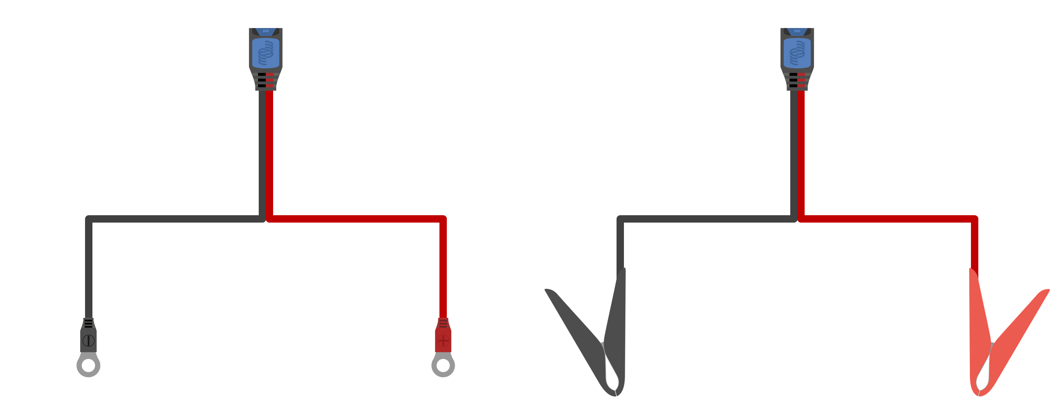

    1. Select the interchangeable DC power cable battery connection type required for the installation; M8 ring terminals and battery clamps are supplied with the charger.

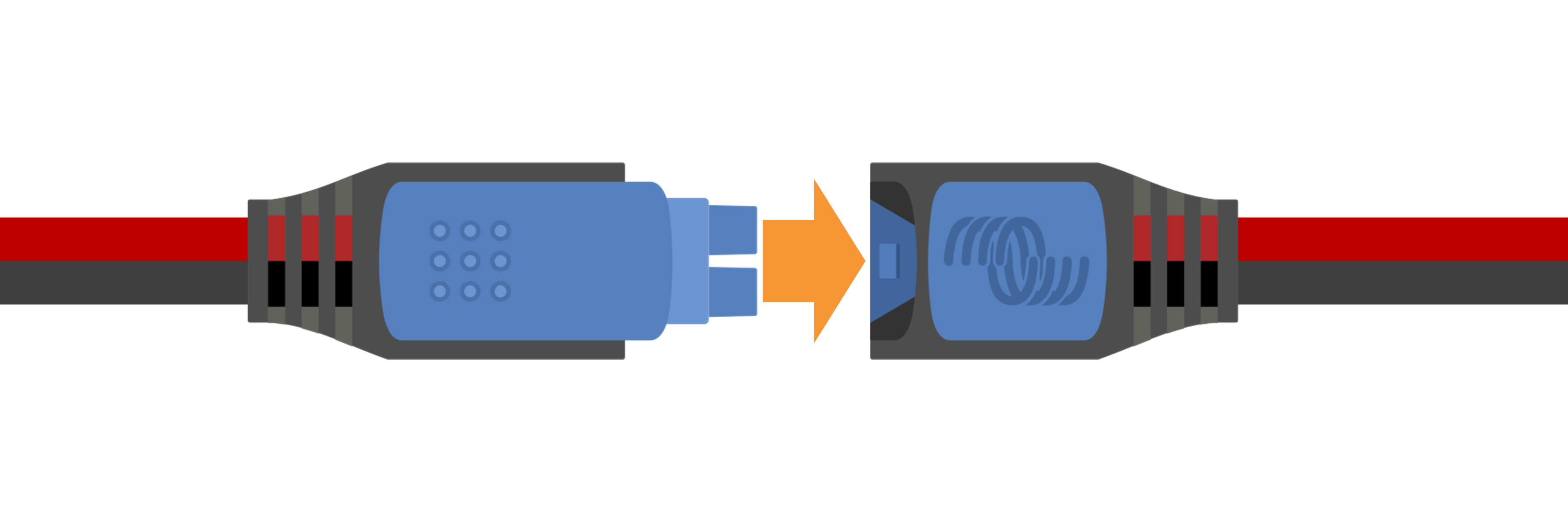

    2. Connect the required DC power cable battery connection type to the DC power cabling hardwired to the charger; push the mating quick connectors together until the blue latch is fully engaged.

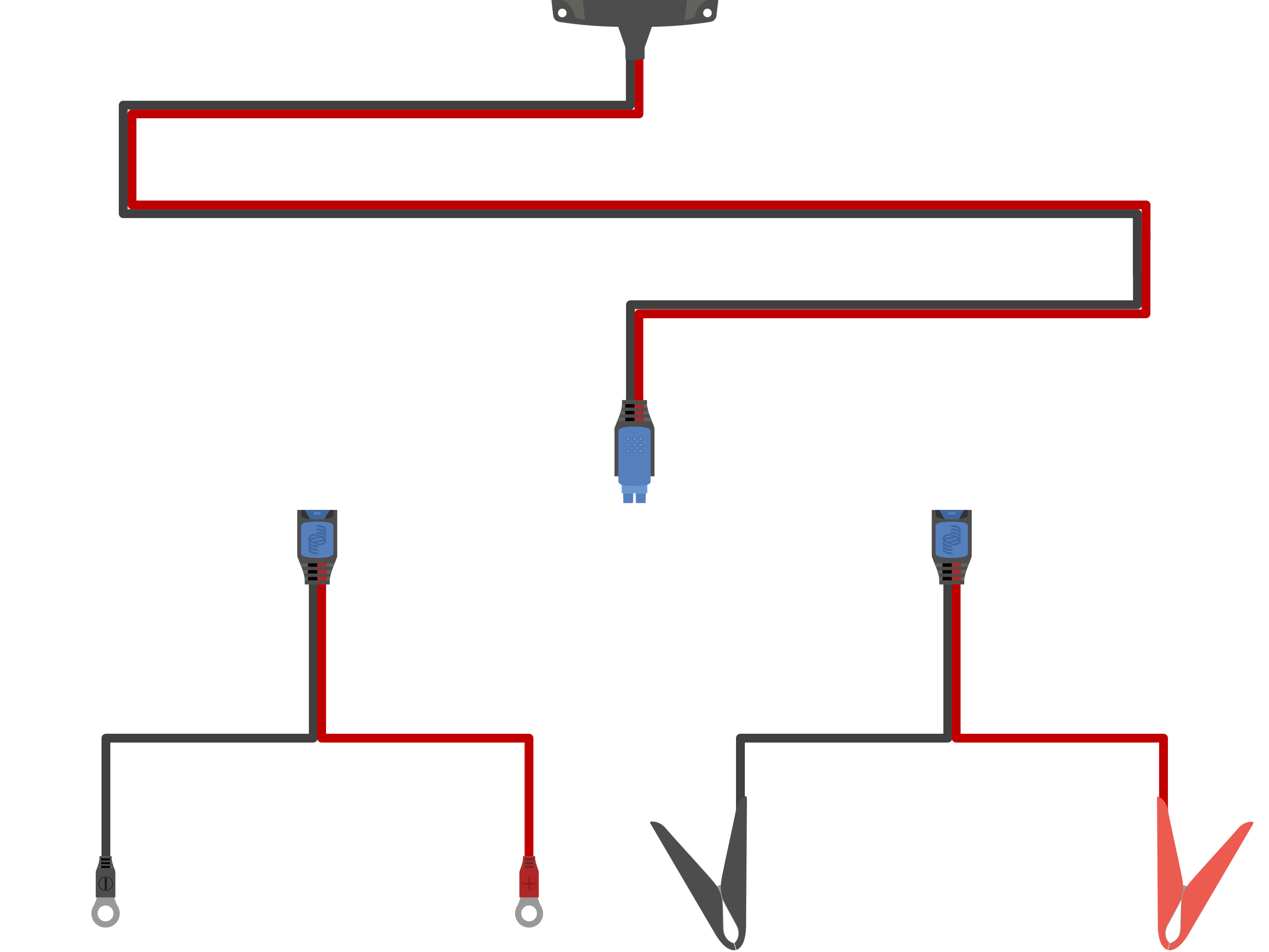

The Blue Smart IP65 Charger range includes suitable DC power cabling hardwired to the charger with interchangeable battery / DC system connection options; M8 ring terminals and battery clamps are supplied with the charger.
The following interchangeable DC power cable battery connection types are also available as an optional accessory:

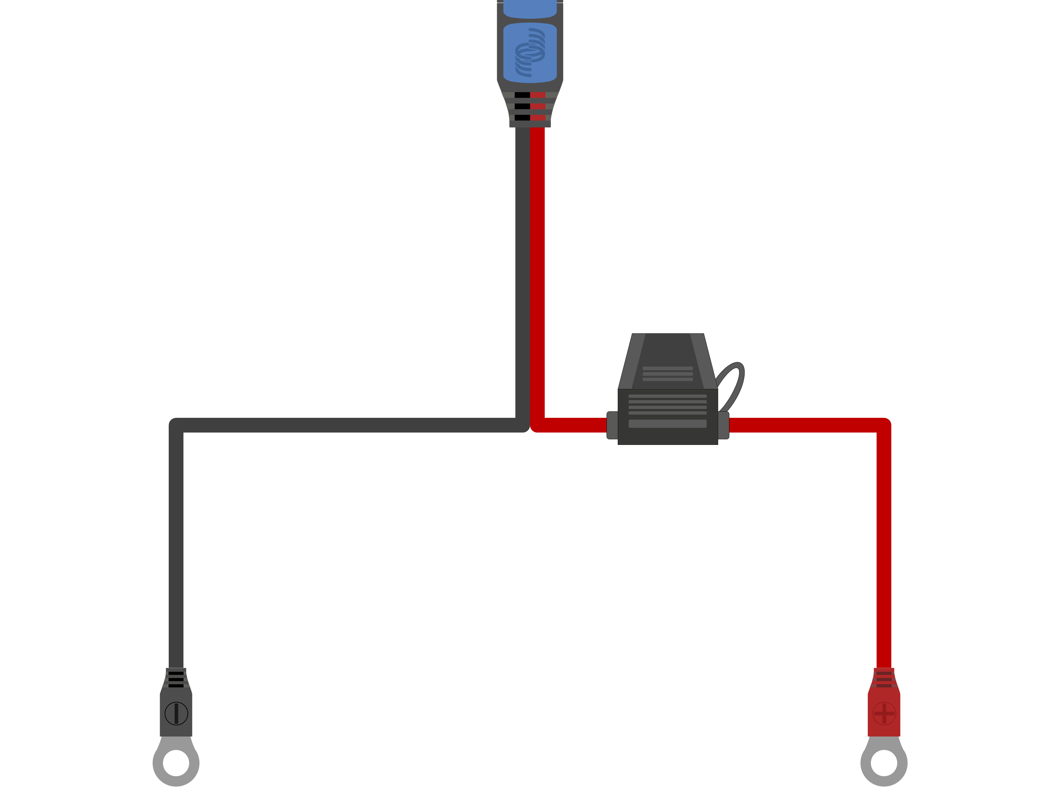

  1. M6 ring terminals with inline ATO fuse (30A fuse included) - PN: BPC900100014
  2. M8 ring terminals with inline ATO fuse (30A fuse included) - PN: BPC900110014

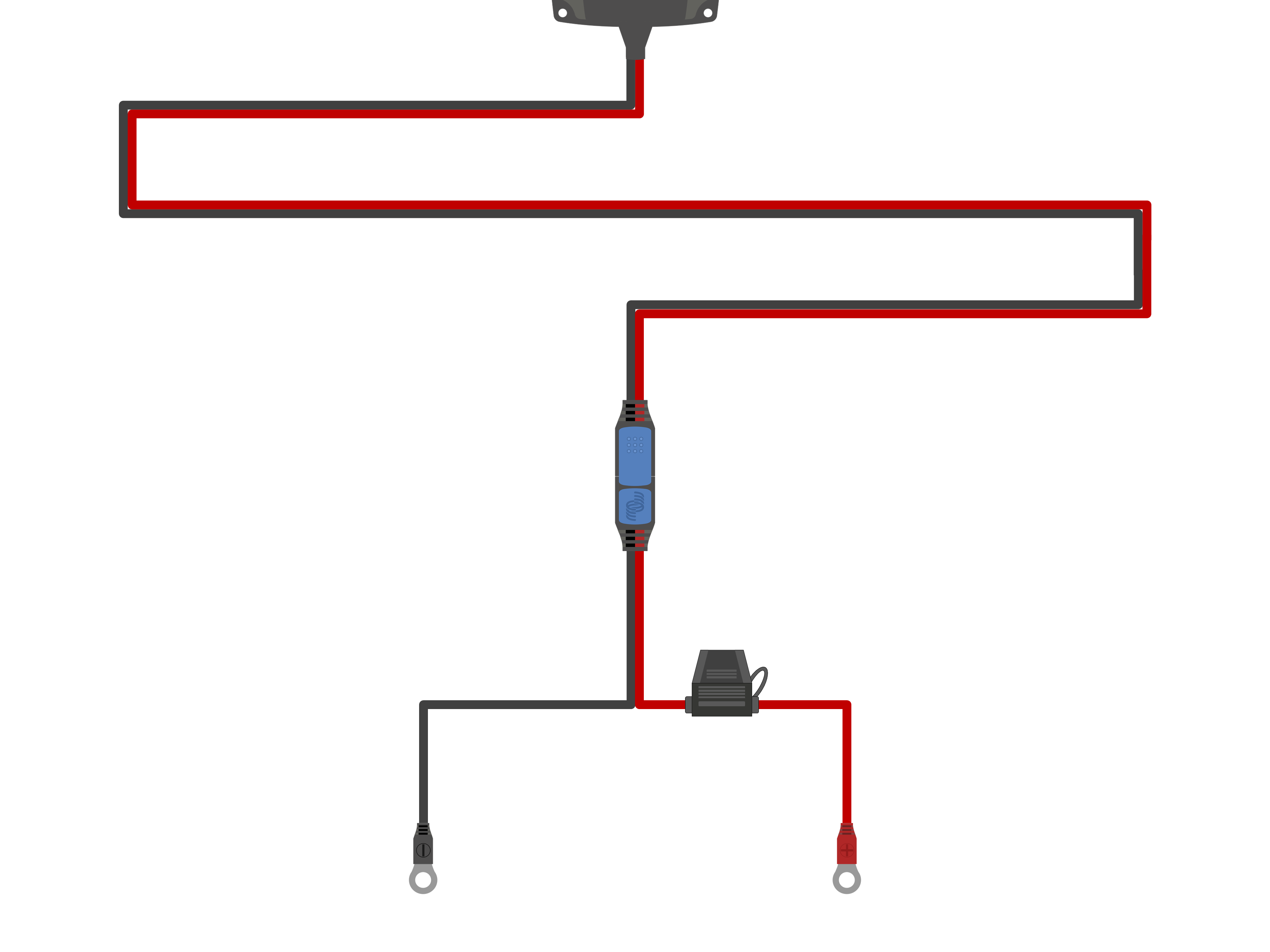

  3. 12V battery indicator quick connector with M8 ring terminals and inline ATO fuse (30A ATO fuse included, for use with lead-acid batteries only) - PN: BPC900120114
  4. 12V battery indicator panel with M8 ring terminals and inline ATO fuse (30A ATO fuse included, for use with lead-acid batteries only) - PN: BPC900110114
  5. Spring clamps with inline ATO fuse (30A ATO fuse included) - PN: BPC900400014

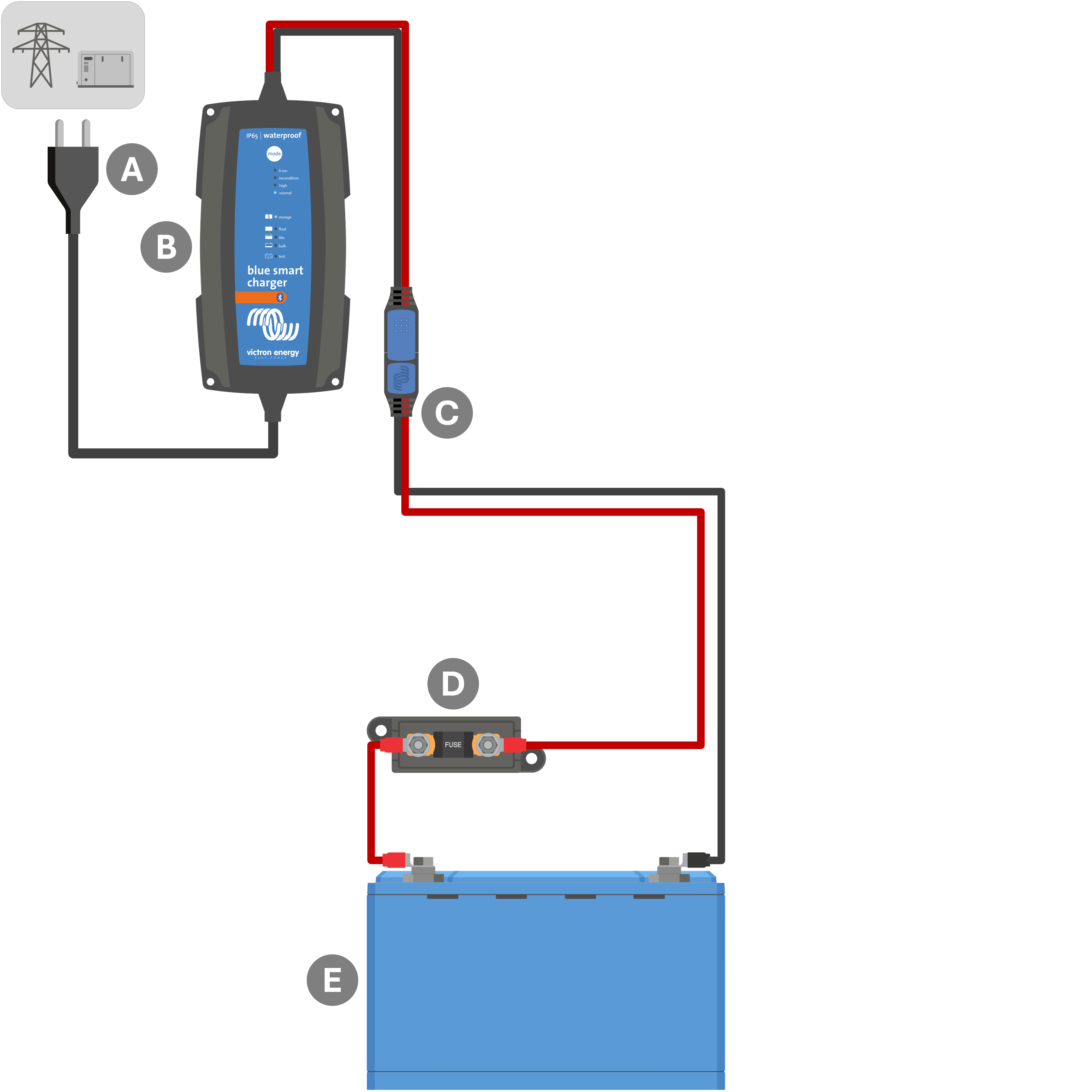

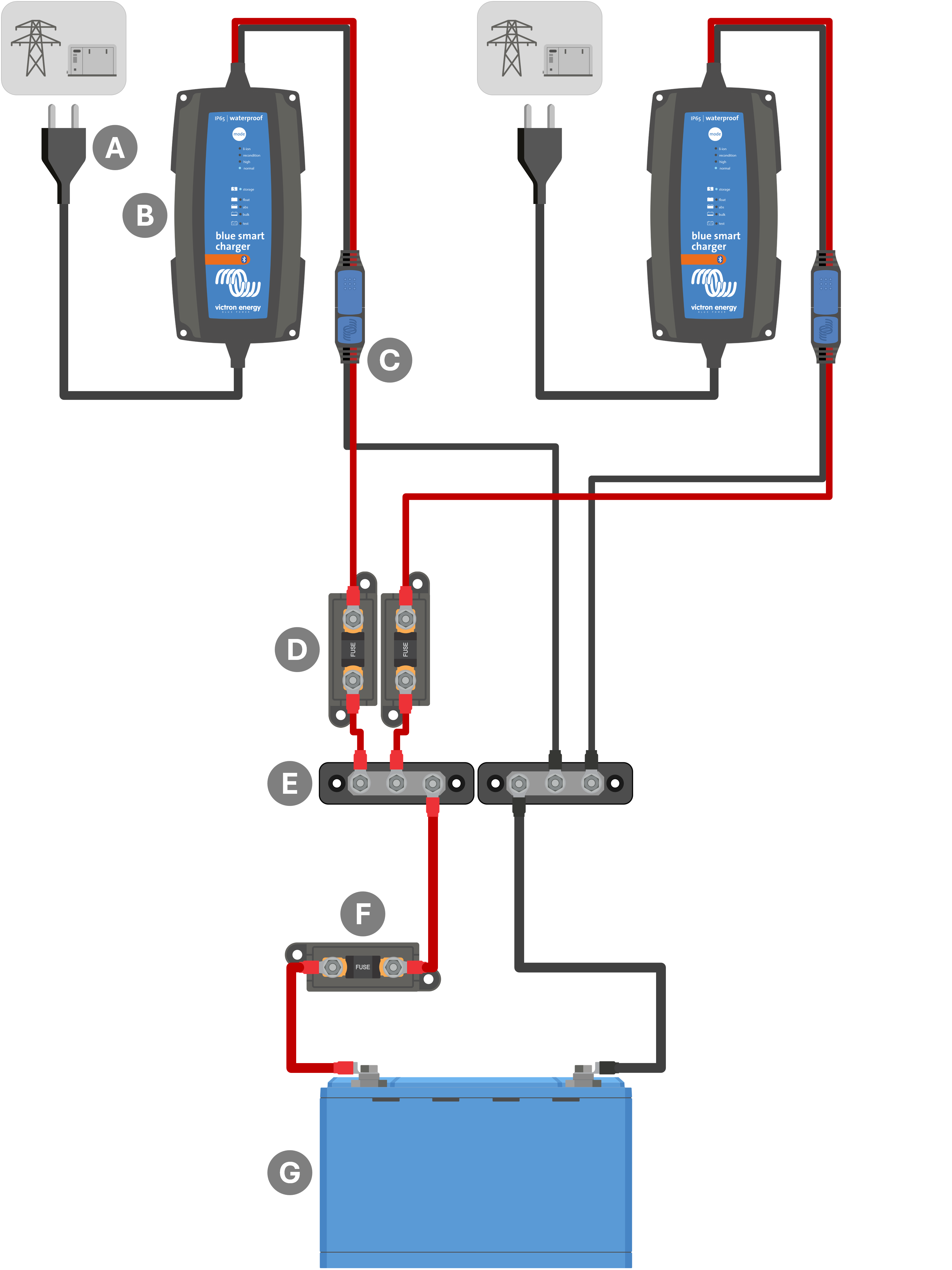

5.3. Schematics
5.3.1. Basic install
5.3.2. System with multiple chargers
