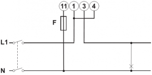

A Hub-4 setup requires an AC sensor connected in the main distribution panel: between the grid and installation. This AC sensor has been designed for 3 phase measurement, but can be configured for single phase support as well.
3-phase setup diagram:
single phase setup diagram:
Note the jumper between terminals 1 and 4.
