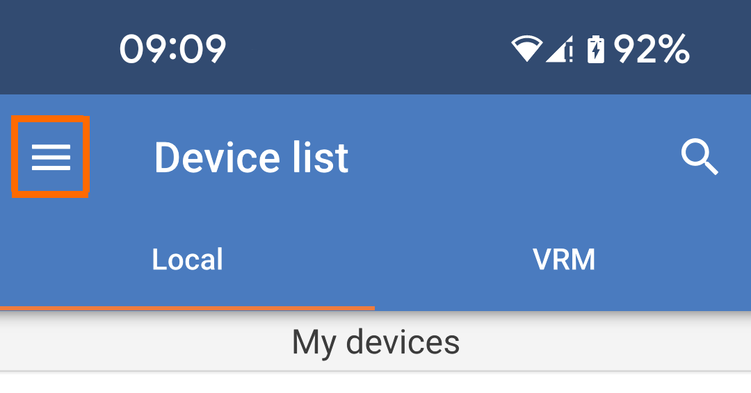

[en] Tap the "hamburger" menu icon at the top left of the page. |

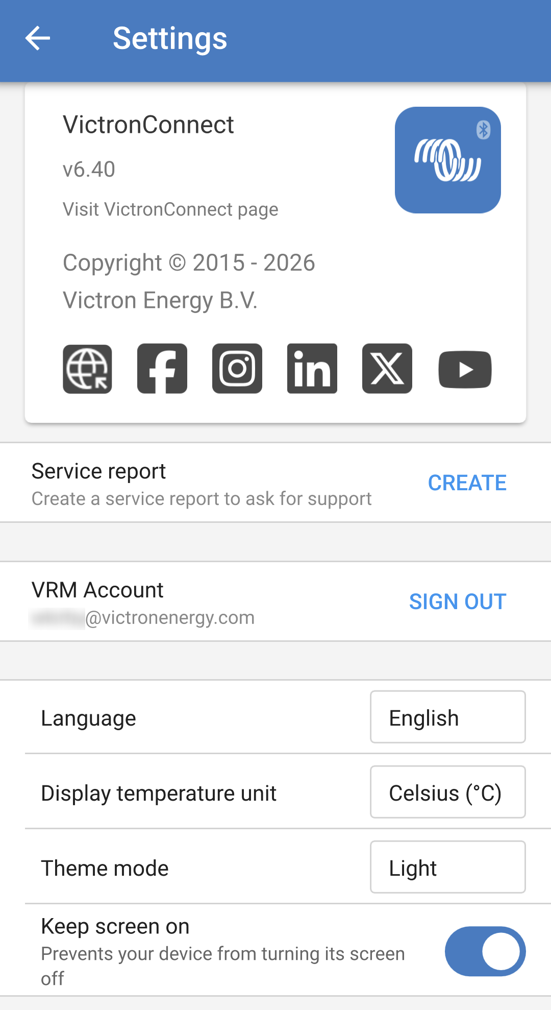

[en] Select "Settings" from the drop-down menu. |
[en] The VictronConnect application settings page the version number at the top. There is a link to The VictronConnect page on our website and links to various social media channels.
