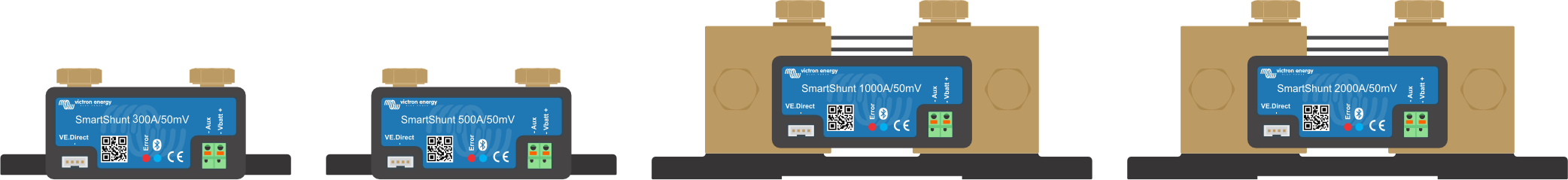

The SmartShunt is available in 4 sizes being: 300A, 500A, 1000A and 2000A.
From left to right: SmartShunt 300A, 500A, 1000A and 2000A.
