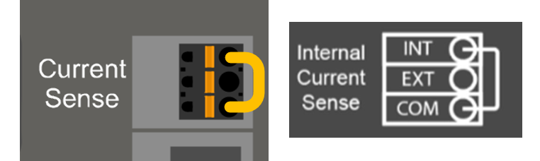

| For MultiPlus-II units only: Check if the current sensor connector with the wire link is placed; if not, place the connector with the link.  Note: Refer to the product manual to find the location of the current sensor connector. The link should connect the "INT" to the "COM" terminal. Note: Older units do not have a current sensor connector with a wire link but have a headphone jack connector instead. For those models, this step does not apply. |
