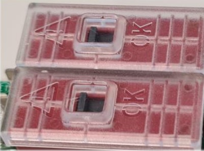

7.1.3. Safety relays are closed.
Safety relays, which are visible in the wiring compartment at the PV inputs, may have closed. This only happens if the Multi RS Solar has protected its self from a hazardous situation.
Under normal operating conditions the small black flag on top of the relay should be in the "OK" position. If the flag indicates towards the position with a danger symbol then it is closed. When the relays are closed the PV array is short circuited to stop PV power from entering the Multi RS Solar. The PV fuses or circuit breakers in the installation may open.
The fault cannot be cleared nor reset. The relays have closed to prevent further damage due to the internal fault.
The Multi RS Solar should be returned to the supplier.
Warning
DO NOT ATTEMPT TO RESET THE SAFETY RELAYS. THE RELAYS HAVE CLOSED TO PROTECT FROM A HAZARDOUS SITUATION.
